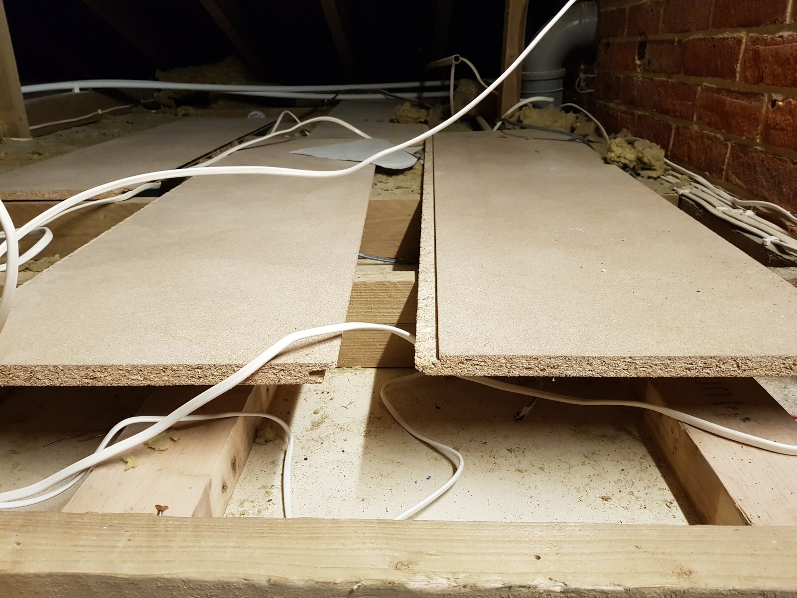

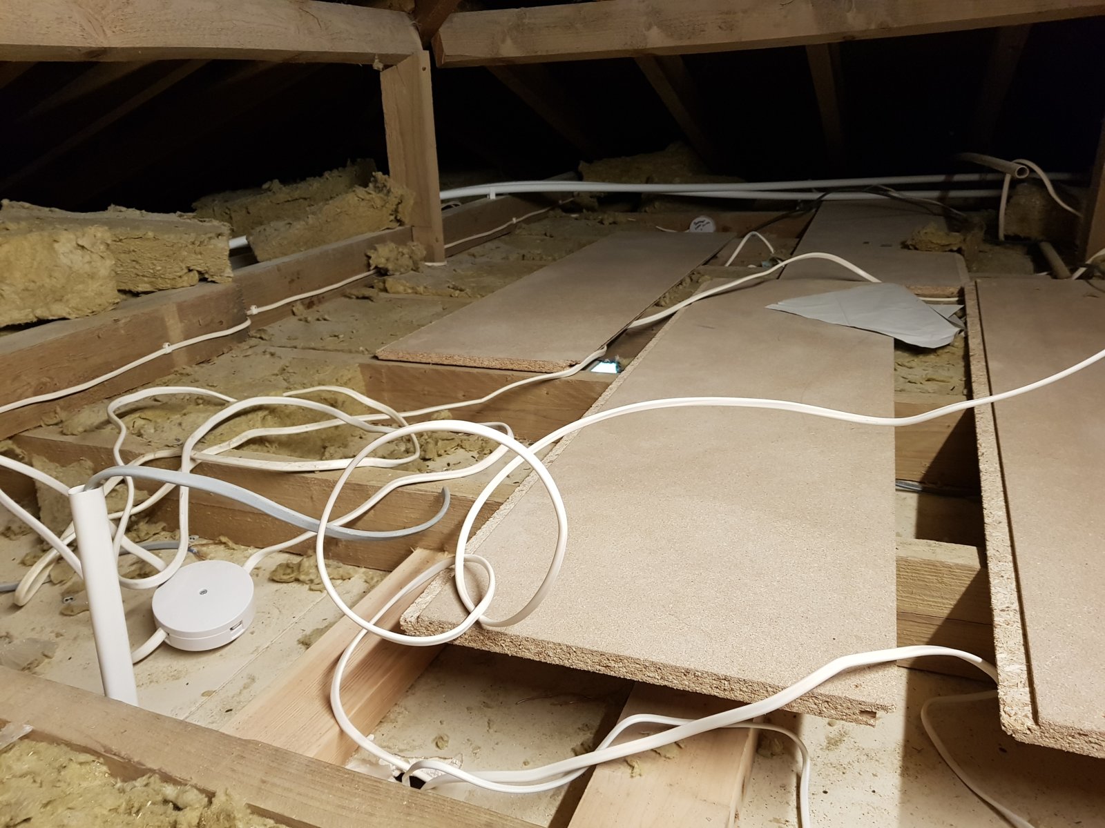

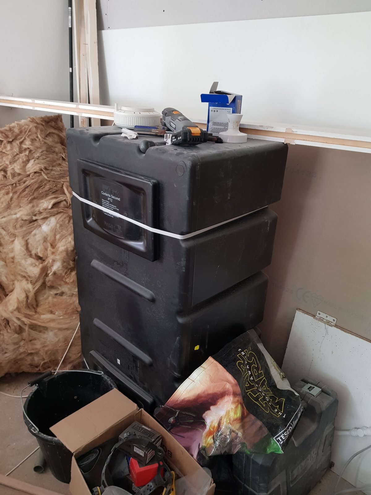

Hi,
We Have 2 lofts in our house, 1 is upstairs above the upstairs bathroom and the other is above our downstairs bathroom. In the downstairs bathroom I am installing a new mira pumped digital shower and would like to install a coffin-type water storage tank (already purchased) My question is would I need to do anything to support/strengthen the joists to support a 50 gallon tank? 3 joists will be underneath the tank and it will also be boarded before installation. Any advice/pointers would be very much appreciated!
Many Thanks
I have an older property with 6 x 2" joists in the loft which, with a little reinforcement, support a 20 gallon tank in the eaves.
Your house looks relatively modern, and I doubt the joists are designed or capable of taking anything like the load you propose. Only structural calculation could confirm this - or perhaps the eye of an experienced builder.
One option might be to install a new joist or joists between, and deeper than, the existing ones in each case resting on supporting walls.
Again this would require a SE or builders input.
Cheers,
Blup
Many Thanks for your reply Blup! even though I was hoping for a "no problem" kind of response! :p
What is an SE?
No worries.
SE = structural engineer, I had written that in an early draft but must have edited it out.
Blup
