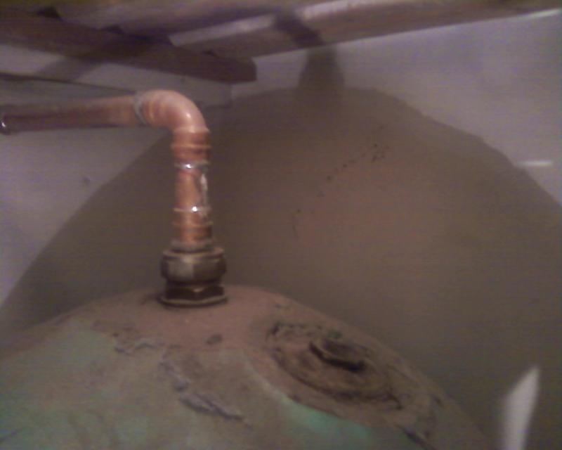

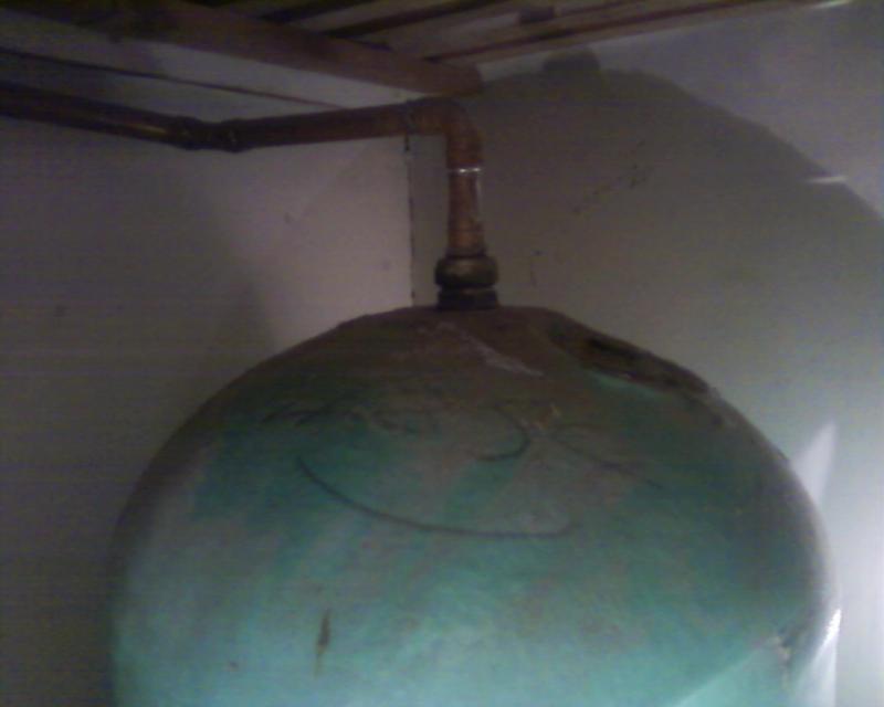

At the top of the HWC there is an unused tapping (which I assume would be used for an immersion heater) Instead of drilling a new 38mm hole for the essex flange can I use that instead.
I have this 22mm Non Stop Essex Flange from Toolstation, is it likely to fit?

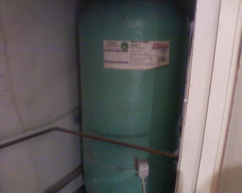

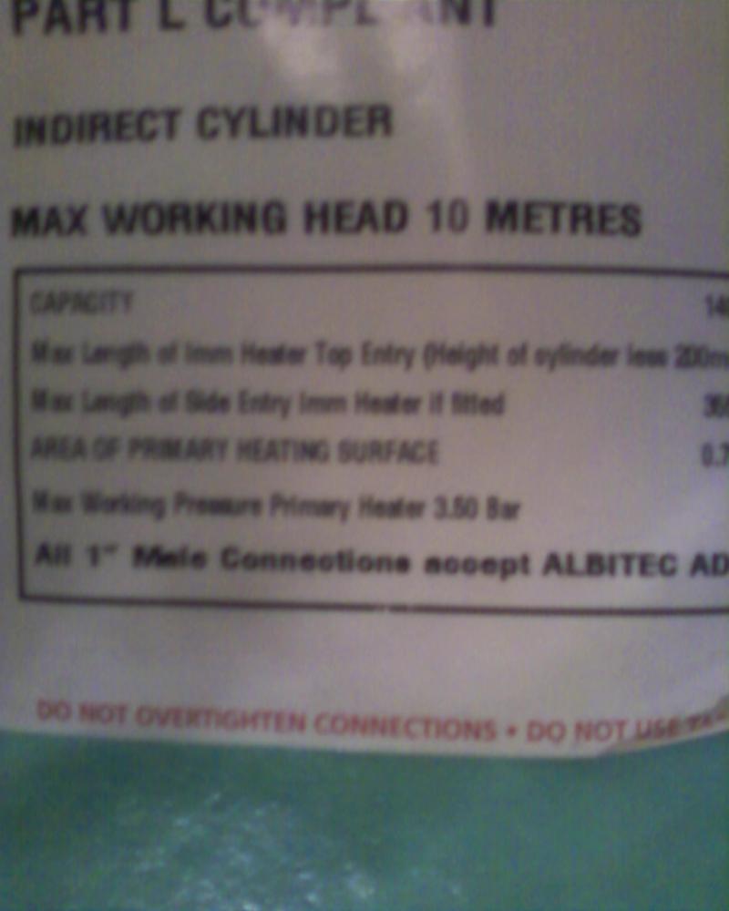

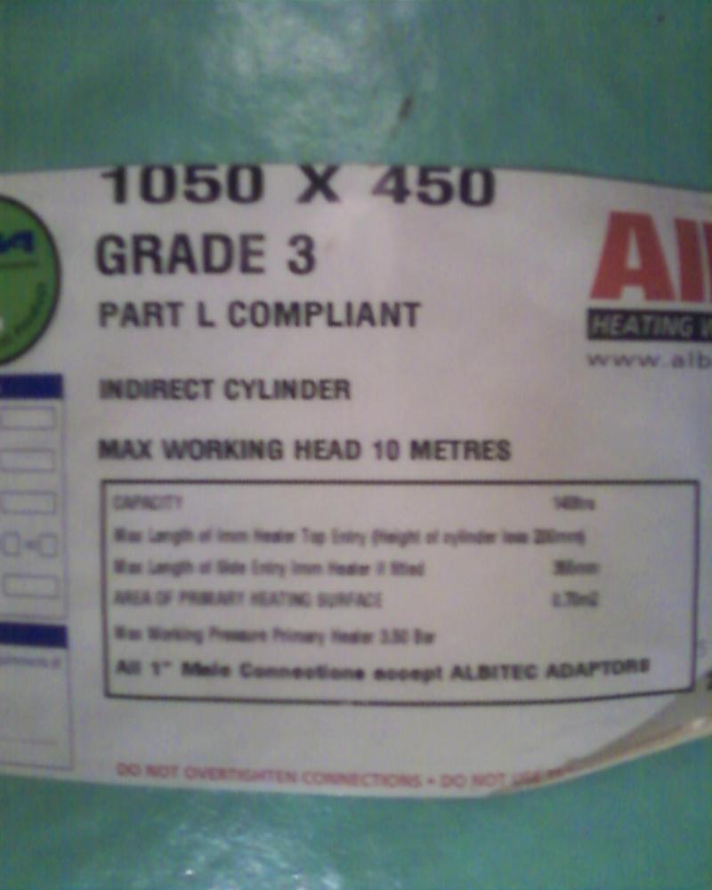

For reference I have an Albion 1050 x 450 Grade 3 indirect copper cylinder here are some pictures below:
This is the tapping here.
