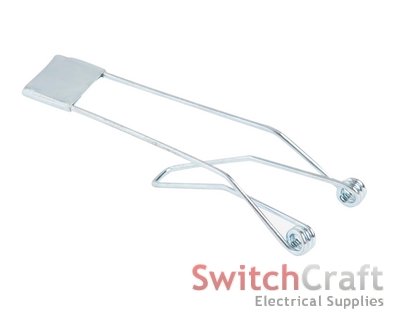

If I understand correctly -
When you push the light into the hole the little tabs fold down, parallel to the can, thus pulling the long bit down tight against the plasterboard.
Yep I see that. These lights don't have that they have a spring arm each side plus half way between each arm a little tab that sticks out see the pic on the link I posted. The tab is close enough to the face of the bezel that it will be against the cut edge of the plaster board. On the pic on the link it's the silver bit near the bezel that protrudes from the can. There is one on each side.
I'm not sure!! The directions don't point them out and the 75mm cut out dimension does not Llow for them!!
No. Have a look at my link it's the little tabs that are on the top face of the can near the bezel. It has the spring arms in place of those bits in your link.
They are riveted on so removal is possible if drilled out but not sure if that will affect operation, obviously it will invalidate any warranty
Yep cool thanks for that I was trying to work out how to post an edited pic!!
