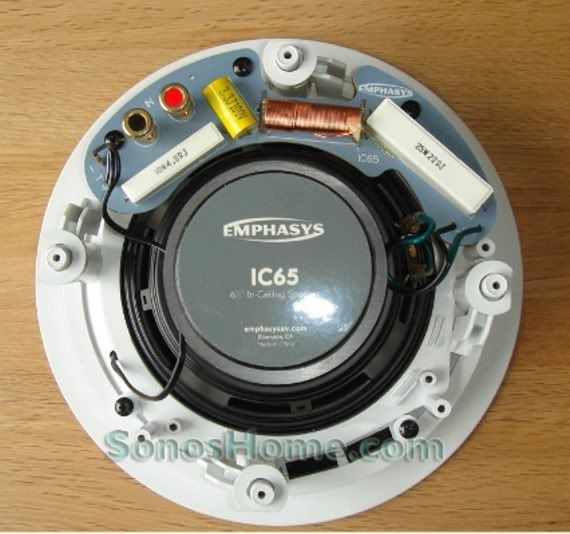

Here's the back of the Adastra 8" speaker...
and here's a competing brand 6.5" for around £95
All those bits of circuitry on the back are the crossover and overload protection. This is the same sort of stuff as you would get in a hi-fi speaker.

Im looking at putting a single stereo ceiling speaker into my bathroom (2.5x3m), like the one below. Is it safe to place it under loft insulation or is this a fire risk/ will affect the sound? Is cutting a hole in the insulation sufficient?

Ceiling speakers will be okay under insulation but I would never do an install and leave them like that. Theres two reasons. The first is dirt getting in to the back of the speaker. It will rattle sooner or later. est to cover it before that has chance to happen. The second reason is fire prevention. The speaker is very inlikely to spontaneously combust, but if a fire starts in the bathroom or adjoining bedroom the the flames will find the weak spot in your ceiling to spread to the rest of the house. A firehood restores some or all of the fire retarding capacity of the ceiling after you cut a big hole in it to fit a plastic speaker enclosure.
