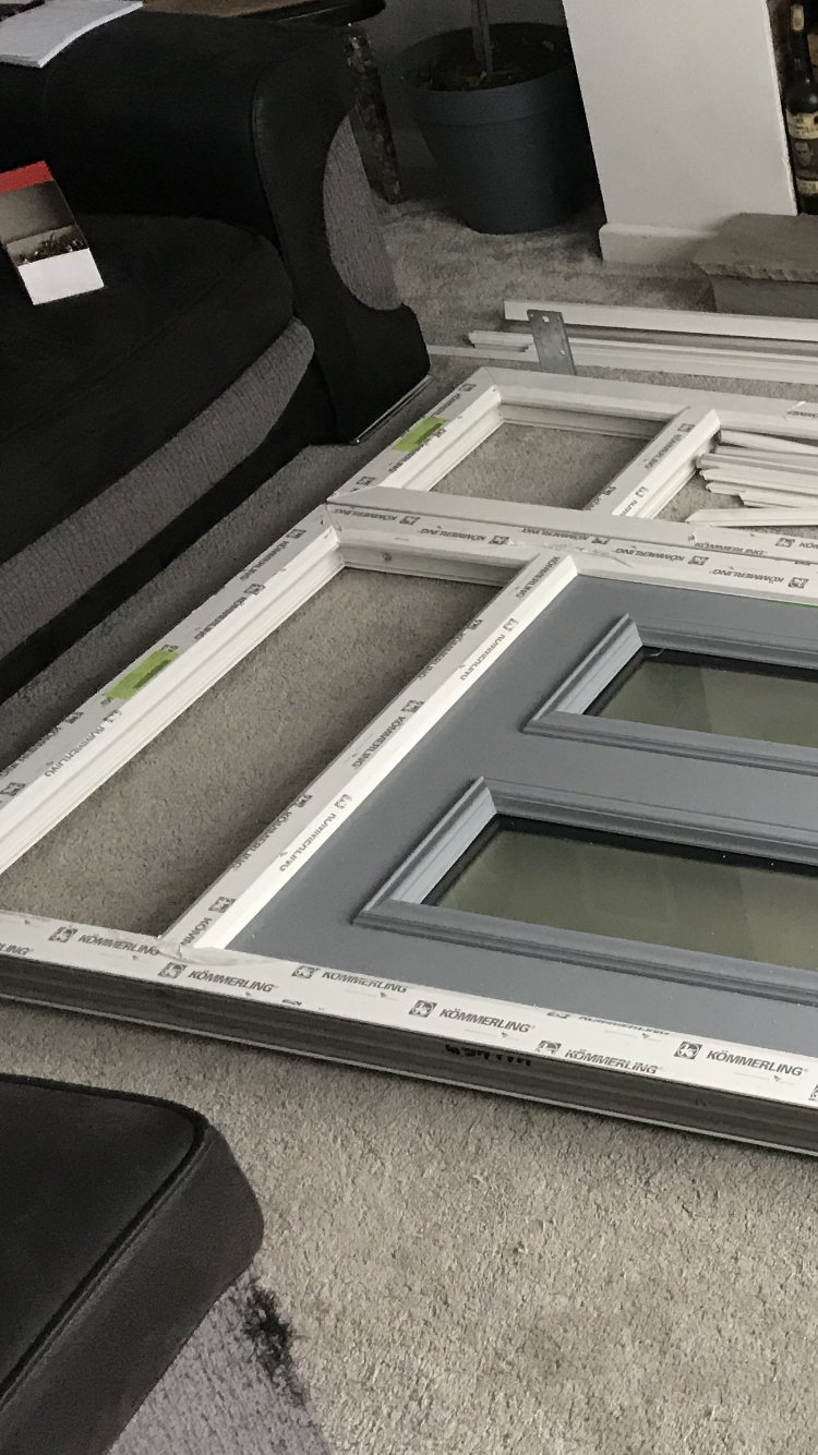

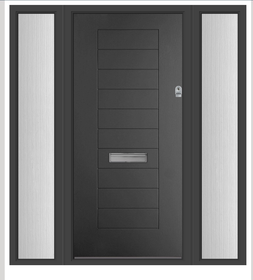

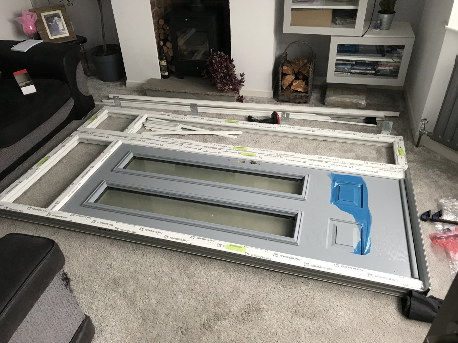

I have a composite door with full height sidelights each side like this:
Any top tips for installation?
It comes with an aluminium coupler for each sidelight.
I’m thinking sill first then I install the sidelights like any window (remove glass and fix with frame fixings into the med dense concrete blocks).

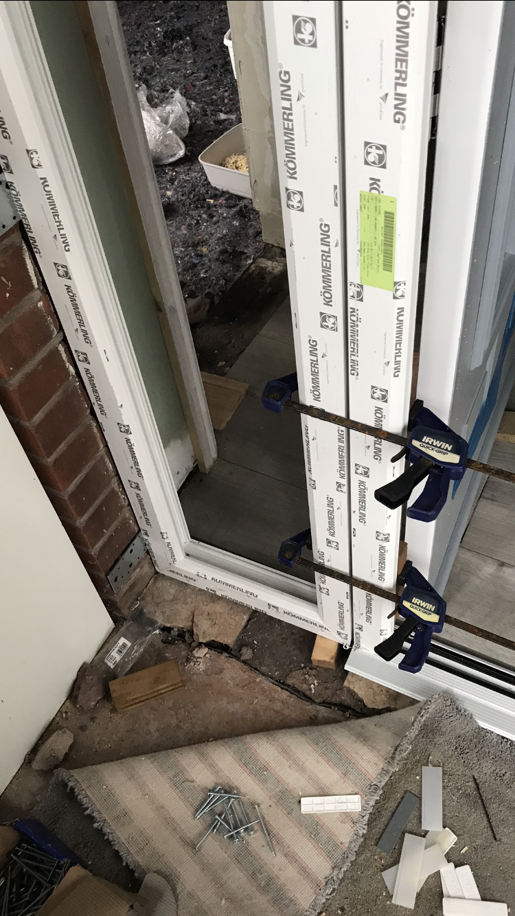

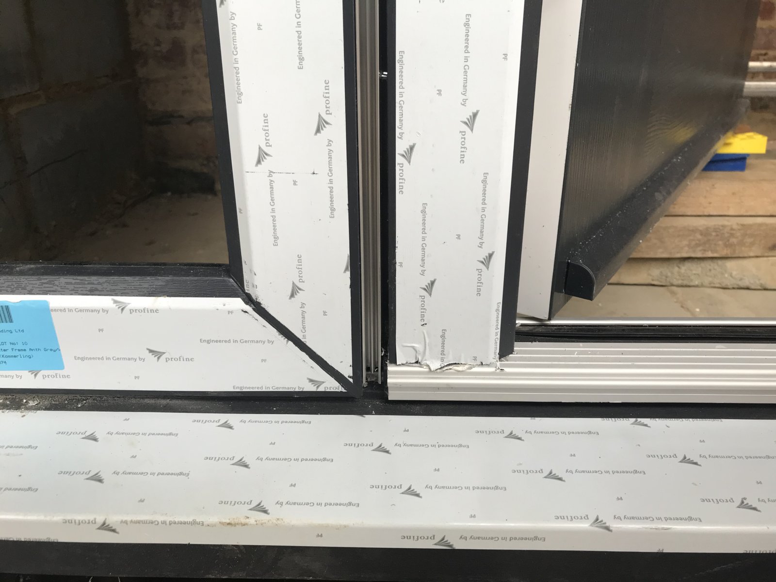

I have done it.
You want to get some ‘Baypole’ screws to fix the Ali couplers to the window and frame, they need to be drilled through the frame first and into the coupler.
Get yourself a pair (or 2) of the Irwin clamps to hold them tight while you fix them.
I bolted one sidelight to the door, and the other sidelight to the coupler then sat those 2 on the sill (which needs to be perfectly level).

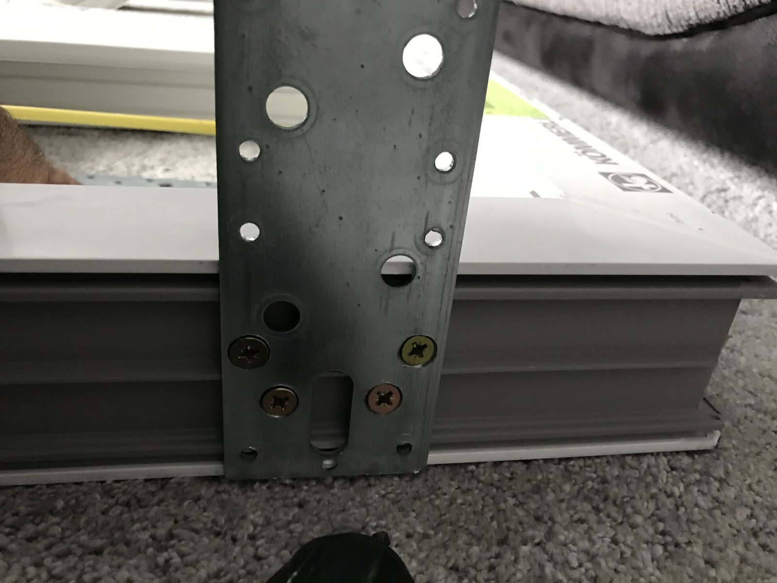

also some big metal brackets for the sides:

Did you screw the ali coupler into the sidelight (screw heads on ali side). Then screw the door frame into the ali coupler (screw heads on the door frame).

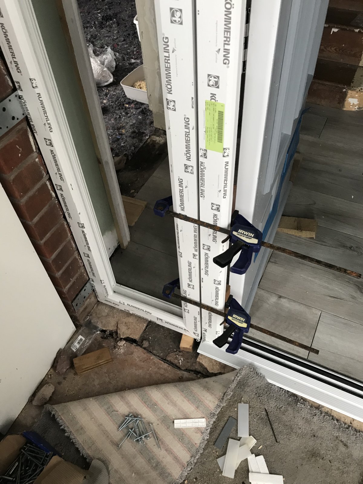

I screwed the window frame to the coupler from the frame side, then the door frame to the coupler from the door side. Like this:
The screws pull the coupler tight to the frame.
I would have then screwed the other frame and coupler to the door but there wasn’t enough room in my living room so I did the last connection in their final positions, I fixed the coupler to the second window frame first, then clamped it and screwed the door frame to the coupler. Like this:
I see! Thanks for taking the time to explain. Nice job!

The brackets were from Toolstation:
https://www.toolstation.com/flat-connector-plate/p98772
I couldn’t find the proper ones but they are very strong.

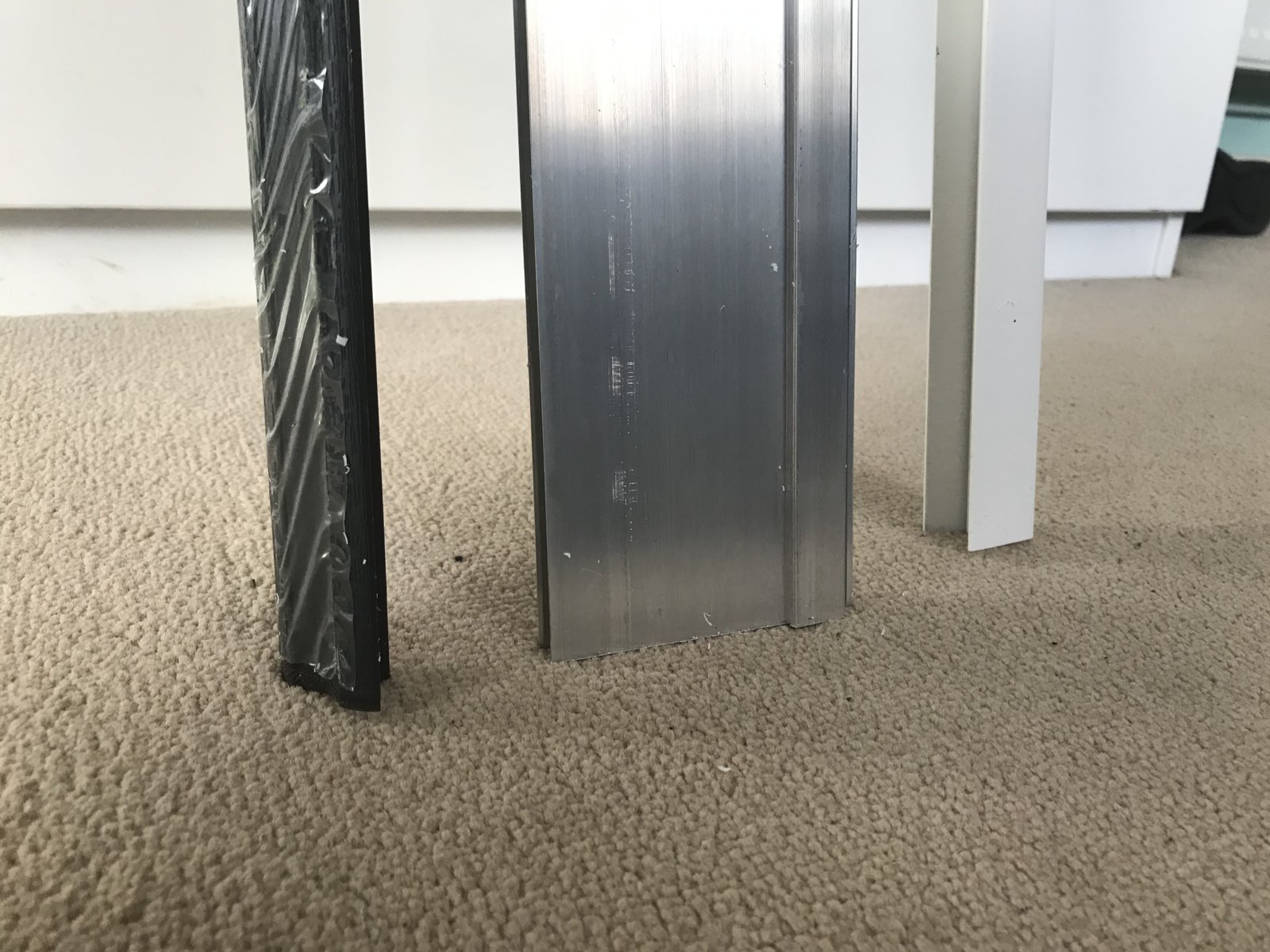

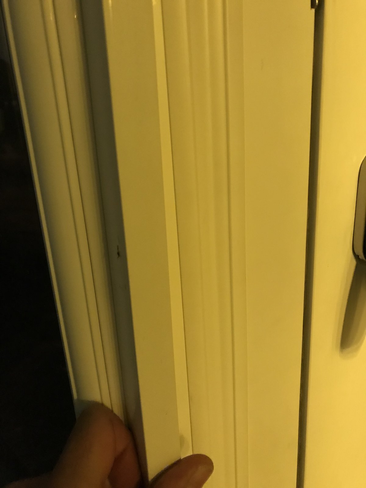

Have you got the Powerbar+ couplers?

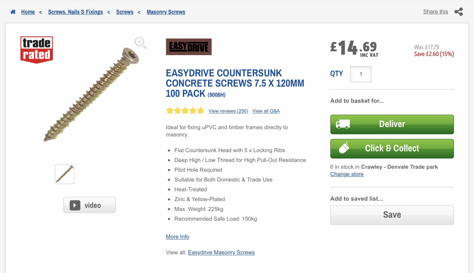

Oh, and I used the concrete screws to fix to the masonary but packed the gap tight to make sure the frame didn’t flex at all.
Powerbar+ couplers... than stumped me. I had to do a google search which came up DIYNOT thread started by ... you!
You’re famous!
I think they are Powerbar+ though. I’m not home for a few days but when I get back I’ll take a photo.

I was plastering over the brackets otherwise would have probably gone straight into the brick.

They are Powerbar couplers:

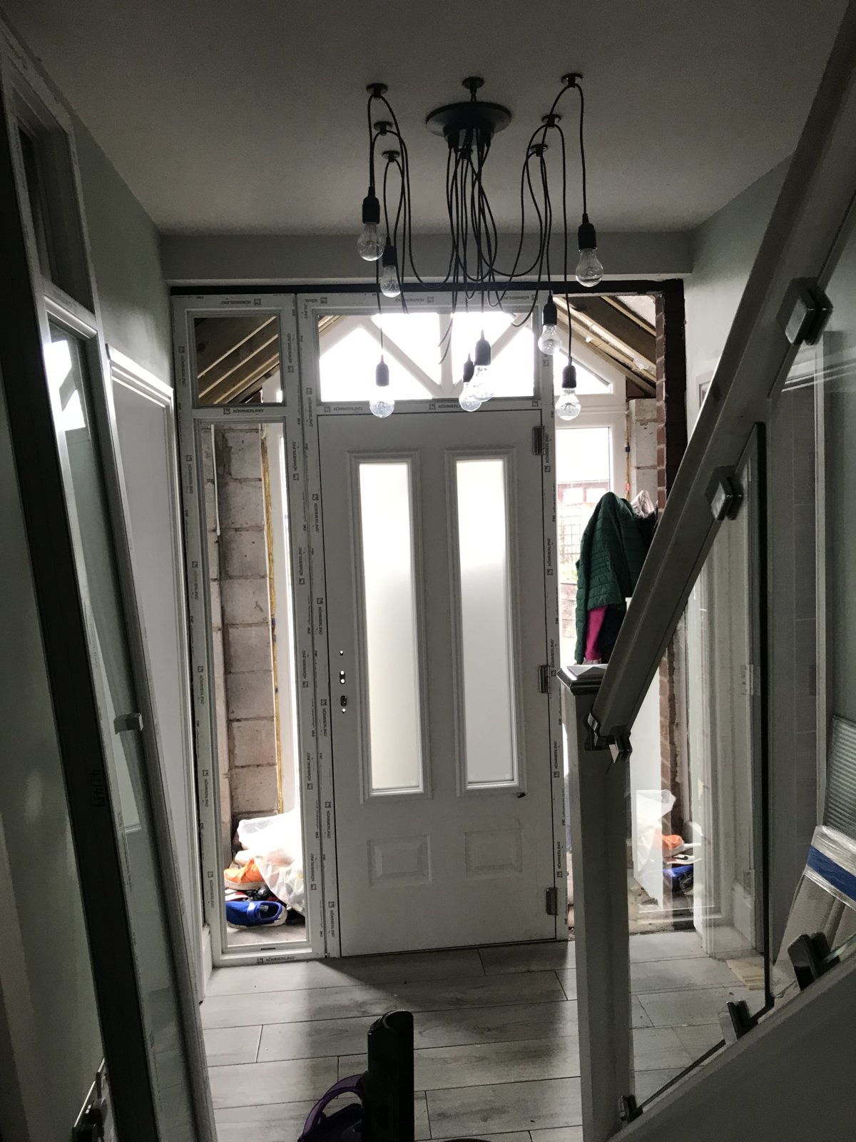

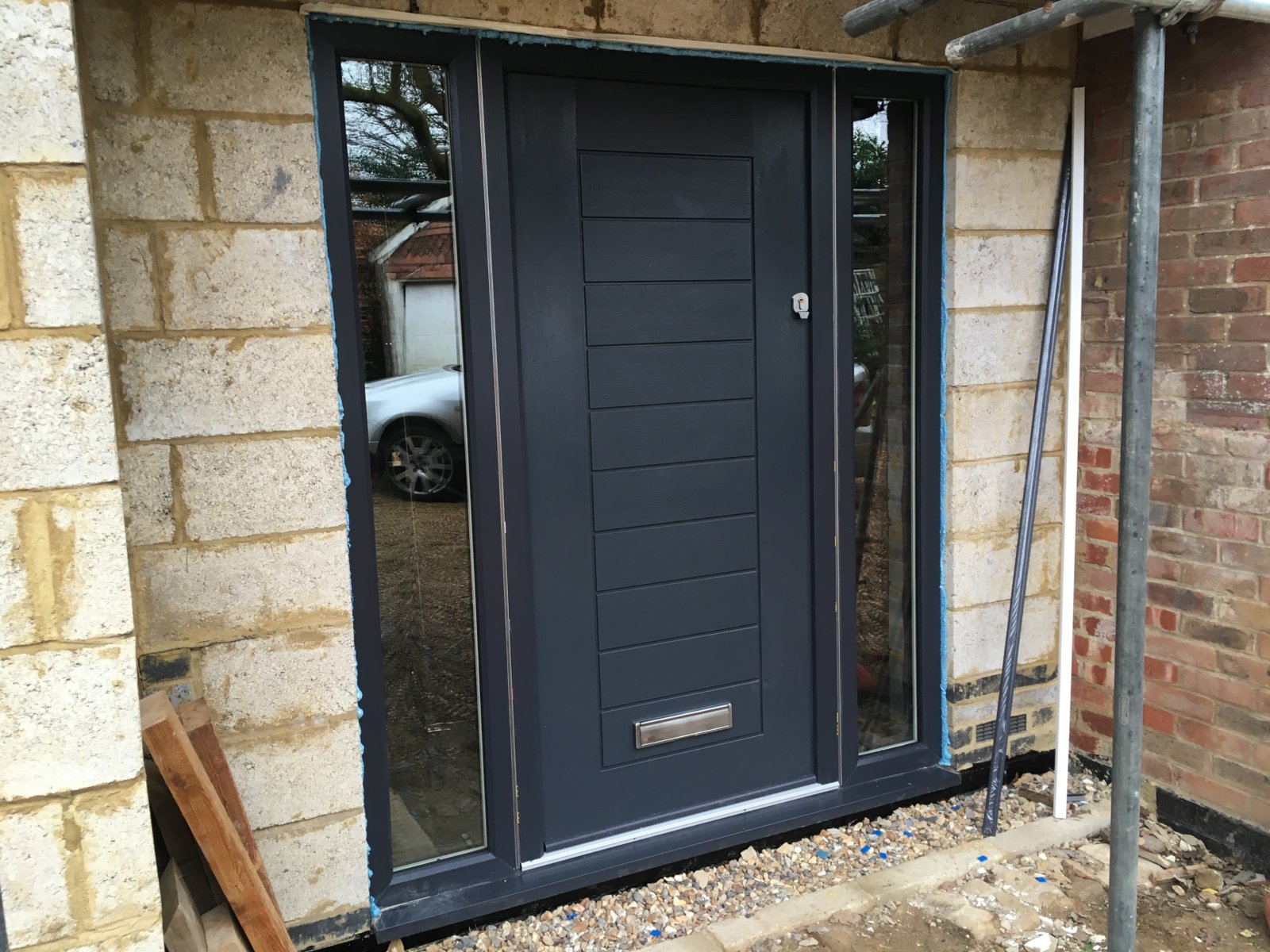

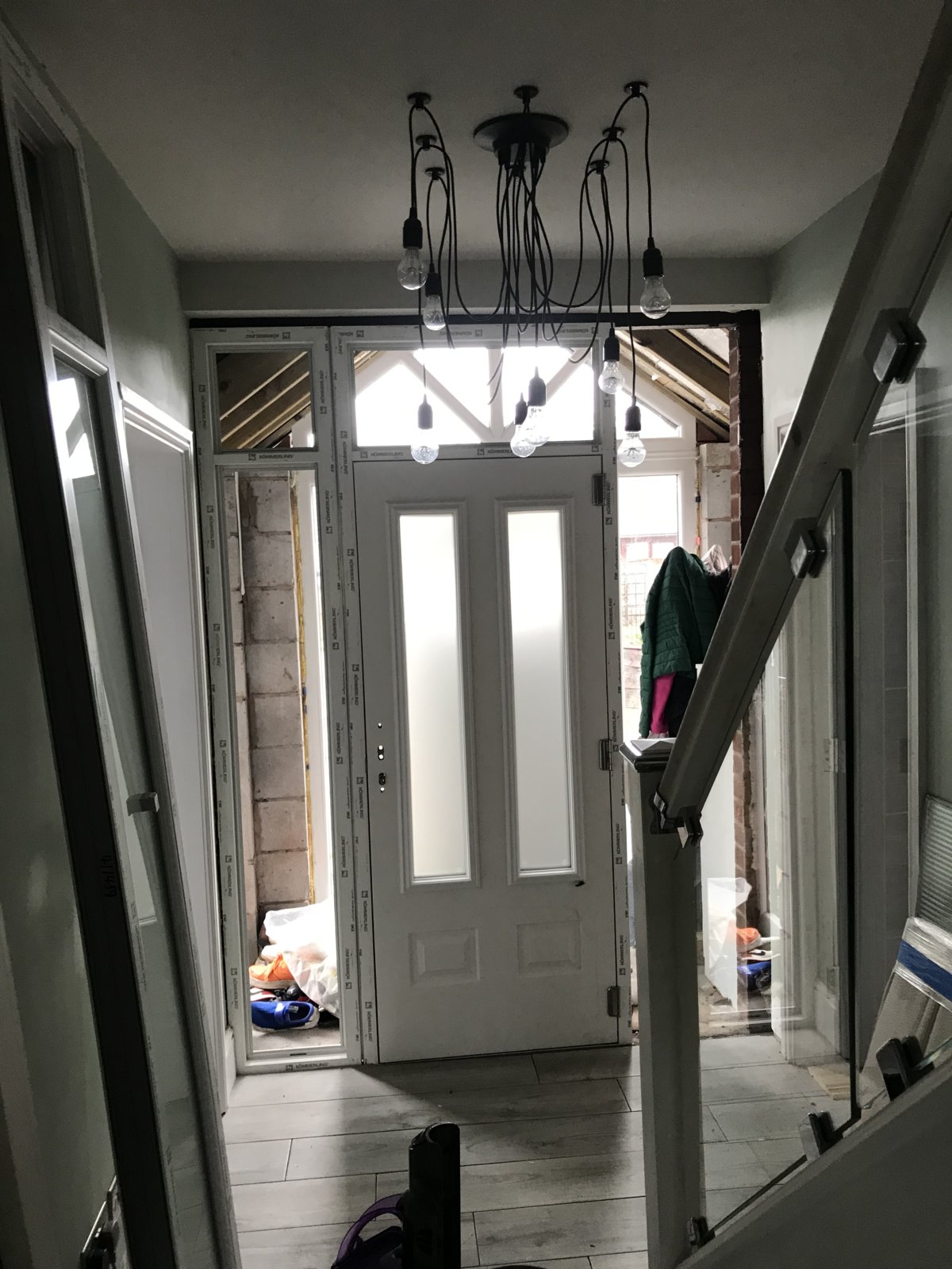

I installed the door yesterday but didn’t fix the sill. Would have been much easier if I had though as it would have stopped it moving when the door frame went in. As it is, the silicon has fixed the sill pretty well solid although I’m tempted to put a couple of concrete screws down through the frame and sill into the brickwork just make sure.
The rest of the installation went ok although there were a few issues.
I’ve had the door stored upright in it’s frame for a few weeks and I reckon it had already dropped in the frame such that the latch side was lower. So, despite getting everything plumb and level the door was not sitting right in the frame. So, I used packers against the aluminium coupler and also removed the bottom hinge and packed that out. It’s a good fit now. It is annoying though that the Solidor hinges are not adjustable.

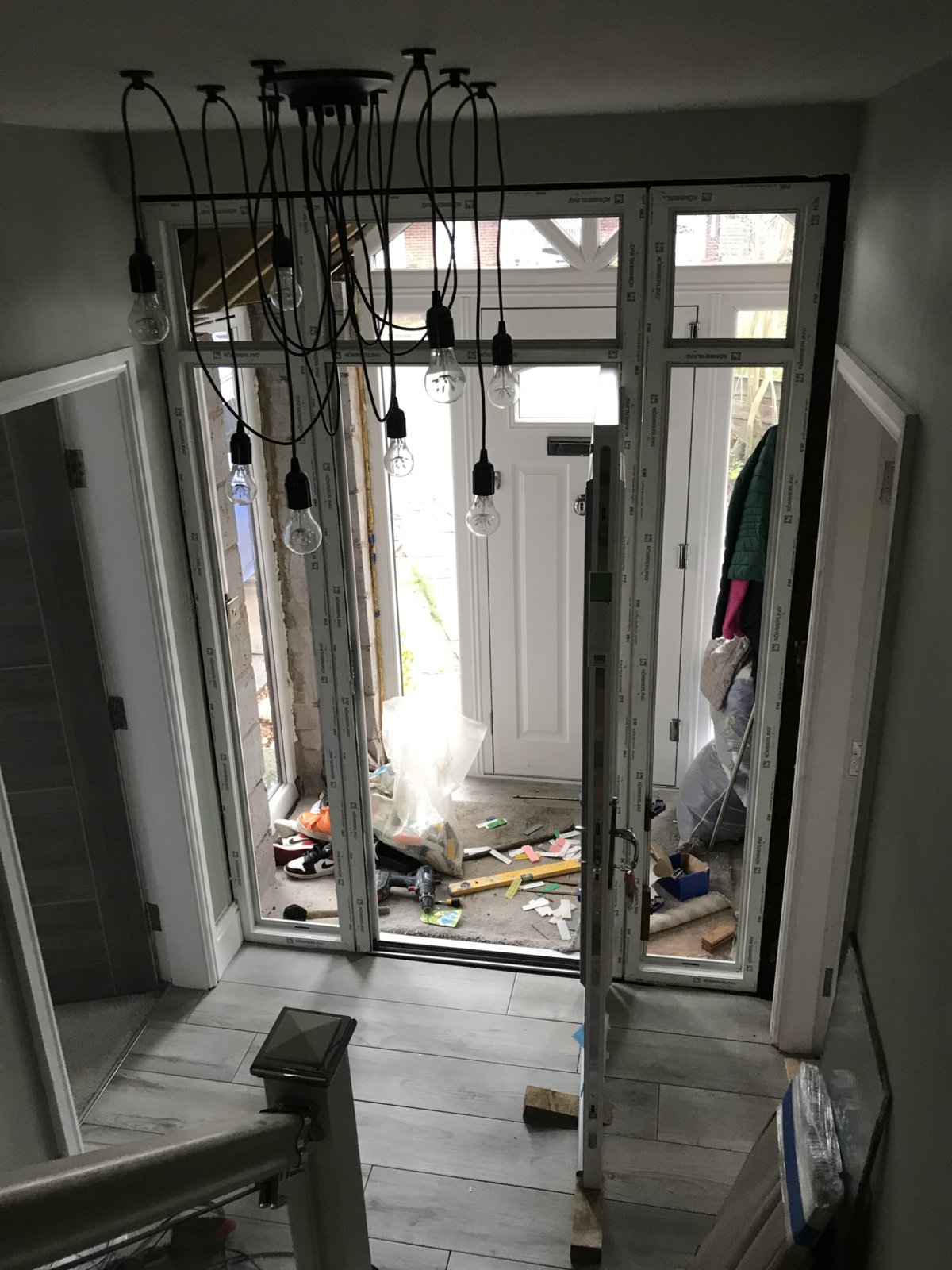

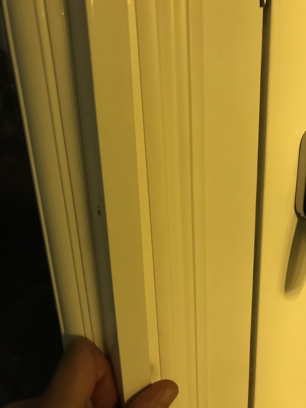

Also, the door threshold interferes with the coupler and kicks it out. Maybe I should have made the coupler shorter? See below:
Here is the finished product without the trims in. You can see where I’ve had to pack the frame out against the couplers.
I used 120mm Spax screws into the blockwork. Also 4.8 x 60mm and 80mm baypole screws to connect into the aluminium coupler and also up into the catnic lintel and they all worked really well.
All in all, pretty pleased so thanks for all the help!
