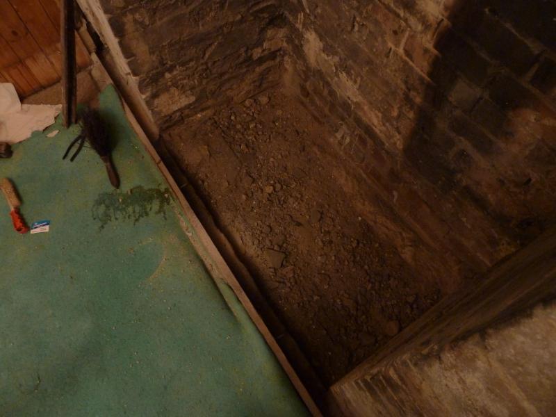

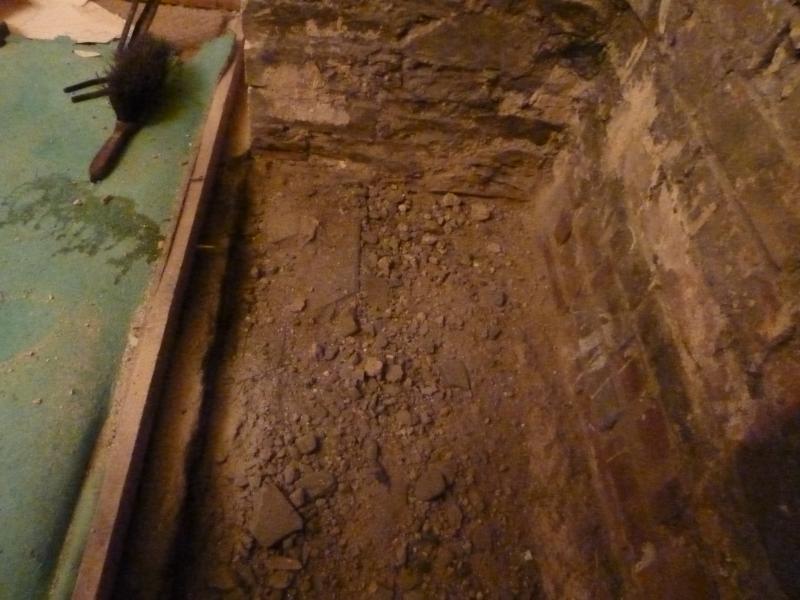

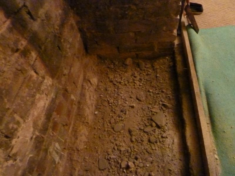

I've recently uncovered and opened up the fireplace in our living room.
Upon digging out all the backfill i've come to realise there's no solid constructional hearth, the concrete floor ends at the fireplace opening.
I've dug out 2" below the concrete floor so far and can see what I guess used to pass for a hearth which is (was) a layer of crumbly concrete which I've now removed. All that's there now is some thin bits of slate and under that smallish pebble stones. At the back right hand corner of the fireplace as you may be able to see in the photos, is some fairly tough mortar up against the brickwork.
What I'd like to know is:
How far do I need to continue digging down?
What are the layers of materials that I need to put in, in what order and in what thicknesses? Is it gravel, sharp sand then cement?
Do I need to put a DPM in there and if so, under which layer and any recommendations?
What type / mix ratio of cement should I use and are there any ready mix products that I could buy?
How much of each material am I likely to need? Opening is 1070 x 570 mm
For info, my plan is to finish the constructional hearth up to the concrete floor level, then put a 40mm thick superimposed slate hearth on that ready for the stove.
Thanks for reading and hope you can help.

Thanks for your reply Richard, we will be using a HETAS installer to fit the stove, register plate, flue, pot and certify it but I wanted to save a bit of money by getting the hearth and brickwork sorted first.
I've had a look through some of the links you posted but a lot of them are about rendering the brickwork which is something we don't want to do.
The stovesonline guide says:
If the hearth is on a non-combustible floor (for example and concrete floor slab) then the total thickness of the hearth and of the non-combustible floor must be 250mm or 125mm thick with a 50mm air gap underneath
There's no air gap to speak of as it's a solid floor in the living room, so based on the above if my slate hearth is 40mm my constructional hearth must be at least 210mm thick. Have I got that right? Does that mean the concrete needs to be 210mm thick or does that measurement include the sand and aggregate below it (if that's what I need) as that is obviously non-combustable also?[/quote]
Brilliant, cheers. I'll get digging.
I've been looking at Hanson dry mix cement, just add water stuff. They've got multi-purpose concrete, instant concrete and 40N concrete, does it matter which one I use? And do I need to put a steel re-bar or mesh in there to reinforce it?
Also, worth me putting a DPC down before pouring?
