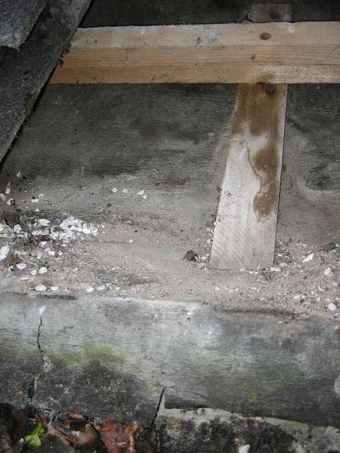

Couple of questions, you'll see in this picture there is a vertical fillet pinning the felt down, I'll need to chop that so I can slide the eaves tray under the felt, will there be any issue with that?

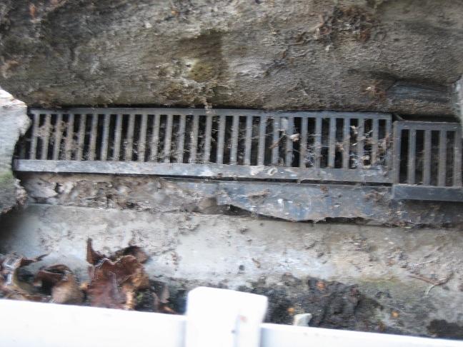

Also, there are redland redvents installed, will these eaves trays block the ventilation too much?
