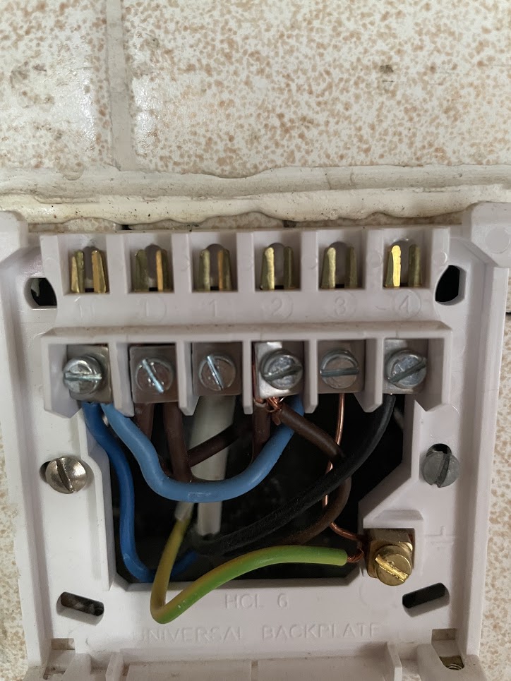

Hey everyone, I've just ordered a dual channel hive thermostat and my current wiring looks like this

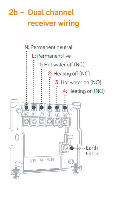

On the hive website this is what a dual channel install looks like
In order for it to work would i need to fill 1 and 3 or would it just work off my current install with only 2 and 4 full? I am a complete novice to this and any help would be appreciated
In case it makes a difference my boiler is a Worcester Greenstar 15Ri

Do you have two motorised valves in airing cupboard by the pump .
So at present you have no independent control of hw and CH and in summer when your hw is on you have to turn down the room stat to stop heating coming on ?
I have a gravity fed with no independent water and heating control. In summer i just close off the radiators
worcester 15ri would not be working on a gravity system your system is fully pumped without any controls you would be better spending the money on upgrading the system properly
Thought i had a gravity based on me having a separate cold and hot water tank. In that case would i be better off replacing the dual channel hive into a single channel or somehow wire it in?
yep change it for single channel but as i said money would be better spent upgrading system
