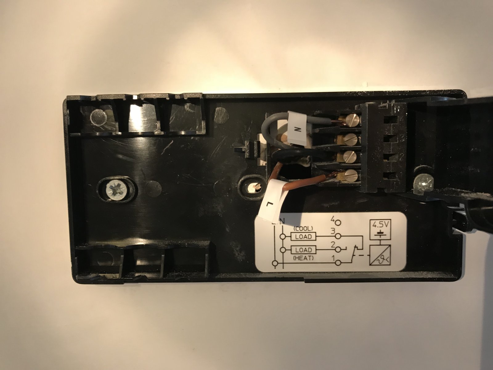

Hi there,
I have just installed Hive active heating myself and as there is a lack of information on self installing to combination boilers I thought I would post an article to show how it’s done. So I had an existing thermostat with 3 wires, live, neutral and CH (ON) already linked to the boiler so it was a case of just swapping the wiring for the connection into the back plate for the hive receiver and then the critical part is to also wire a wire from the live on the hive receiver to pin 1 common on the hive receiver. Job done!
I have attached some photos of the existing thermostat wiring as well as the new hive receiver back plate so you can see how it is done and which wires go to which.

hi mate, I'm about to do the same install.. when you say "wire a wire from live on the hiver receiver to pin 1 common on the hive reciver" Are you meaning just a small jump link cable on the back plate between 2 pins (on the same back plate) ?
also, from your images... what is the image with the BLACK back plate?

I just hope that whoever reads your post does not have volt free connections in their boiler.

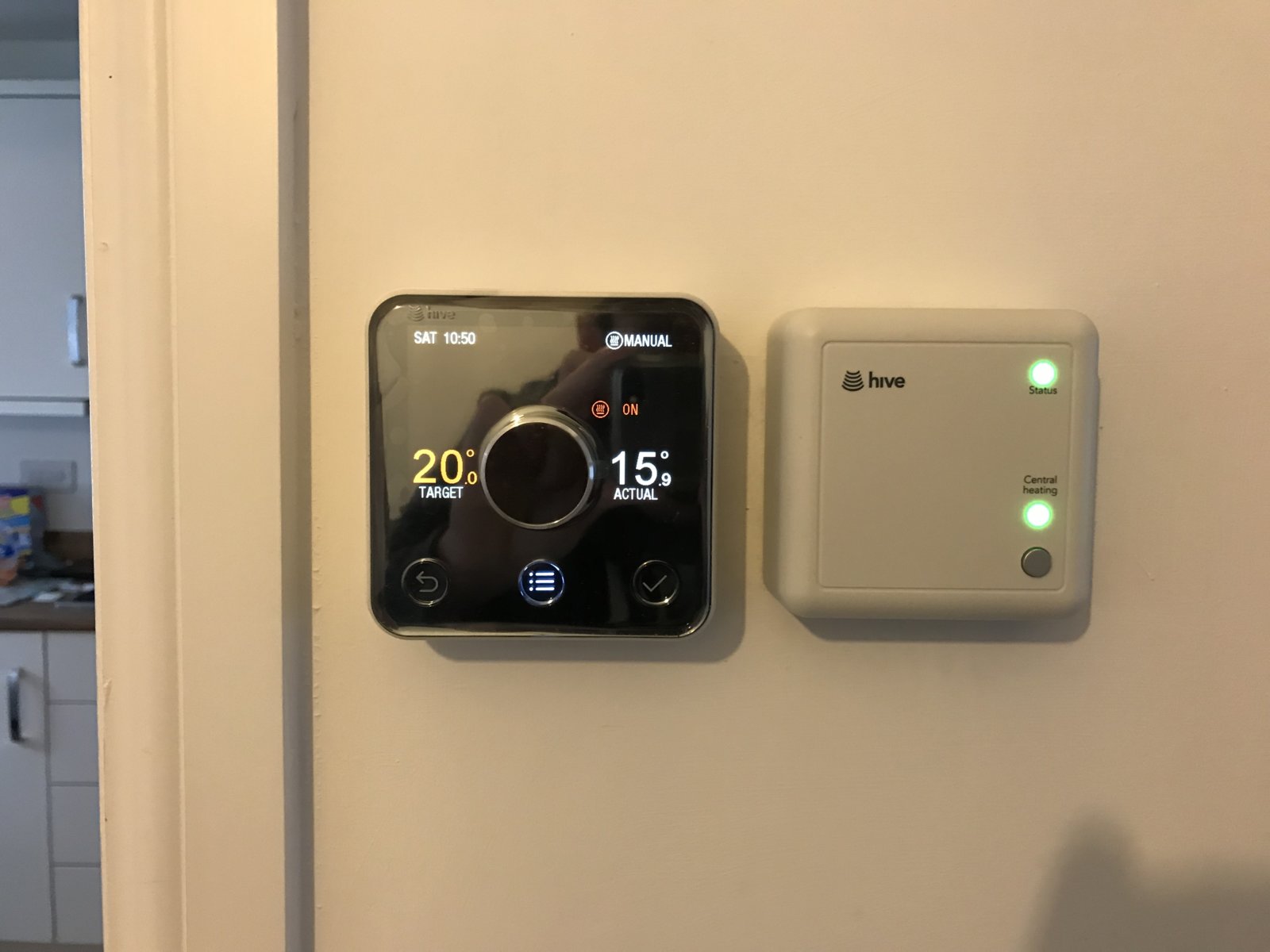

thanks.. I managed to get this done by just adding power to the thermostat area and connecting it up to the hive receiver.. now I have the hive receiver and the thermostat positioned alongside each other on the wall.. happy days :)
