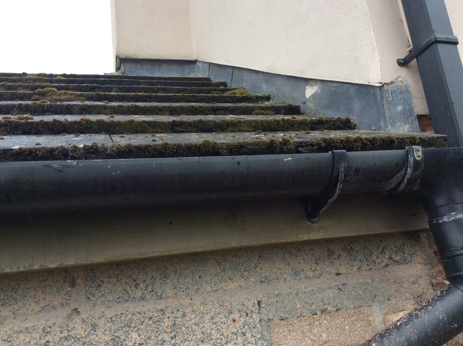

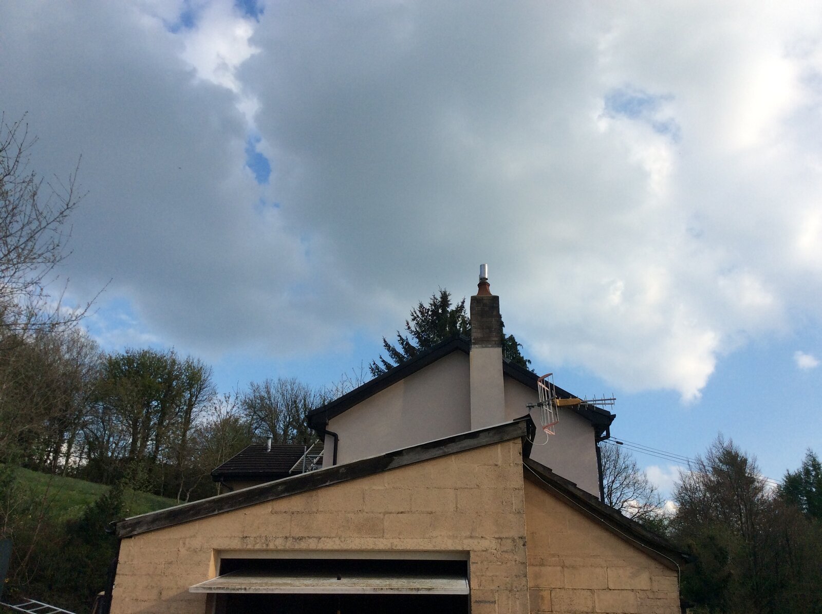

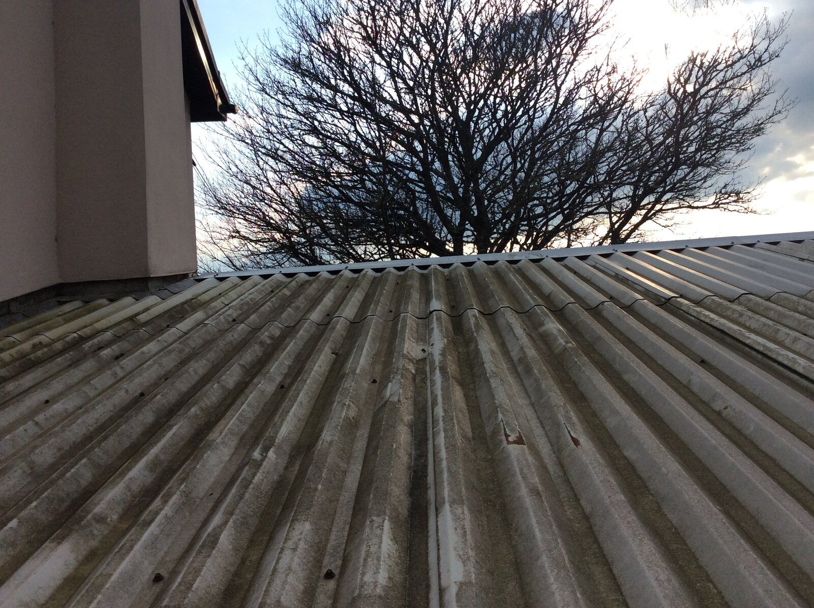

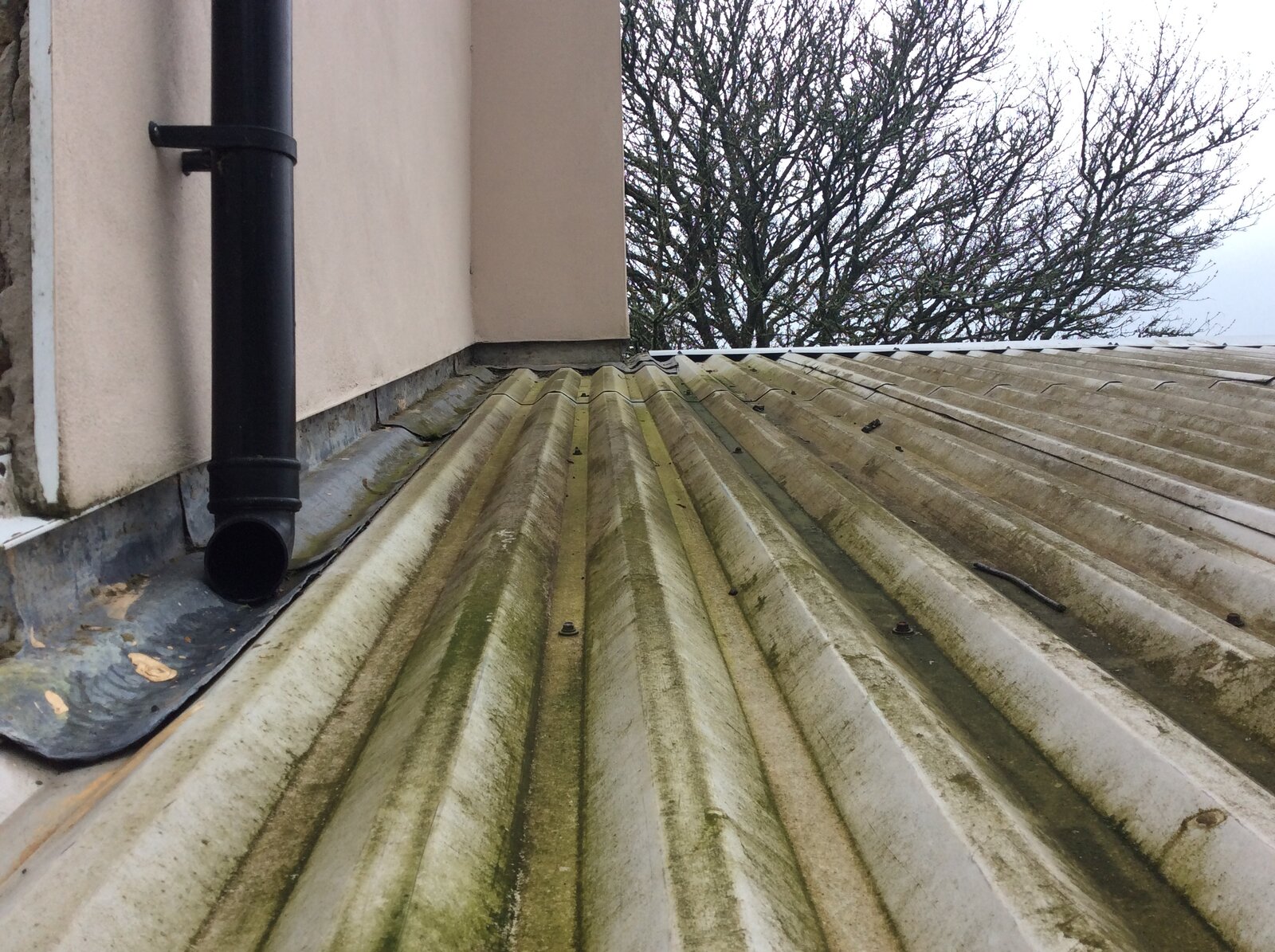

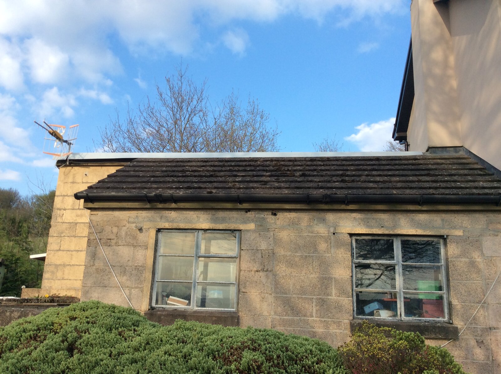

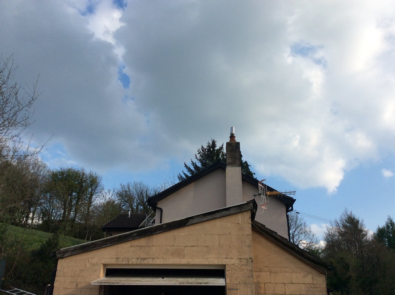

My garage currently has a corrugated fiber cement roof which is pretty leaky :(
I've arranged for a company to come and remove and dispose of the old roof panels (as the are likely asbestos containing) and need something new in its place.
I have contacted a few local roofing companies who all seem to want to push me towards a 'flat' roof style arrangement with torched felt at a cost of around £1500 (which by their own admission should last just 10-15 years).

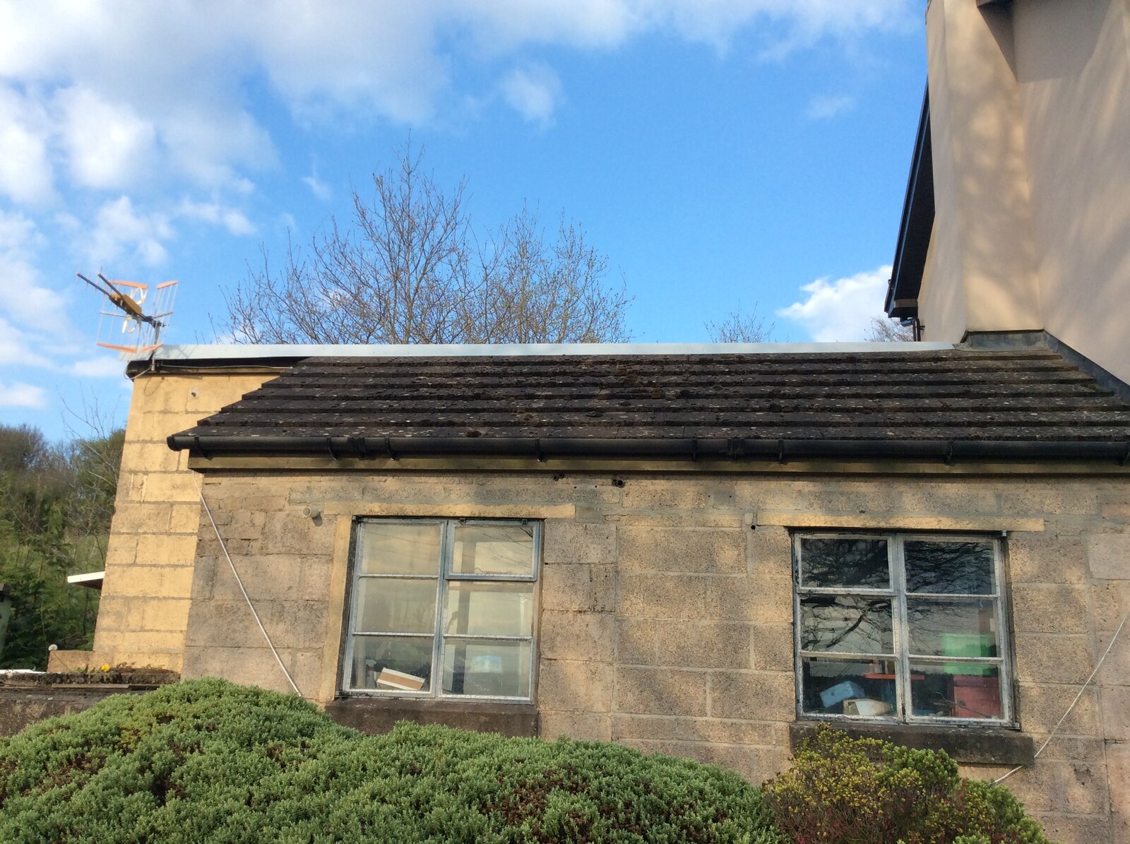

The roof is a bit of an odd shape, the description of the style is apparently 'saltbox' ... Like this ...
images

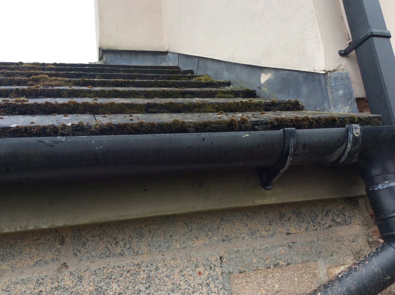

The corrugated panels are on the longer rear section, while the small front piece is tiles. Ridge tiles have been mortared over the joint.
I'm a fairly happy DIY'er (and it's only a garage) and have priced up replacement corrugated bitumen panels from Wickes at about £350.
The corrugated panels also have a ridge piece in matching colour (y).
Given that the instructions for these are to nail through the sheet into the beams, how should I finish the tiled side?
The ridge pieces have a matching corrugation which won't sit flush against the tile, and I'm pretty sure that nailing through clay tiles isn't going to work. Is there a better solution?
Also, for the sides. The current sheets are laid on a bed of mortar on top of the bricks. Is there something I can use to seal this joint without mortar, maybe dry verge caps?

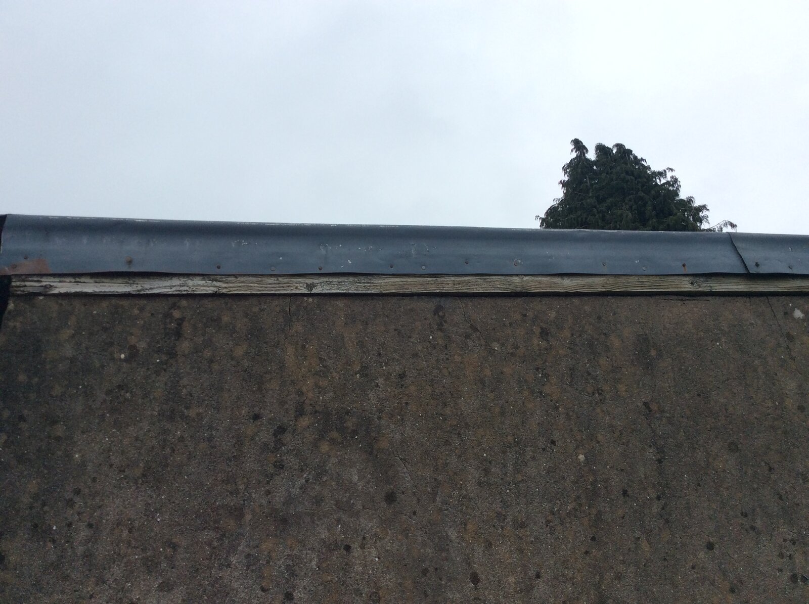

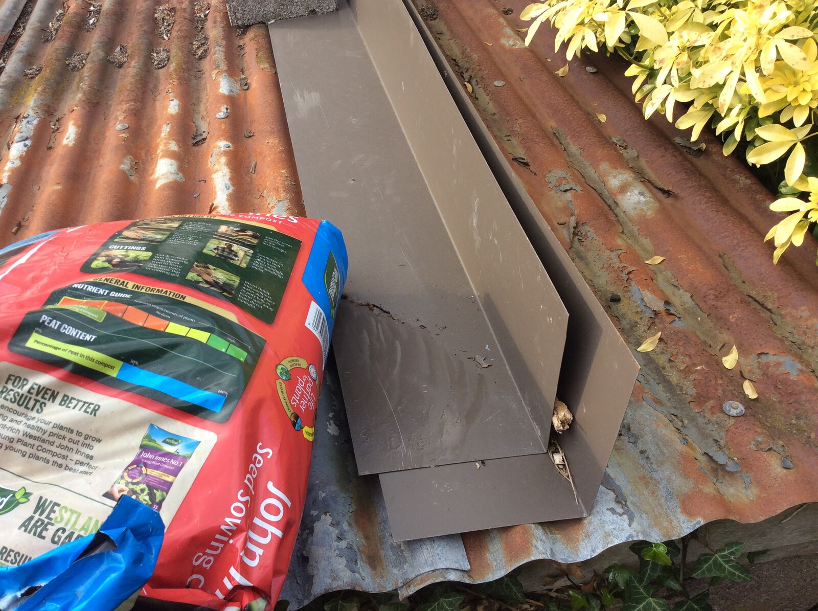

Thanks for coming back to me, can you also take a picture of how its finished against the other end (exposed wall)?
Just looking to see how you waterproofed the panels that end, and what you used for it :)
DCFF58E0-ADE0-453E-8A9A-8D12FAE40C0E.jpeg The end cap isn't on the exposed side of mine at the mo but can be done in a couple of ways.
Either have an overhang of the end sheet and bend it down over a barge board or finish flush with the end and use right angle lengths like in the ones in the picture on my rusty roof by the compost to cap it .post#3
