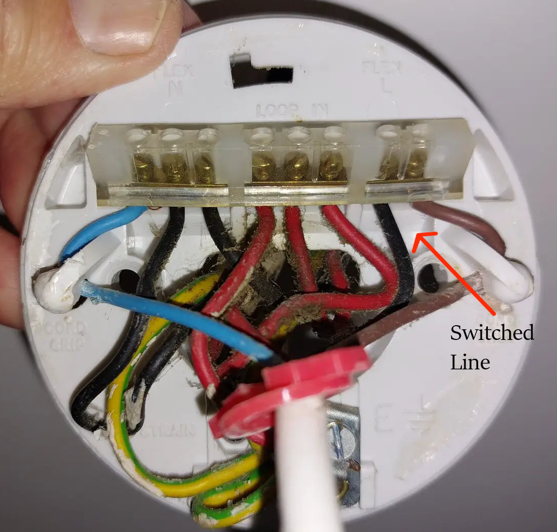

The original wiring has three sets of cables which are wired into a ceiling rose, as follows:

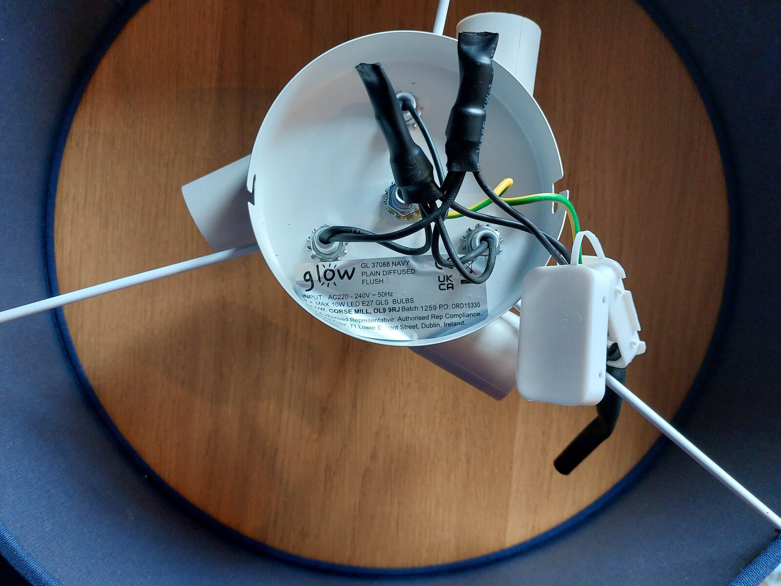

The wiring for the new light simply requires L, N and Earth, as follows:
I think undoing the ceiling rose and rewiring from scratch is going to be beyond me.
However, there is already a neutral and a live wire emerging from the rose into the current light fitting. Could I simply take those two wires and wire them into the new fitting? And if so what should I do with the earth?

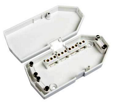

Try it, and see if you can connect the three earth conductors into that tiny connector block, cram in the rose ,and work out a way to fit the bracket . Or consider doing it the correct way by removing the rose ,connecting the wiring into a Suitable junction box,and running a 3 core flex from the junction box to the light fitting.
Probably a lot easier than what you are contemplating.
A junction box in the ceiling 1677083877252.pngis likely the best option, basic the ceiling rose acts as a junction box, so you need something to replace its junction box function. You could use some connector block and hid it under the new cover, the important thing it mark this wire
You don't want it to get mixed up with other black wire, it is the line to lamp, mark it with some tape or some thing, as important it does not get mixed up with other blacks which are neutrals.
