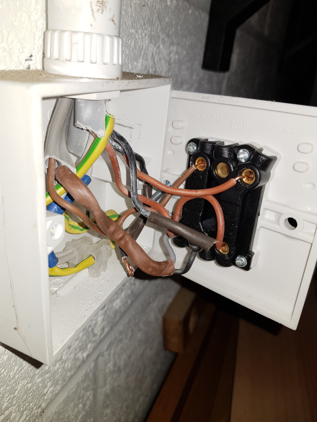

From what you've written:
So, Black (with brown wrapping at the switch), probably switched live,.is it connected to L1 terminal?
Grey (with blue at the switch) - neutral
Brown - permanent live.from supply side? Wired into common?
and Green/Yellow. - earth
A pic of wiring at switch would.be needed to confirm.
It seems that the old light supported an over-ride feature that needed a switched live from the switch. the new light doesn’t have this feature- although it may have a ‘pulse’ override facility. See the instructions!
The grey with the blue sleeve is the neutral.
the brown is the permanent live.
The black with brown sleeve will be the switched live.
We need to see the wiring to the switch, or you can determine which is which if you have a voltmeter.

Thanks for your responses. I've attached a couple of photos of the socket below. I do have a multimeter I borrowed from someone - although I've not used one before so need to look online as to how exactly I should check which cable is which and what settings to use on the multimeter. The socket on the right nearest the camera (or the left hand switch if you're looking at it from the front) is the one the old light used. The other socket is for the main light in the garage.

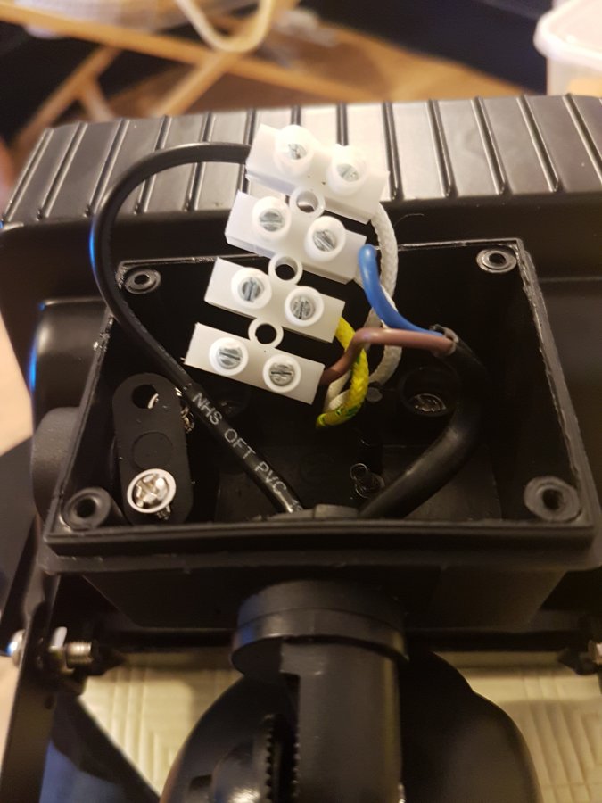

These are my options at the other end (connection to light). I'm aware it looks messy at the minute, and obviously won't be hanging down once it's all finished. That was just for the pic!
Ok. So. Grey(with blue sleeve) to neutral on the light.
Black with brown sleeve to live on the light. This is the switched live so you can disable the light by turning off one of the switches.
earth to earth.
Terminate the brown conductor in a spare terminal in the JB. It doesn’t go anywhere.

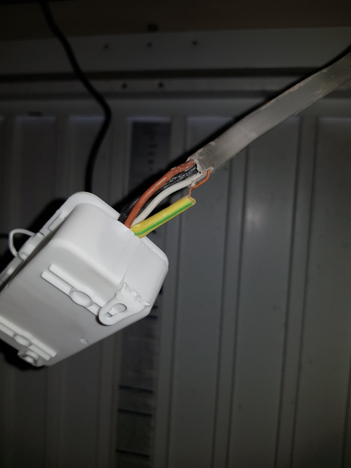

re the JB. That’s a mess. The cable sheath should be inside the box. The clamps at each end screw down on the outer sheath, not the inner cores.
