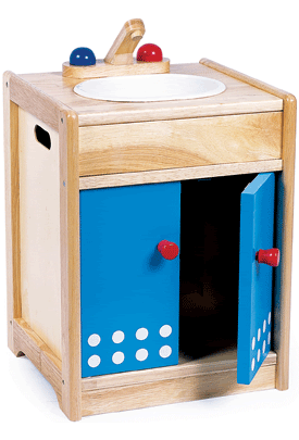

This is the only appliance i'd let a small child loose on in a kitchen.
