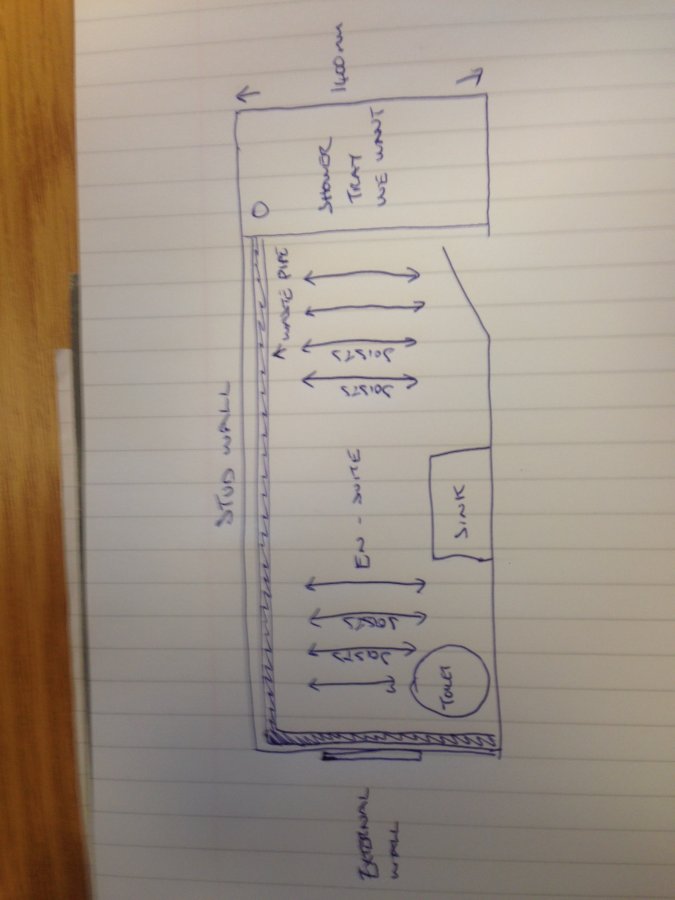

Hi
We have an en-suite upstairs and want to install a new shower. There was one there previously but was old and cracked. We want to install a new slim line shower tray. The previous occupants have the waste pipe above the floor boards because the joists run perpendicular to the waste pipe. I will keep it this way as I don't want to drill hows through all the joists as the shower is some way from the outside wall. So I guess it would be sensible to keep it above the floorboards for easier access and will not weaken all the joists?
What I would like advice on is that we know we will need to raise the shower tray up a bit again for the waste pipe but do I mount the tray on 4 by 2 bits of timber or do I mount it on bricks or something water proof. Do I paint the floor boards below it in a waterproof coating or membrane? Also most do not come with an up stand round the tray for you to tile over these days. Can I get material to run round the tray that I can tile over and create that extra seal?

Rob, it would be much better if you could put the tray on the floor and the waste out between or notched into the joists - a much nicer look and can be done with forethought!
However, if you would rather raise it up, then 3 or 4 by 2's with 18mm WBP ply on top is fine. If the ply is dead level then stick tray down with plenty of silicone, if it's slightly out of true (which it shouldn't be as you are building it) then use some sand/cement or tile adhesive and bed it down level with gentle tapping here and there. It wouldn't hurt to PVA the ply before laying tray.
Make sure tray is back to wall with an initial silicone seal to wall, then tile down to top of tray with finish silicone seal.
The outer "skirt" of the platform can be finished using some PVC cloaking strips that are available from Wickes or Eurocell - cheap as chips and quick to install; and can be stuck round the skirt using mitre fix and silicone.
You can use internal coving to edge your tray if it is to be tiled down to.

Just one last question though 'Dilalio' you suggested cutting through the joists so I could sink the tray to the floor. I am just concerned about the structural safety as the distance from the waste pipe to the wall is a least 3-4 metres. So that is a lot of joists to cut holes through. Is that safe?

Can you upload a sketch of the layout and rough route to stack?
Rob, you would need seriously large joists to be able to notch a 40mm waste pipe across them. Joists would need to be at least 330mm which I don't think you will have, so notching for the waste run is a non stater I'm afraid for exactly the reason you suggest. Drilling would need at least a 180mm joist with the issues of feeding the pipework through it and then getting the correct fall.
Jeff's idea around the easy plumb riser kit would be a good DIY option.
Wouldn't worry about screws rusting, just get galvanised screws.
Thanks Madrab that is what I thought. I have attached a rough sketch of the en-suite for anyone's interest. Apologies for the picture quality.

Where would waste go even if using raised tray? In boxing along stud wall? What dimensions are involved?
yes the filled in line on the diagram is the current waste pipe and it is boxed in on the wall so its hidden nicely.
Is there an external wall to the left/right of that drawing that you could get to or is it a terraced property?
I think I marked the external wall which is to the left of the sink and is where the pipe goes out. To the right of the shower is the internal wall which joins to the landing, the door marked on the diagram leads to the bedroom. the wall the waste pipe follows against is a stud wall the main bathroom.
