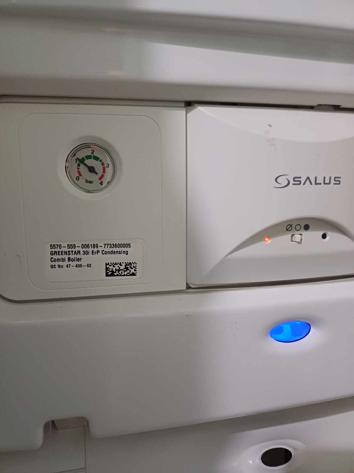

What is the model of your boiler and can we have a photo of the front panel?
It sounds as if you have a boiler with an integral wireless Salus receiver.
If there hasn't been an external thermostat installed previously, whether a new stat is a DIY install, depends on the boiler. Often with modern boilers, reaching the wiring terminals, involves removing the cover; this may form part of the room sealing of the boiler - a job for a registered gas installer.

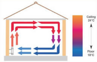

The central heating is normally controlled by TRV (thermostatic radiator valve) which being on the radiator are in an ideal position to monitor the return air temperature, circulation.jpg however they have a problem, in that the basic unit can't turn the boiler on/off, it can by the return water temperature turn it up/down, but in the basic form there is no electrical connection, so we use some sort of hub/thermostat to switch whole system on and off.

I have no idea if the Salus unit can be removed, think it connects to ebus, so not really a DIY job.

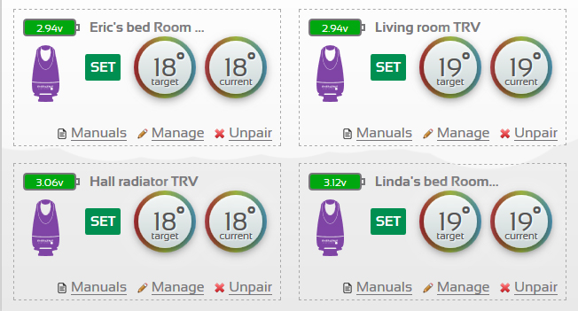

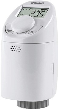

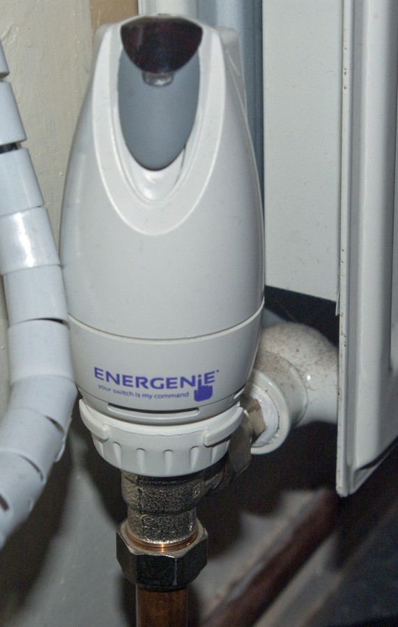

But simple method is use electronic TRV heads. The eQ-3 was bluetooth, so need to be close, but in 2019 cost me £15 each, so cheap, EQ-3 Bluetooth Smart Radiator Thermostat.jpg and you can set manually, the Energenie IMGP8035.jpg has no manual options, needs a hub, uses IFTTT and have tried using the geofencing, but the anti-hysteresis software is OTT so did not really work with geofencing, the Kasa was to replace a damaged Energenie 1730637625201.png it has worked well, it has loads of info from the phone, including charts as to how it has preformed, it was maybe a mistake for me, but wanted one which used internet not bluetooth, and Kasa will work with phone.
The eQ-3 does not show current, only target temperature, the TRV-report1.jpg current and target temperature display I found helped setting the lock shield valves.

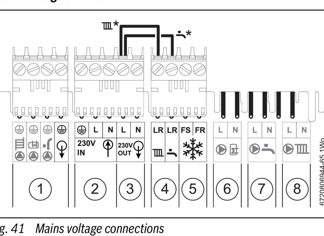

Your Greenstar 30i ErP has a cover that does form part of the room sealing of the boiler. You should get an RGI to install the connections, or get the boiler checked by them afterwards.
If for example, a Hive for combi.(single channel) was to be connected..
The link wire to LR heating would be removed.
Using a 3 core and earth cable;
The L and N to the Hive receiver would connect to terminals 3 L and N on the boiler.
LR heating on terminal 4, would connect to Hive terminal 3.
A link would be added between L and terminal 1 on the Hive.
The earth connections would be made, and the switch on the Salus receiver would be turned to permanently on.
