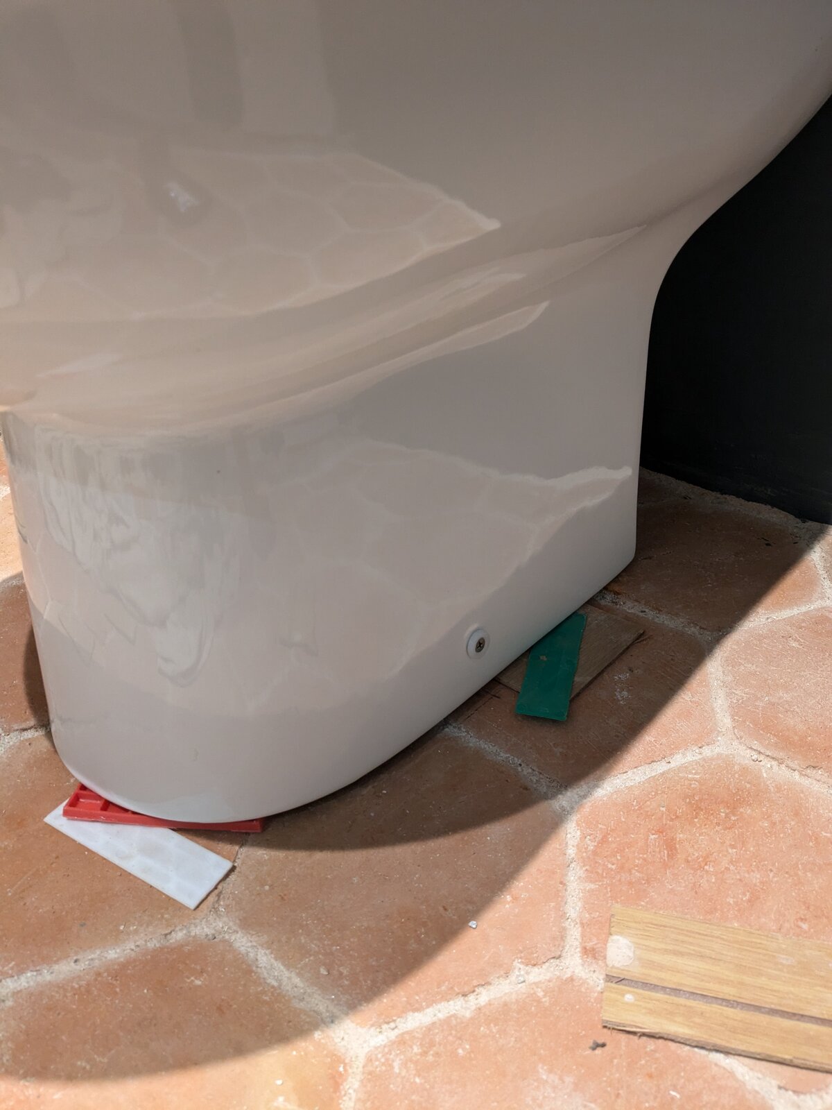

My floor tiling is, er, rustique.... But base of toilet pan is not....
Options? Grip fill then silicone over to cover? Sand n cement then silicone?
Any better ideas?
Masking tape on the white ceramic toilet.
Masking tape around floor tiles.
I used 2 pack wood filler on my own toilet 15 + years ago. Pull masking before filler sets.
When dry silicone around.
That's how I done mine
Thanks, I think I'll do same with grip fill... End of the day it only needs something solid under it eh!
