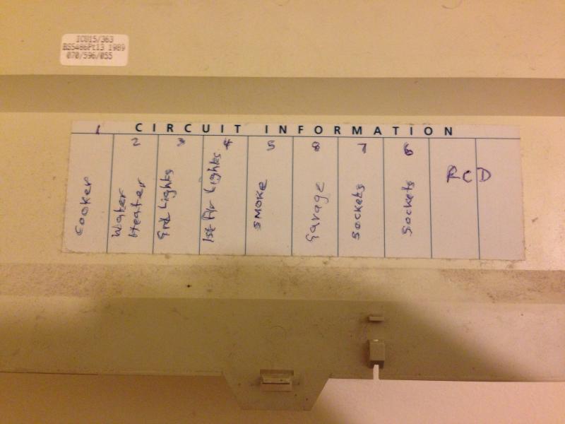

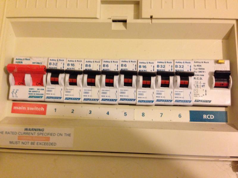

Just checked the Consumer Board and there are no empty slots. So from the the following options which is most desirable from a costs perspective but keeping with the rules etc? Or is there another way?
1. Replace the current Consumer Board with new one with enough slots.
2. Add a separate CB just for the Ovens etc.
OK
The Smoke Alarm circuit does not need to be on its own MCB. In fact, smoke alarm companies like Aico recommend that it is better if these are on a regularly used lighting circuit. It then becomes quickly obvious if the MCB has tripped!
OK, so that frees up a slot on your consumer unit. Then you'll need an Ashley& Rock 32A MCB for the new circuit to the ovens.
If the cabling for the new ovens will be concealed (in walls etc) less than 50mm from the surface, then the breaker will need to be put on the RCD side of that split load board.,
That may mean messing around with the busbars of that split-load board.
A job for your electrician, i would suggest.
But it is easily do-able.
