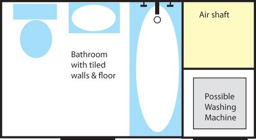

Hope to get some help (and I hope encouragement) with a somewhat unconventional washing machine installation in a closet.
I live on the top floor in a 3-story old brownstone with a tiny kitchen and bathroom with no space for a washing machine in either one. The only place I found that I could possibly fit a washing machine is the closet next to the bathroom. Thinking of a compact washer/dryer combo that turns heat into condensation (so I don't need to worry about air circulation, but could always open up a hole to the air shaft for this as well).
Now the challenge is really the installation or more specifically getting water in and out. The link below is an image of my floor plan.
Basically I was thinking that I could cut a hole in the back wall of the closet leading out into an air shaft and then draw both water in and drainage out through the air shaft and into the back wall of the bathroom, where the plumbing for the bathroom is.
The bathroom is tiled and I would have to break tiles to get into the wall to draw pipes and hook the stuff up, but I have extra tiles so this should not be a problem to patch up in the end.
My questions are:
1. Is this even a feasible idea? Not sure about any U.S. laws against this.
2. Not sure how the drainage is hooked up in the wall, might have to go all the way to the drainage for the sink as the bathtub drain is probably not accessible with the built in tub on top of it.
3. Going out in the air shaft, can I have the drainage slope upwards until where I need a bend in the pipe (going into the back wall of the bathroom) where I would have it slope downwards again? How high do I need to go in general to not get back flush into the machine.
4. Do I need to waterproof the closet in any way, a little afraid that any leak would go through the floor to my neighbor (and landlord) below. Yes, I did ask them about this, they trust me to find a responsible solution...
5. Any other things I might not have considered making this a bad idea...
I am thinking to possibly having someone professional helping me out with this, but want to just confirm this idea first.
Thanks for any advise and tips.
Paul.
hiya, bit of a dilemma I see. Though I dont have a complete solution for you but if I get your idea right, running water waste and supply through the air shaft, please make some enquiries for the healtha dn safety of all residents re legionella- a water borne air carried bacteria. Wouldn't want you to cause ill health to self or other neighbours- or worst, be liable for it and fined etc...
Sorry to put a dampner on it.
Anyway...I thought you would need to go under the floor of the closet under the bath and adapt the waste and tap into the cold supply there. Damproofing the floor boards or lowering a tray here(under the floor boards under the machine) to nillify a spillage.
Good luck with this one my friend.
Alternatively get friendly with the ground floor resident that might have a washer already !!!
:LOL:
hi paul,
the only way i can see that is easy, would be to get water from the vanity unit (hand baisen) drainage at same point, run your waste and hot & cold to the right of the vanity then along the base of the bath through the wall then following to the area you want. now depending on your flooring which i believe is tile you can build a small step up to your bath this step up will cover the exposed pipes. the step up can be bad of treated timber covered with fibro sheeting then tiled as well obviously fastened to floor.
doing anything to your airwell could be against fire safety and building regs

Would appear that the water and waste are easily connected thru the wall to supply under the faucet end of the tub.

Hey Paul Is your kitchen anywhere near the proposed installation ? perhaps to go that way would be a better idea....maybe you need to post a floor plan of your apartment for further ideas and hopefully expert solutions....?
