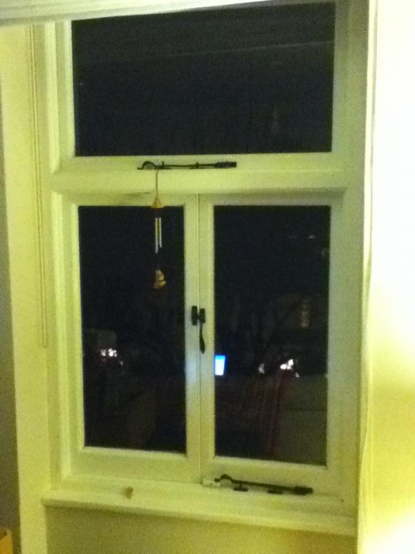

Can anyone tell me if all windows can be fitted from the inside please? We want to replace out single-pane wooden windows but live on the third floor and want to avoid paying for scaffolding if at all possible.
If it helps, we live in a victorian conversion and the external brickwork is narrower than the internal (if that makes sense?).

Yes, used to fit windows all the time this way.
What kind of windows are you fitting, wooden/plastic, tilt turn, "H hinges", sliding sash or casement?

We are not in a conservation area, but we would be keen to find something which (at least from street level) looks similar to our wooden casements.
Pine not - thanks for the reply. We would love to go with wood, but we are being quoted £3500 upwards for just 2 windows which we are struggling to justify. This leaves us with upvc or aluminium(?) I suppose.
What is recommended - should I just contact a local fitter? I assume I should go for someone who stocks the big names (I.e. koemmerling etc)?

Have you removed the original windows yet?
what is the reason for replacement?

They are still in, but are in a sore state. They were rotten when we bought the place 5 years ago and are now more filler than wood...

This is the better of the two windows (they are the same, but this has less rot).
It is 950x1550 and both casements open. What a beaut.
If the rot you speak of is in the external cill, it can be fixed with a half cill. If any of the stiles or top/bottom runners are rotted they can generally be repaired (pics of rot please) etc.etc.
Your window looks o.k. from the pic but some more detailed ones will tell more.
You asked whether the windows could be fitted from the inside however and my answer is still yes should you still decide on that course of action.
First you would have to remove all the reveals, plaster, wood - whatever, until the casing edges are completely revealed. Then remove the opening sashes, your now left with the casing intact, by cutting through both the bottom runner, cill and all, and the transom above, both at the angle,
