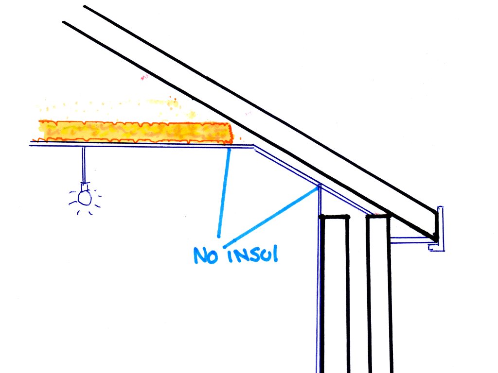

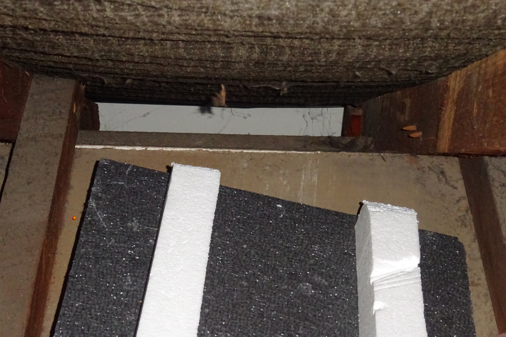

I have a sloping ceiling in the bedrooms outer walls because the room sort of gos into the loft space. So when I am laying insulation I am careful not to push it too close to the edge so as to not block the air from the soffett bellow but that leaves an uninsulated section of ceiling. see my diagram here - its not quite right but give an idea

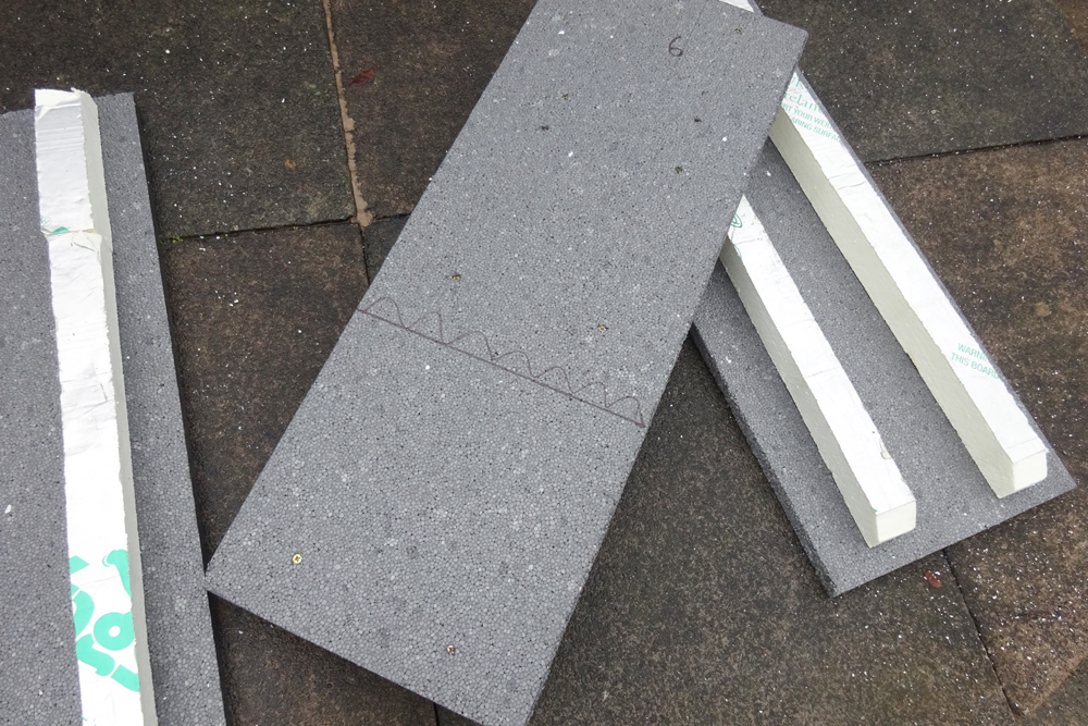

I got some 25mm jablite high performance and with some beefy 5x60mm single thread screws I found that I only needed them to hold the parts together while handling as they are tight when in place I attached 50mm polystyrene and kningspan battens as stand offs that would fit tight against the underfelt and keep the 25mm jablite pushed against the sloping plasterboard picture here
The uninsulated slope section is 13 inch deep and marked with the squiggly marker pen so when I am pushing it down I know when to stop.

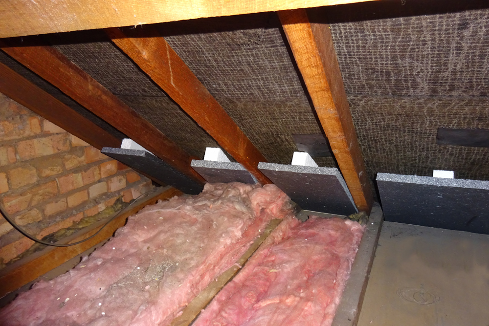

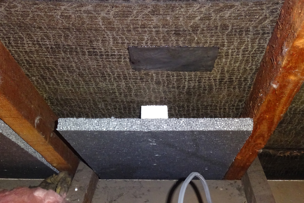

Here is one pushed down but the air vents in the white soffett seen at the bottom are out of view due to the angle as its very tight up there to get a picture

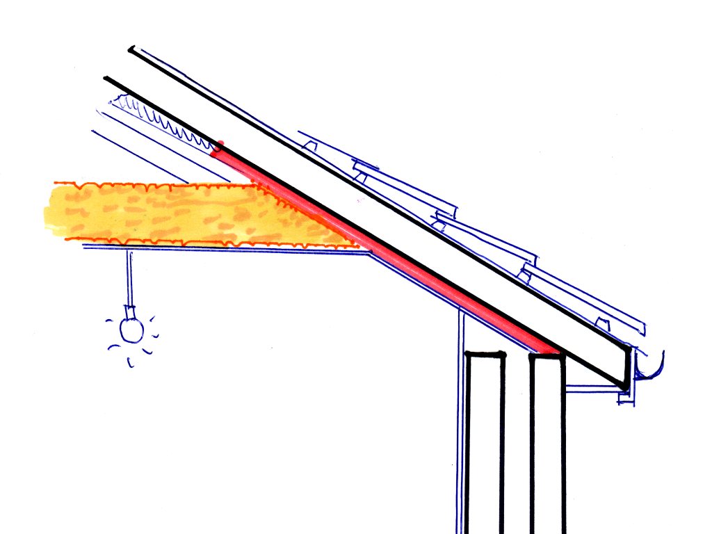

Here is the diagram of how it is now - the pink part is the jablite
So now I can add extra loft insulation and push it right up to the jablite knowing that I am also maintaining the air flow

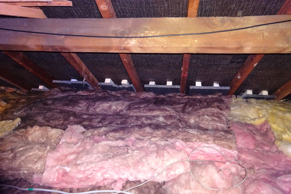

Here is a section in progress
And here it is with the extra insulation
