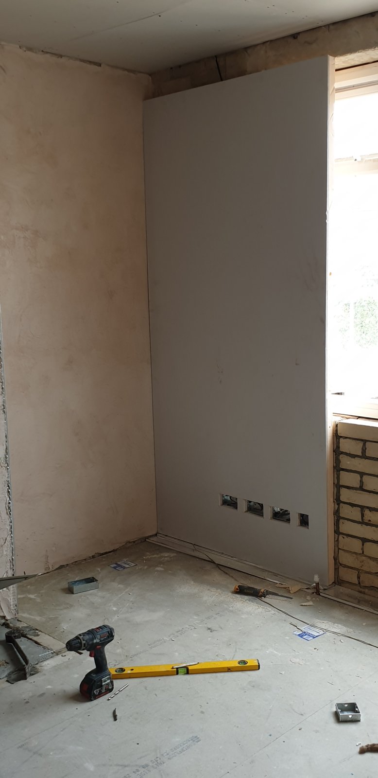

Knauf xps laminate plus would be ideal. £51 per sheet from Wickes. Can't see any problem with damp as the extruded foam backing would act as a vapour barrier. I just used this product on a cold wall in my house. Dabbed it on and skimmed it. Fab product.
