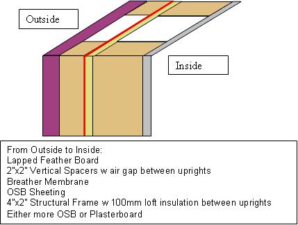

Walls were going to be built something like below, and I haven't really thought about the ceiling / roof yet.
Would probably add the insulation and internal boarding at a later date, but obviously I can't do much about the subfloor / base at a later date, so have to get that right off the bat.
Should probably have added that it is already dug out to around 12" depth as I was planning to put decking there but never got round to it (plus it's always in shade sho not really a good place for decking)
You can do away with the osb sheathing, unless security is a massive concern, and plywood the inside instead with the money you save. 2x1 treated battens will be more suitable than 2x2, and cheaper. You should use a polythene vapour barrier on the internal framework, before boarding out. (walls and ceiling, and tape all overlaps)
