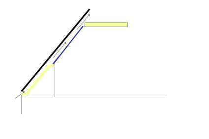

Any problem with just pushing mineral wool insulation or those polystrene boards between the joists of a plasterboard wall in a room built in the eaves? Want the simplest, cheapest temporary solution...
Currently have netted up insulation roll (yellow in drawing) between rafters with a 50mm gap behind ..fixed so that there is air flow from the soffit. sloping ceiling bit almost touches rafters -so have that foil bubble wrap stuff between the rafters on the outside of ceiling (blue in drawing).
The 'cupboard' is freezing -and so is the room...
There is little insulation under the floor in the storage cupboard (boarded) - the room underneath is cold too. Also under the bath is open to this cupboard - thinking about covering the end with a board (insulated)?.
End walls are outside ones (I think with cavity wall insulation)
Also inside the room one of the outside walls is batoned and plasterboarded - could I make a small hole in the top and fill with expanding (fire safe) foam? can't seem to get any other access to it...
Any advice/ideas appreciated....
Sorry - Ok I'll try and be clearer - was actually trying to simplify it :oops:
Have annotated drawing -hopefully making it clearer ...
First a funny shaped house with an uneven pitched roof - this is one room wide bit that sticks out - a normal sized room downstairs and upstairs was a tiny bathroom (with attic area above) and effectively a second attic storage area .
Bathroom has been extended (by dodgy DIYer) into the storage area -it is a weird shape. And it is freezing in there....
Ideally the whole lot needs to be redone...so just want to do the best I can for now without spending too much or re plasterboarding etc.
So I netted up insulation to the rafters in the 'cupboard', lined the sloping ceiling bit with the foil bubblewrap stuff (gap from sloped part of bathroom ceiling to underside of roof is only approx 5cm) and joined it onto the insulation in attic -with a gap behind to allow air flow (thought it might direct and encourage good airflow -suspect the extension might have interfered with the normal eave to eave flow). Supposedly this made an insulated box around the 'cupboard' and the bathroom...
but it is still cold...and very draughty in the 'cupboard'.
I think I should leave the 'insulated box' as it is...but add to it...
So I was wondering if I could just stuff/net mineral roll or cheap board insulation (where I can- some areas won't be possible) onto the plasterboard walls of the actual bathroom area (worried about waterproof membranes???? -don't know if that would be relevant in this case).
The 'cupboard' floor is partially boarded with the old insulation underneath (like a badly insulated loft space! :idea: ) - the downstairs room is cold too - thought I could maybe put some insulation down under the boards to warm up the room downstairs...
It is hard to describe - the bath is kind of built in - against 2 walls and where the bath panel would be is a tongue and groove panel with a tiled top - but the plumbing end is open to the 'cupboard' - If I board this up and seal it (and maybe insulate it?) there will be no ventilation under the bath - will that matter?
Finally as in the diagram there is a strutted plasterboard wall lining on one of the brick walls I know from making a hole in it by accident (where I found shampoo and conditioner that had been boarded up :roll:!) it seems to run almost floor to ceiling with no 'noggins' I can't get to this from the attic or 'cupboard' -but could make a small hole in the top and fill it with expanding foam ...unless that is a terrible idea....
Does all this seem acceptable... if not all what bits could I do and what shouldn't I????
Any help/advice greatly appreciated ,,,
Thank you - hoping this is much much clearer -if very long!!!

dont block off completly or youlle have condensation probs yuo need air in your soffit
Good point...actually moved on a bit from situation here - pulled some of the netted insulation down and discovered what I thought was a leaking roof - turns out it was condensation from where the insulation must have been pushed in...rafter insulation has gone and now have continous approx 75cm thick polystrene board insulation on the plasterboard wall - and lots of insulation under the bath...hard to tell cos weather is warmer but seems much less draughty! :)
