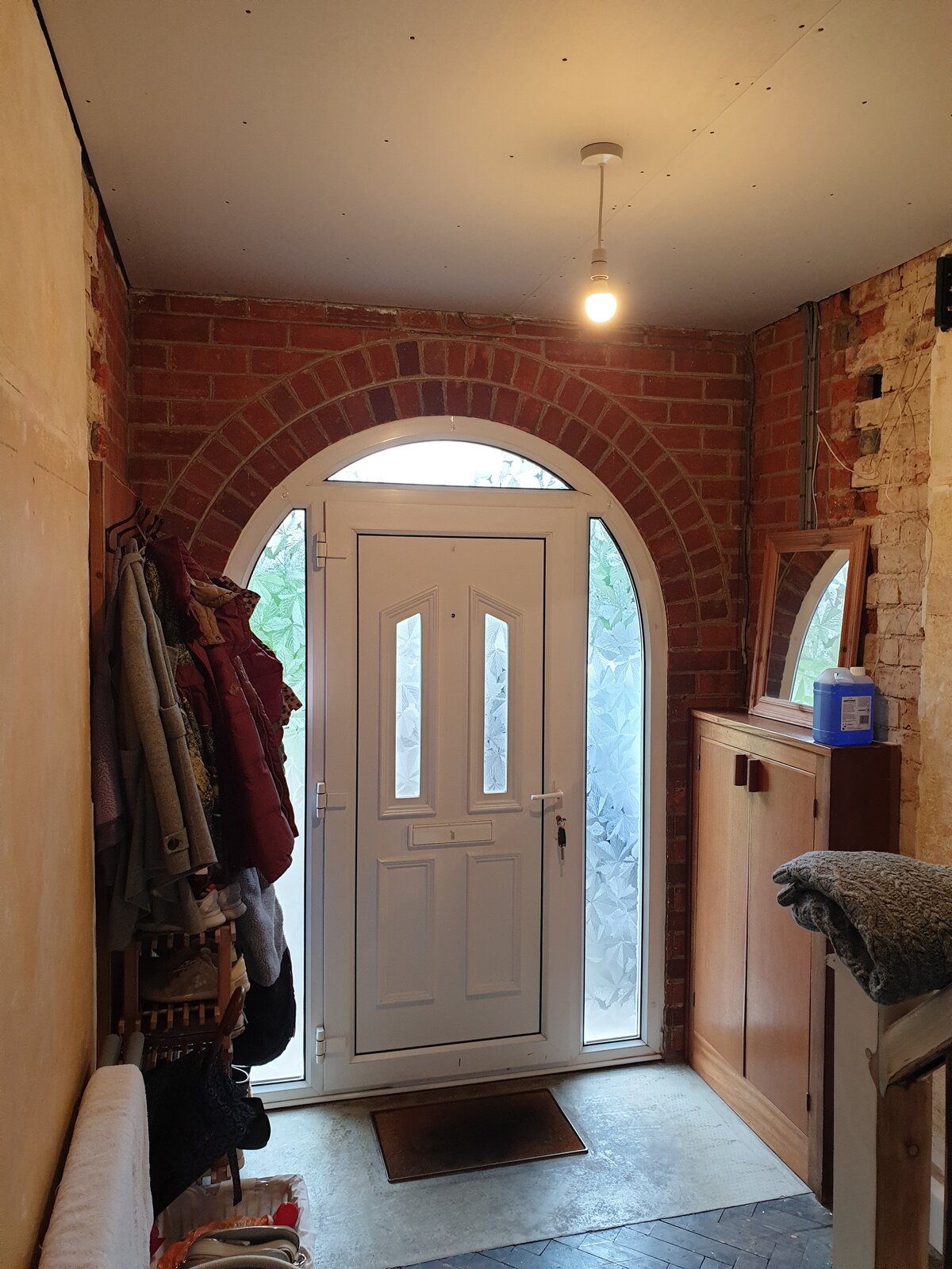

I am in the process of renovating an 1930's property, which comes with lots of quirks. I would like to add some insulation to the wall around the front door, but have a few questions about how best to do this.
Some Background
When the house was originally built, it had an external porch in front of the front door, with a lovely arch as the opening. The front door, and wall, was set back from this arch approx 1.5m. At somestage in the properties history, a past owner has removed the old front door/wall, and moved the front door to within the archway. The exposed brick of the old external porch was simply boarded over with. This boarding has been removed now, and you can see in the pictures below the current state (and also how the old wall position used to be).
We are having a new front door fitted (old one still shown), along with renovating the whole house. As nice as the old imperial brick is to look at, it is not great for heat retention. So I would like to add some insulation to this 'front' wall internally, either side and above of the door.
The Questions
1) My original plan was to create a stud frame on the brickwork, and infill with 50mm PIR board. This could then be plasterboarded over ready for plastering.
I am now wondering whether it is best to just add insulated plasterboard to the wall instead?
2) With the above in mind, do I need to apply a breather membrane under the stud wall/PIR or insulated plasterboard? If yes, any recommendations on what product to use here?

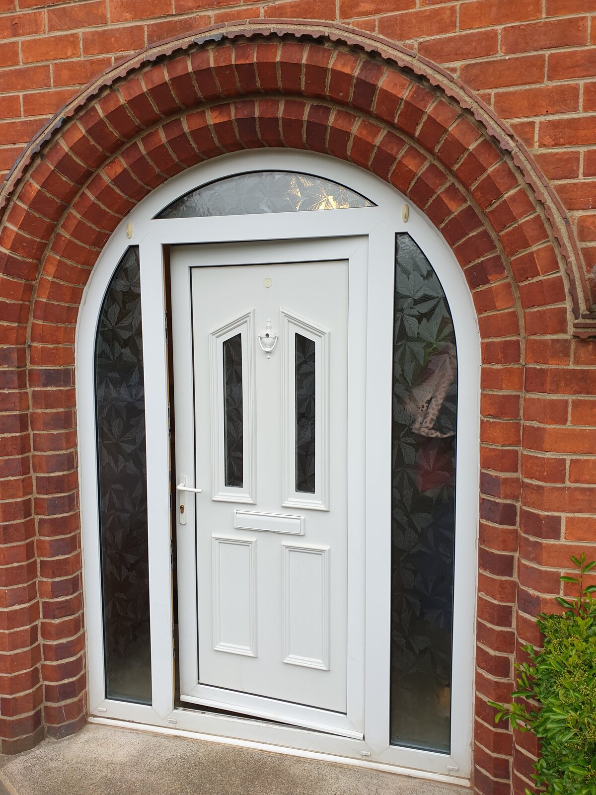

For reference, most walls have been cavity filled with bead by a previous owner. I am unsure on this small section of wall. It is cavity for most of it, but as you can see from the second picture, the external detailing (which is lovely) reduces to single brick depth at the very edge of the arch.
3) If yes to the breather membrane, how should it overlap, or not, onto the ceiling (already plasterboarded) and floor (concrete)
Thanks in advance for any help you may be able to provide.

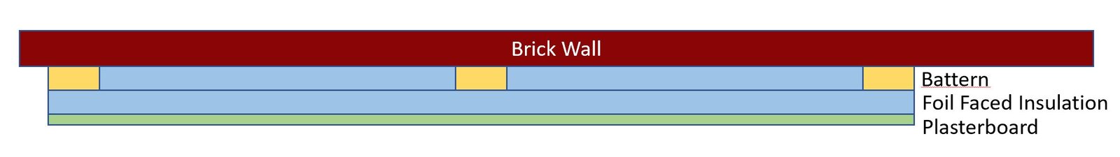

Just to be clear then, your proposing batens down first on the wall (to create a small cavity to the back of the PIR), then the foil faced insulation, then the plasterboard on top?
I have done some further reading and many suggest a membrane between the wall and the batterns. Any preference on the type of membrane for this?
No cavity, no membrane.
50x25 battens, 25mm PIR between, 25mm over the face.

So, as per below?
Out of interest why do you suggest no membrane, or cavity? Not questioning your opinion, just wanting to learn :D
Given the wall goes to solid at the very edge of the arch, would this be an issue?
Voids and cold surfaces in a wall construction create a risk of interstitial condensation.
