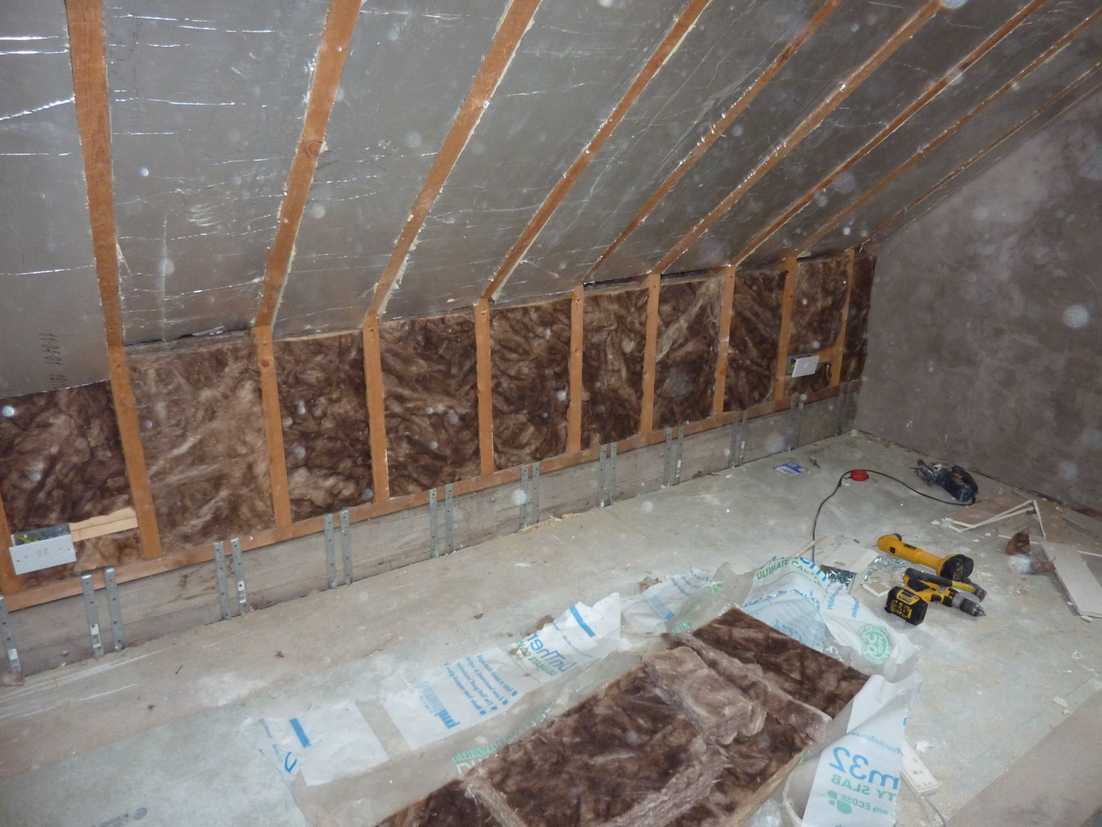

When I did my loft conversion some years ago the designer specified dritherm 32 cavity batts for the dwarf wall. They are a high performance batt and quite solid so they would stand up/stack tight behind your wall with little securing. B&Q have these on sale at the moment at a bargain price (I think they're clearing out the 75mm thickness as it's a difficult size for modern buildings) - you won't get more bang for your bucks - I've just bought a load for my extension as I'm using a 75mm cavity.
Thanks, certainly looks like a cost effective route. I guess my only question is about air tightness - will they be effective just stood behind the studs, or would I be better going for some kind of board which can be physically fixed/sealed?

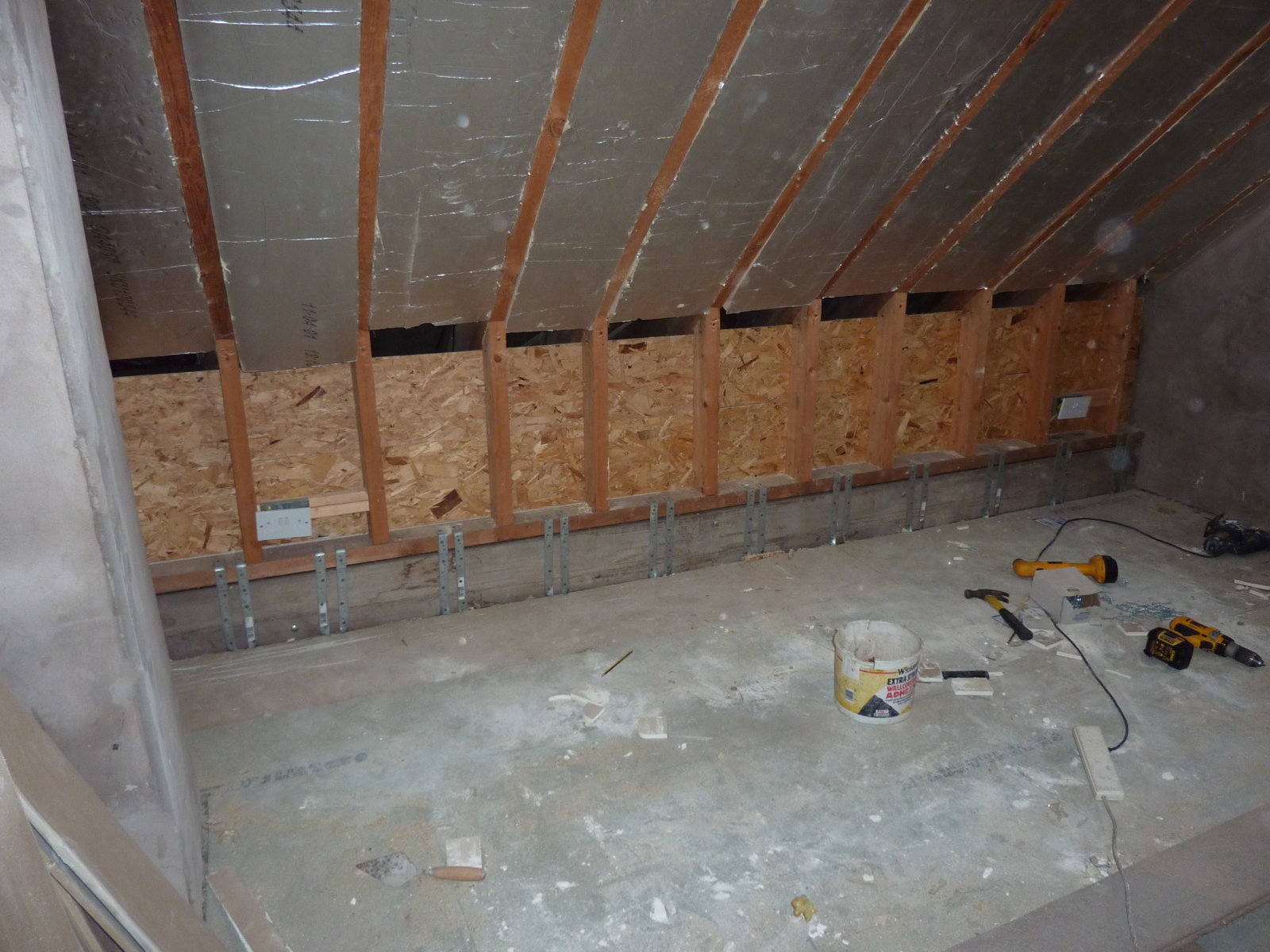

I've actually found some old pictures of mine:
Looks like 9mm OSB at the back, no pictures of the front but probably foil backed plasterboard. With hindsight there is clearly a potential issue with cold bridging where the timber studs are so I'd probably put some strips (or sheets depending on my budget) of 25mm celotex on the front of the studs to prevent this - if you completely covered with celotex and taped the joints you wouldn't need foiled plasterboard.
Hi cdbe
thanks for adding the images as it has clarified my concern with vapour barrier, so better to use OSB ok that seems a better solution.
Regarding the cold bridging on the vertical studding, I had not considered that, is that really an issue to address ?
Maybe I should read up on cold bridging !
thanks again
Cold bridging should not be an issue , You can add insulation or insulated plasterboard to front .
