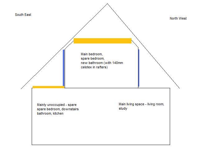

We live in a chalet style dormer house, and therefore the first floor rooms are cut into the eaves. We also have a loft, which I've fully insulated.
The first floor rooms are rather cold though in this freezing weather, and the heating (in the dormer window) in the main bedroom isn't particularly effective at heating the room. I think I need to better insulate the eaves, as they are probably larger than the attic space in total.
The stud / plasterboard walls of the rooms are insulated with a thin layer of polystyrene, however the eaves floor / ground floor ceiling isn't particularly well insulated - in some places none, in other places maybe 150mm of rockwool. I can't actually get to the floor easily at all in some areas as its been boarded over.
The rafters aren't insulated at all (they are felted), although some areas have a thin layer of fibreboard pinned to the rafters. We've had a new bathroom installed upstairs, and the rafters in this room have been insulated with 140mm celotex to comply with building regs (although I don't actually think the walls have been insualted with anything... I don't remember the chippie having enough to do the walls as well as the rafters).
I was thinking it would be more cost effective (and easier) to insulate the rafters in the eaves, rather than both the floor and wall. However I believe Celotex isn't cheap.... Granted I'm not looking to do it to building regs standards yet, but we don't have much (any) money left after all the other work we've had done.

This is a drawing of what I'm working with.... I'm hoping this might prompt some responses! :D
As I mentioned, the loft has been fully insulated, with the 100-200mm that was there originally, and 200mm space blanket on top laid at right angles. There is apparently sufficient ventilation in the loft as there is no condensation, although I did note certainly 1 gap running down the rafter line behind the angled plasterboard in the upstairs bedrooms into the first floor eaves - I'm sure there are others too. There was a warm draft blowing up through this gap, which does make me wonder whether my insulation is compromised...?
Within the eaves rooms / eaves themselves, most (but not all) of the room walls have about 20mm polystyrene backing, and between 100mm and 200mm of rockwool insulation on the floor, but only on the south side of the house. The north eaves are boarded and used for storage, but have no insulation (beyond vermiculite) under the flooring. Typically, these have the main living areas of the house below!
In the boarded eaves, I feel I have no choice but to use celotex, polystyrene or some kind of board insulation in the rafters (leaving a 50mm gap) however as its so much more expensive than space blanket / wool, I haven't discounted using wool (unless I get advice to the contrary). That would mean I don't need to lift the floorboarding to insulate under. However should I block the air gaps into the loft where they exist? The gap was perhaps 10cm wide? Should I try to shove insulation up or down this gap on the wall side?
In the unboarded eaves, how would you look to best - and most importantly cost efficiently - insulate? bolster the insulation on the floor and walls, start the walls from scratch, or add in between the rafters?

Celotex and the like are much more expensive because they are much better insulators ie you only need say 120mm Celotex compared with 300mm of Rockwool or the blanket stuff as you put it. Rockwool is not really practical to be used vertically in a wall so that leaves little choice. Whether you add all the insulation at rafter level and none in the walls is up to you although you're then effectively heating the void between the dwarf walls and the roof. Look around and online for more competitive prices for Celotex or Kingspan or similar, the shed's and many merchants will have silly prices for the stuff.

The problem is that there is some storage in the eaves on the north side of the house, and in fact the boiler is in there too, so even if I did insulate the floor and wall, I'd still be heating the eaves from the heat of the boiler. Hence not having much choice about insulating the roof rather than walls and floor. I suspect I'll have no choice but to use Celotex here.
Perhaps a little bit further into the eaves I could consider insulating the walls and floor and blocking off access, although as its boarded (if unused) I'd have to insulate over the boarding.
I did insulate one wall in the eaves on the south side of the house with rockwool and secure it in place with board. I'm assuming this is still going to be fairly effective - certainly more than the thin layer of polystyrene that was there (25mm)? The intention was to do the same with some of the other walls in the eaves on this side of the house, where there is no storage and I have already insulated the floor.
The only other problem is accessing a section of the eaves that is completely blocked off - I may have to take a wall down, but given how cold it is, and how much colder the room below it is than the other rooms on the ground floor, I can't see I have any choice!
PU has an R value of 4.0 per 100 mm
Fibre-wool has an R value of 2.5 per 100 mm
so 120 mm Celotex = 200 mm fibre-wool ( approx) at time of installation.
I have nailed/stapled fibre-wool roll in the vertical in order to save money ( which is the main point of insulation) and don't see why there is any problem with this.

MW, I have never checked or contacted Rockwool to do a U value check for using Rockwoll in a vertical situation, it’s a bit of a bodge and have never seen it done or specified it on a drawing and have never had a client nor builder ask for Rockwool to be used in such a situation. It’s not really designed to be used in such a situation, that’s why you’ll not find that construction method referred to on the Rockwool website and why they’d inevitably raise an eyebrow if you ever contacted them for such a U value check and as a professional I should not be specifying something for which it is not designed. It’s a typical DIY’ers solution! If used vertically Rockwool is designed to be supported on both sides within a cavity or partition or as a vertical fire break where it’s suspended at the top and clamped at the bottom. If I had a client who asked that Rockwool be used in such a situation I would duly contact Rockwool to seek clarification.
I over-specify insulation in everything I do and in anycase the minimum compliant U value they must achieve is always stated too, I do not consider skimping on a few mm of insulation to be economical. That way when the builder does a shoddy job elsewhere or changes stuff and swaps 50mm of Kingspan for 50mm or rubbish he’s picked up cheap from his mate down the merchants or just wants to change the construction or whatever I’m in the clear and transfer responsibility to the builder for compliance. On 99% of my domestic jobs clients or builders have no further need of my services hence why responsibility must be transferred to the builder.
