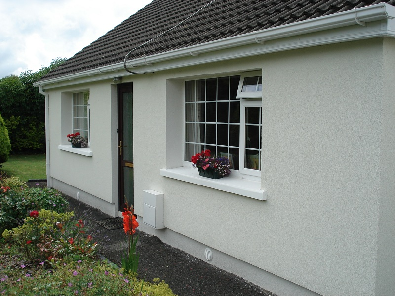

What does that external wall insulation look like?. I wouldn't want anything that looks "out of place" from the street.
How does it 'terminate' around window and door apertured?
I've seen it done on a few houses round here.
I guess you can't really tell, unless you knew what was there first.
Windows seem a bit far back into the wall. Deep window cills.
Soil and waste pipes need moving. Roof overhang looks a bit small, extended soffits. Gutters need moving
Random pic from web shows kinda what I mean
Might be worth doing but looks like a lot of work and curious how it would look for a single house in a terrace. Would only consider it if ROI is well within 10years though as planning on moving house around that time, unless substantial increase in house value. No point if I'm just breaking even in that time.
Is it maintenance free once done?
Maintenance free- yes, don't know what the design life is but decades definitely.
Be surprised if you get payback inside 10 years without grant aid- budget £100/sq m for EWI as a baseline, that number is about 4 years old so very likely it has increased significantly.
