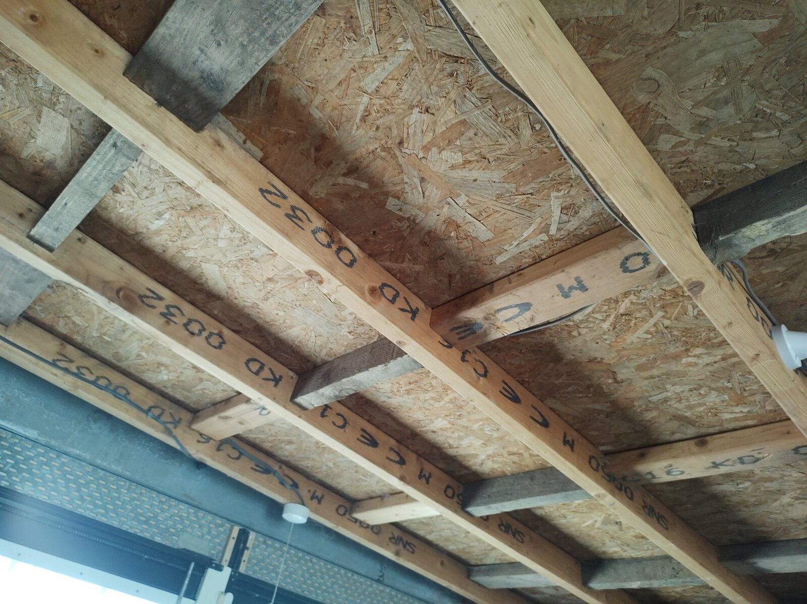

My garage roof is EPDM on 9mm OSB decking, I'm 17 stone and the bowing when I walk on it is ridiculous - I reckon if I stood on one heel I'd go straight through it, certainly if I did a little jig, but I don't and I haven't - I dream of a 12mm ply deck, but the OSB cost me about £20.

No it's not. It's probably a slight exaggeration to make a point (the reality is that I'm fully aware of the risk, and osb, even at 9mm will give loads of warning before it fails, the space between the rafters is barely 400mm and I couldn't fit through even if I tried).
The point is, that 12mm plywood is perfectly safe to use as loft flooring for access and storage, it's not a domestic floor and it makes no difference if it deflects a bit, it's beyond me why people drag 18 or 22mm chipboard up there, usually overloading their already overloaded ceiling joists.
