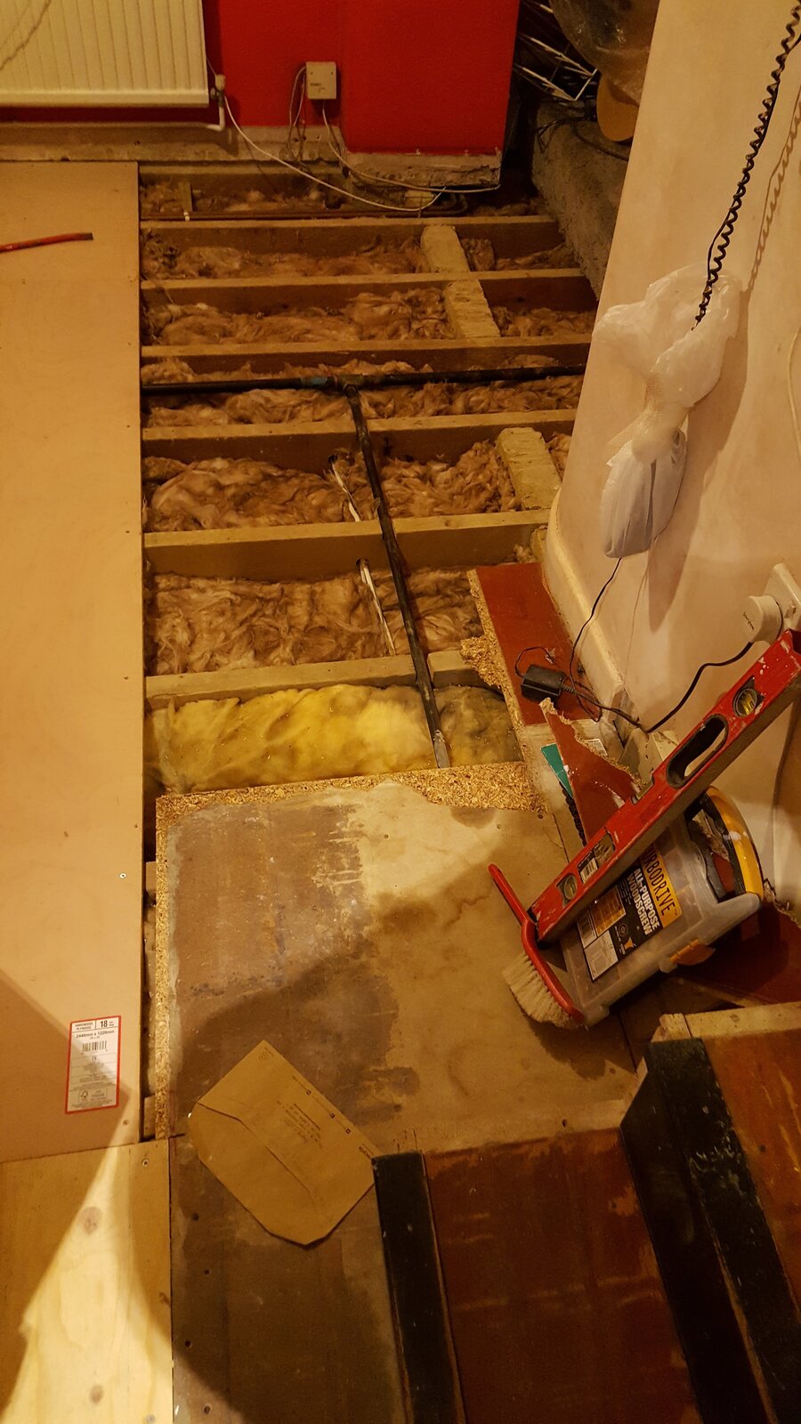

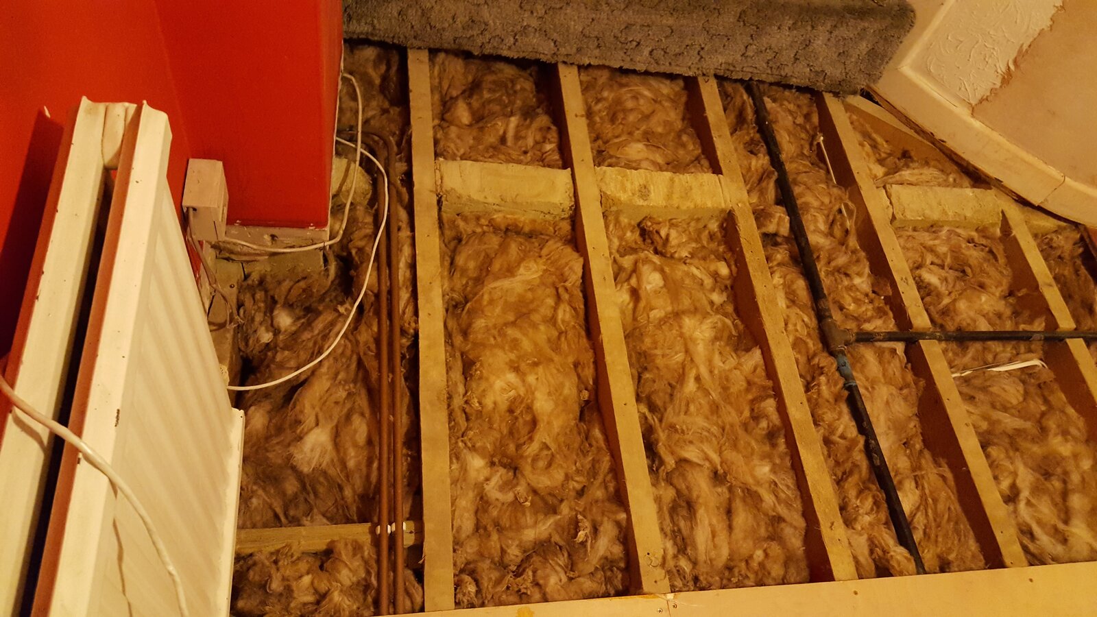

Here's one I did earlier.
Do any wiring for sockets, lights, LAN, alarms, phones, cameras etc while you have access.
