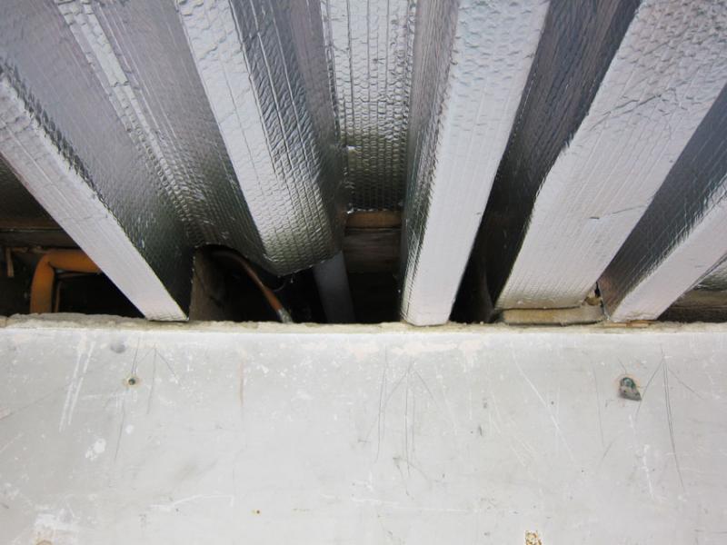

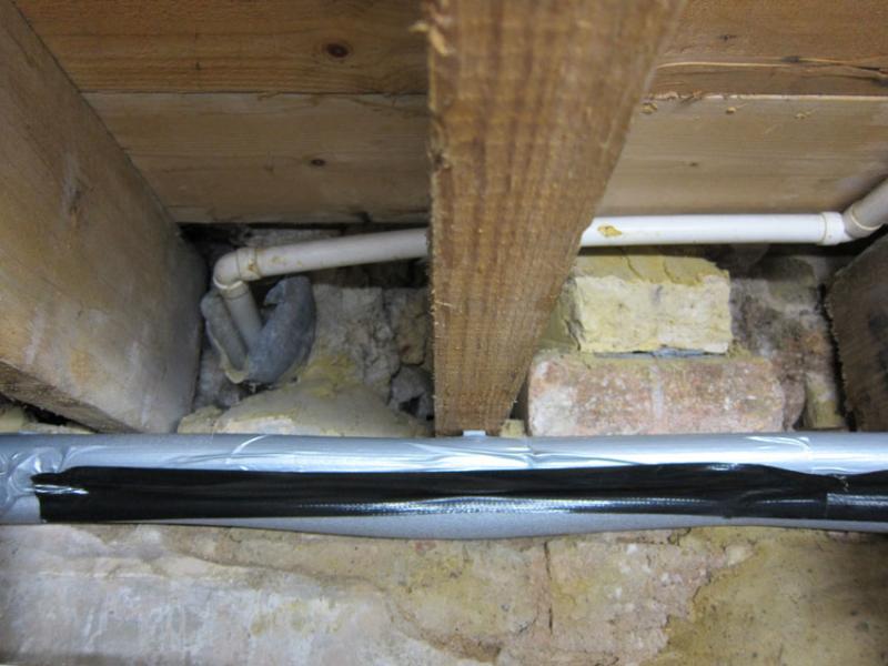

Hi,
I have decided to insulate the underside of our floor within our ground floor flat. It's COLD! Luckily there is a cellar beneath so I can get access to the whole area. It is a Victorian house.
I have decided to start by stapling a layer of silver foil (bubble wrap) as a (cheap version) airtight breather membrane. I will then add a layer of cheap rockwool to increase the U-value.
I know it is important to tape the joins so will be doing this, however what happens at the edges where the foil meets the brick work? Should I lap the foil up or down or what?
Also how do you deal with all the fiddly bits. For example, there are brick sleeper walls, so it is difficult to get a clear run when using the foil. Do I just cut and patch it round all the obstructions? Presumeably the sleeper walls are a form of thermal bridge to the underside of the floor, not that I am that worried - any insulation will be an improvement to none! Before I filled the gaps from above (prior to sanding) you could see the light when it came on the cellar! :eek: :eek:

Hi
Yes, the rigid board would be quicker and easier to fit, I am just using rockwool because there are so many pipes, and other bits and bobs to get around. Hardly any of the rafters are regular.
Alex
Hi,
Has anyone any ideas where to stop the insulation? Do I tape it up to the floor, or across and against the brickwork?
You have got things wrong. The same fabric cannot be air-tight and breathable . In any case no membrane required in this situation.

From the research I have done I can see that I have used the foil in the wrong way and will be heading out to buy some rockwool. The foil should not touch the boards, as stated the principle is to trap air by pinning it to the underside of the joists.
I still don't know, however, if the cheap silver foil bubble wrap is or isn't breathable - I think it probably is not, otherwise they'd advertise it on the packaging.

I also think that most people on this site would tell you that it is wrong to completely enclose the floor-joists as shown by the first site.
The material itself is not breathable, some such products were/are used as "breather" membranes, the idea was that the reflective properties help with the insulation value, and that the sheets would be installed so that the top and sides were stapled, but not the bottom, the bubbles would then create a mini cavity behind the membrane that vapour could work out of, It sounded a bit dubious to me when I heard it.
