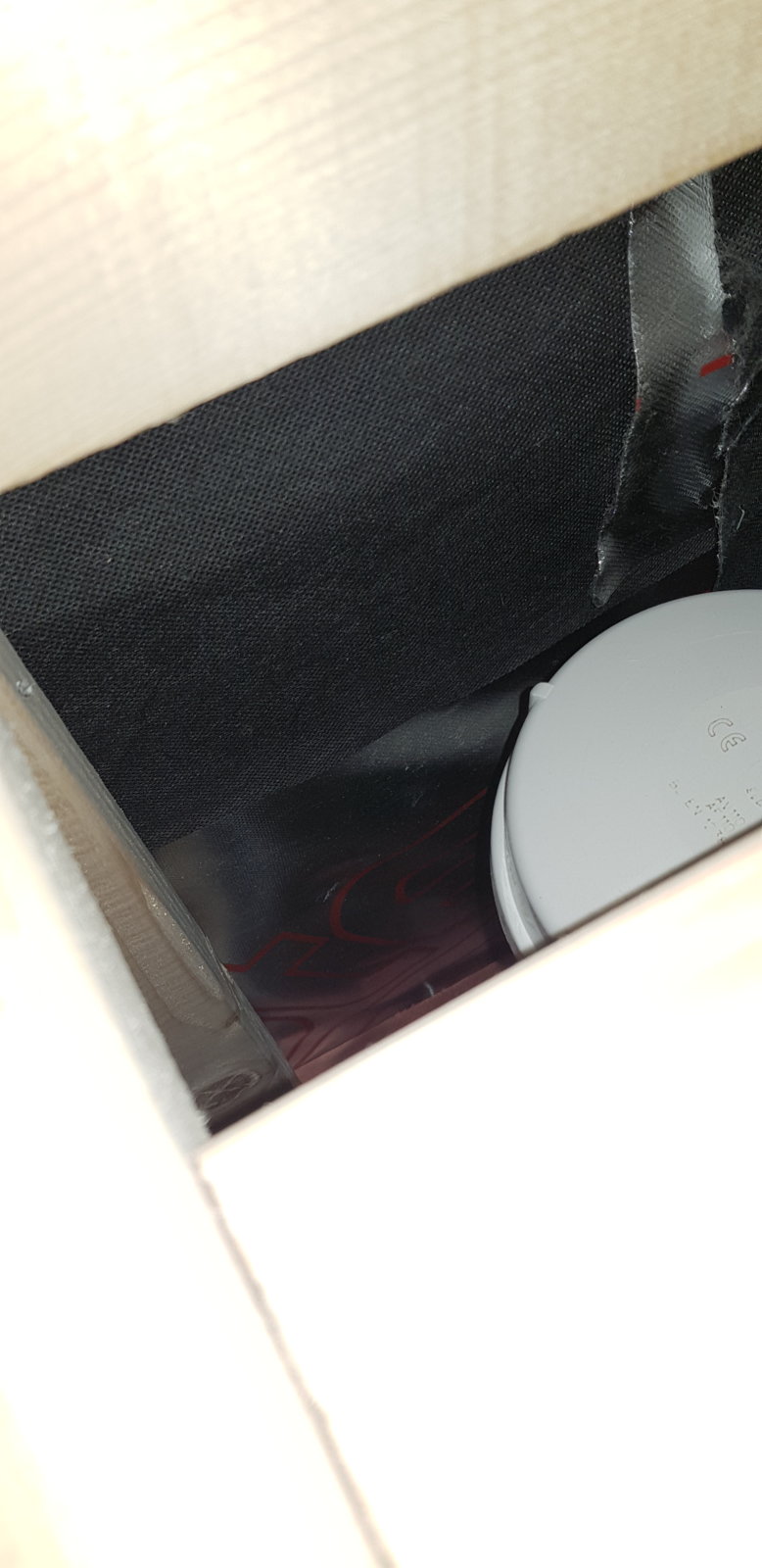

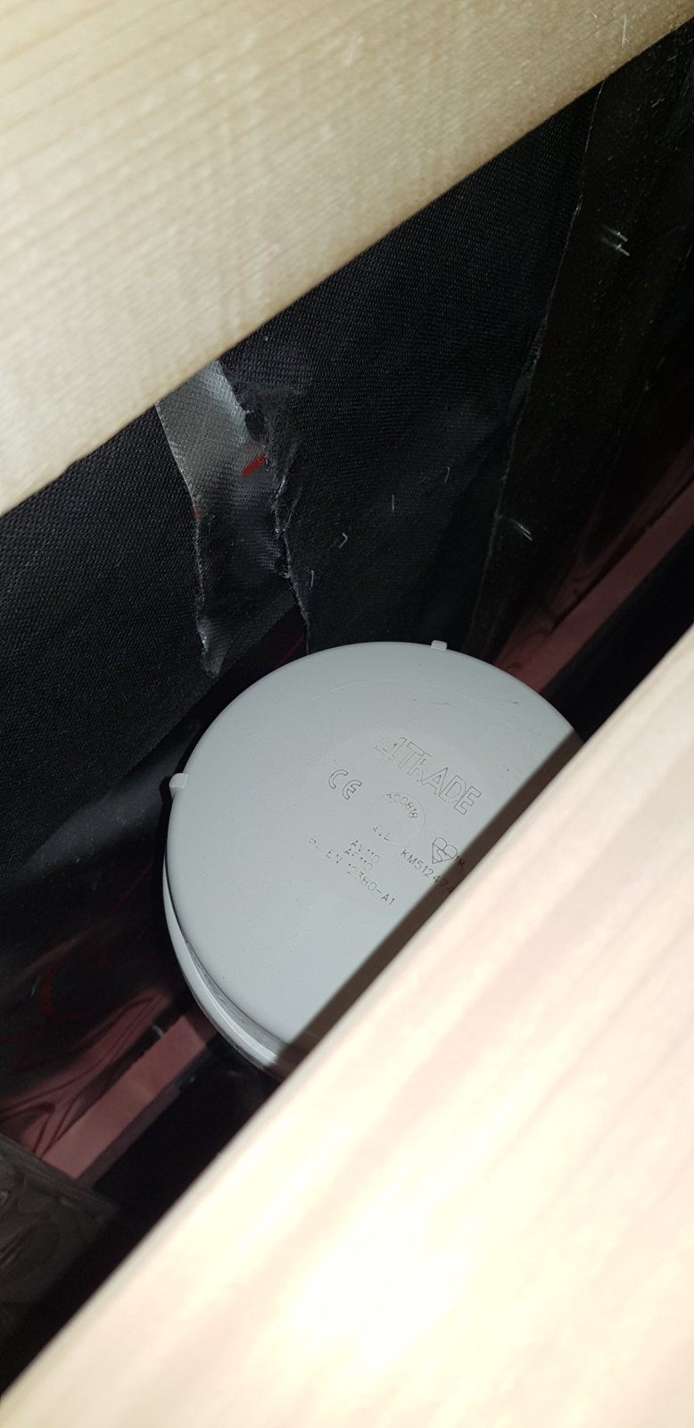

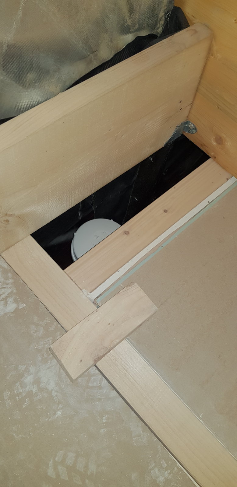

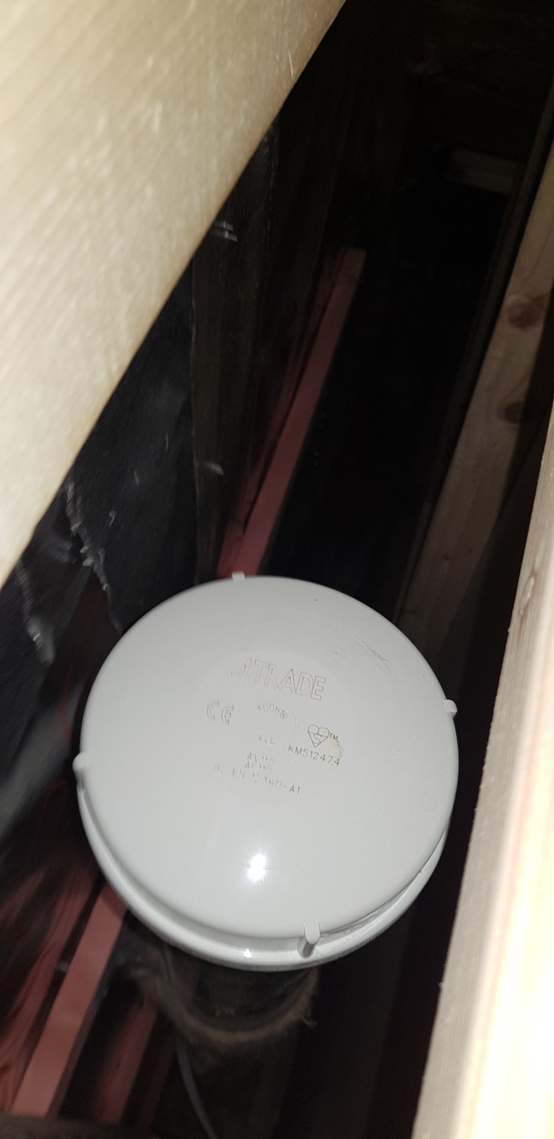

These are some pictures of a hole on the floor I spotted today whilst insulating the loft. Is this normal and can you spot anything from the materials seen on the pictures?

You wouldn't normally have a warm roof construction except for a room in the roof or sloping ceilings on the first floor. As others say you are heating up all that loft space for no reason. An advantage is your loft space is already insulated if you want to convert it or use it for storage. You should be able to find the insulation specification if it was built in May this year. Do you know if it is a timber framed house?
Thank you for your responses. As far as I know yes it is a timber framed house. The outer structure is brick and masonry and interior is timber and plaster board.
I just want to know how to find out if they have put the right amount of insulation and if it's done to a good standard. Apologies if I'm not being clear as I'm not an expert on this topic.
Ask the builder for the specification used and ask who did the building control on the house and if it has an NHBC warranty.
Most modern houses have minimal amounts of concrete or brick on the inside, so there is little thernal mass, either to heat up, or conversely to act as a thermal store.
- that is the case with timber framed houses, less thermal mass to act as a thermal store.
That's the feature/problem with timber frames. They heat up and cool down quickly, and you won't alter that fact, however much fact checking and "should be" analysis you do.
Whilst you should have at least 280mm quilt in the loft which you could check, the wall insulation could be one of several standards and you will never be able to check for air leakage, which is the most significant escape route for heat.
You may be better off checking that the heating emitters are correctly sized for the room areas and are used/ programmed correctly to keep the rooms warm.
