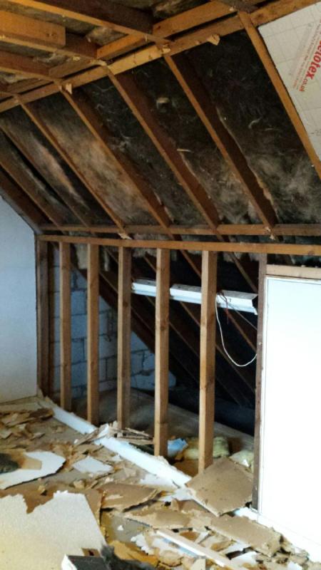

Hello all
I'm replacing rockwool insulation with celotex GA4000 and intend to insulate between the rafters (ceiling to bottom) and also under the rafters. My question is, where the cross member is running along the rafters, whats the best way to insulate around this? I intend to use the dwarf walls as cupboard space. Do i just butt it up against the wood and fill gaps with foam or do i remove the wood and put it back afters the plaster board is fitted?
regards
Shaun
I wouldn;t remove those wooden stuts as they are proping part of your roof up.
Try to get smaller pieces of plasterbaord in-between them.
