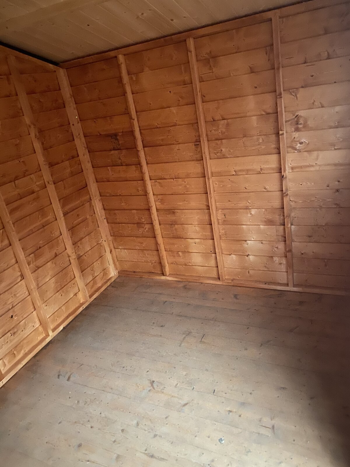

Hi all,
I’ve been reading the posts to get some help and advice but some of it is going over me head. If I give a bit of back story and then explain what I’m thinking of doing, would you let me know if this is ok, correct or something I shouldn’t do and advise another way.
I am new to this DIY stuff and have watched countless videos on how to do this so I apologise if I don’t understand the Jargon or write the wrong words lol.
We are getting a new 9x7 shed as my daughter (20yo) wanted somewhere she can have a base for her nail business (not to run from the shed) somewhere she can practise and have somewhere to go when her friends come over, rather than 4 of them all sitting on the edge of her bed. So I’ll have some plug sockets put in and some lights, (by a qualified electrician) I wouldn’t even attempt that but lol.
Im going to be doing a concrete base for the shed to sit on (the shed company have said to build the concrete 3” smaller than the shed) so the rain can run off and not bounce back up, and to not have it pooling at the base. So i’m going to do that.
regarding insulating the shed.
I was going to have it like this.
Shed wall/ceiling
Fill in between battens with Mineral Wool (no air gap between wall and insulation)
Then cover with 500 polythene membrain and staple to battens and seal any gaps
Then plasterboard on top?
does this sound ok?
also a question I wanted to ask about plasterbaording.
I’ve watched loads of videos and they all say to leave the gap and the bottom so it doesn’t get wet from any spillages. Which I understand, but what I don’t understand is, if we put down underlay and then wooden flooring, that would bring it up to near enough the plasterboard? Should I be putting an skirting board around all of the bottom of the shed before we put any flooring down? I’m just really confused about that bit.
I’ve attached a picture of the inside of the shed, if that helps?
Any help is much appreciated. Thank you in advance

The detail between the shed walls and the floor is very important when you are using the shed for things other than a shed. Are you having a internal raised floor on top of the slab? If not how are you dealing with penetrating damp or blown rain between the bottom of the frame and bottom edge of the cladding? What about the cold floor and condensation or dampness?
Mineral wool is not that efficient in small thicknesses, so be sure on what your expectations are.
You don't need to membrane a timber shed as an internal vapour barrier, but you should be aware that timber shed cladding will saturate and that will in turn soak any mineral wool insulation.
The plasterboard should be above any solid concrete floor or similar, but does not need to be above any timber floor or floor covering. The gap is for preventing moisture creep from condensation not from spillages. Any gaps will need sealing regardless to stop draughts.

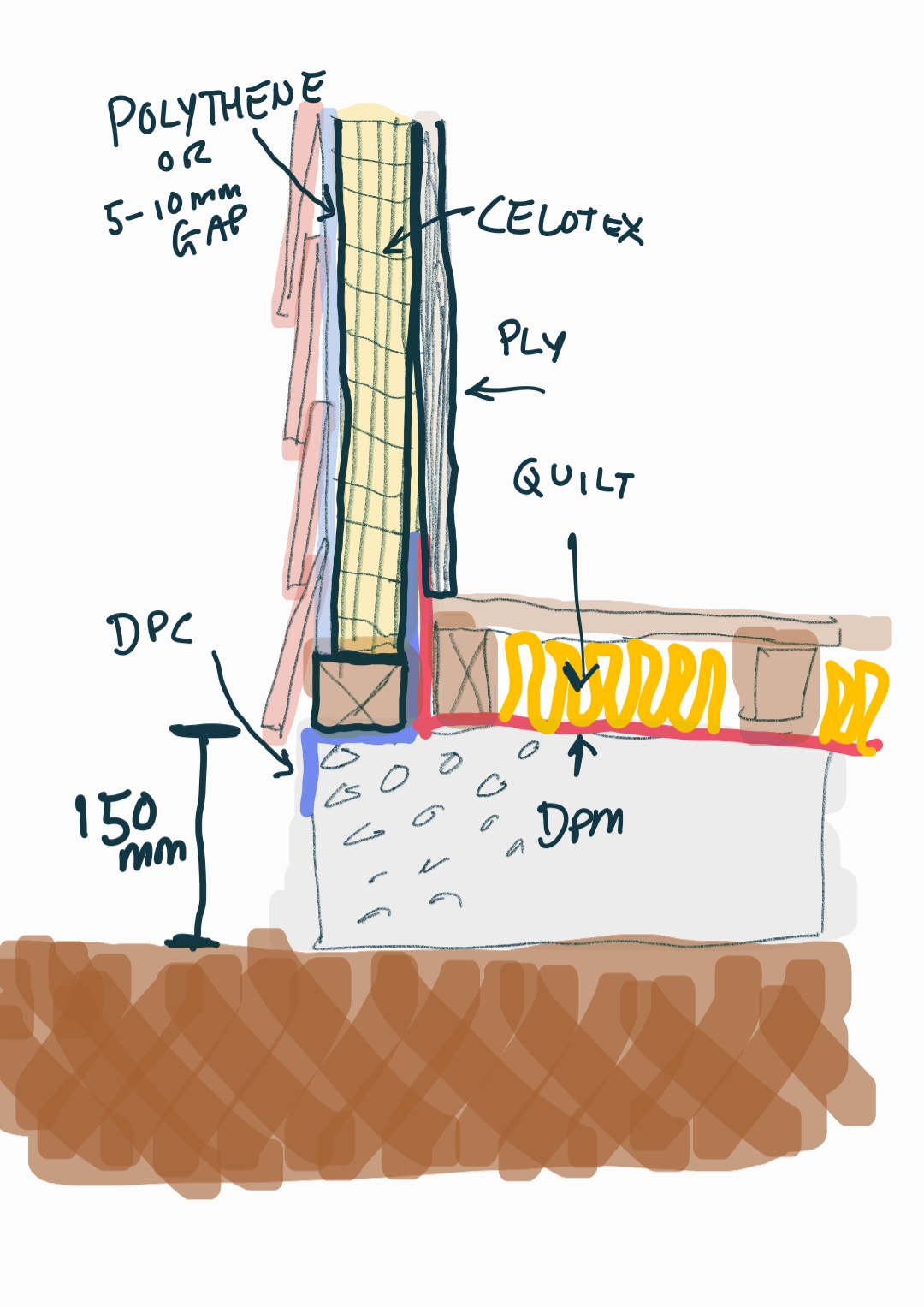

You may not be able to match this exactly but here's a quick sketch to illustrate some principles.
Bottom of walls are high risk for damp ingress and splashes causing timber to rot prematurely. Ideally, timber cladding and frames should be at least 150mm above ground level, and it's best if the frame is built off two courses of bricks. But if the frame must sit on a slab, DPC should be used to keep water out.
If you are buying a pre-made shed panel, fitting a rain barrier behind the cladding may be difficult, so consider a gap instead

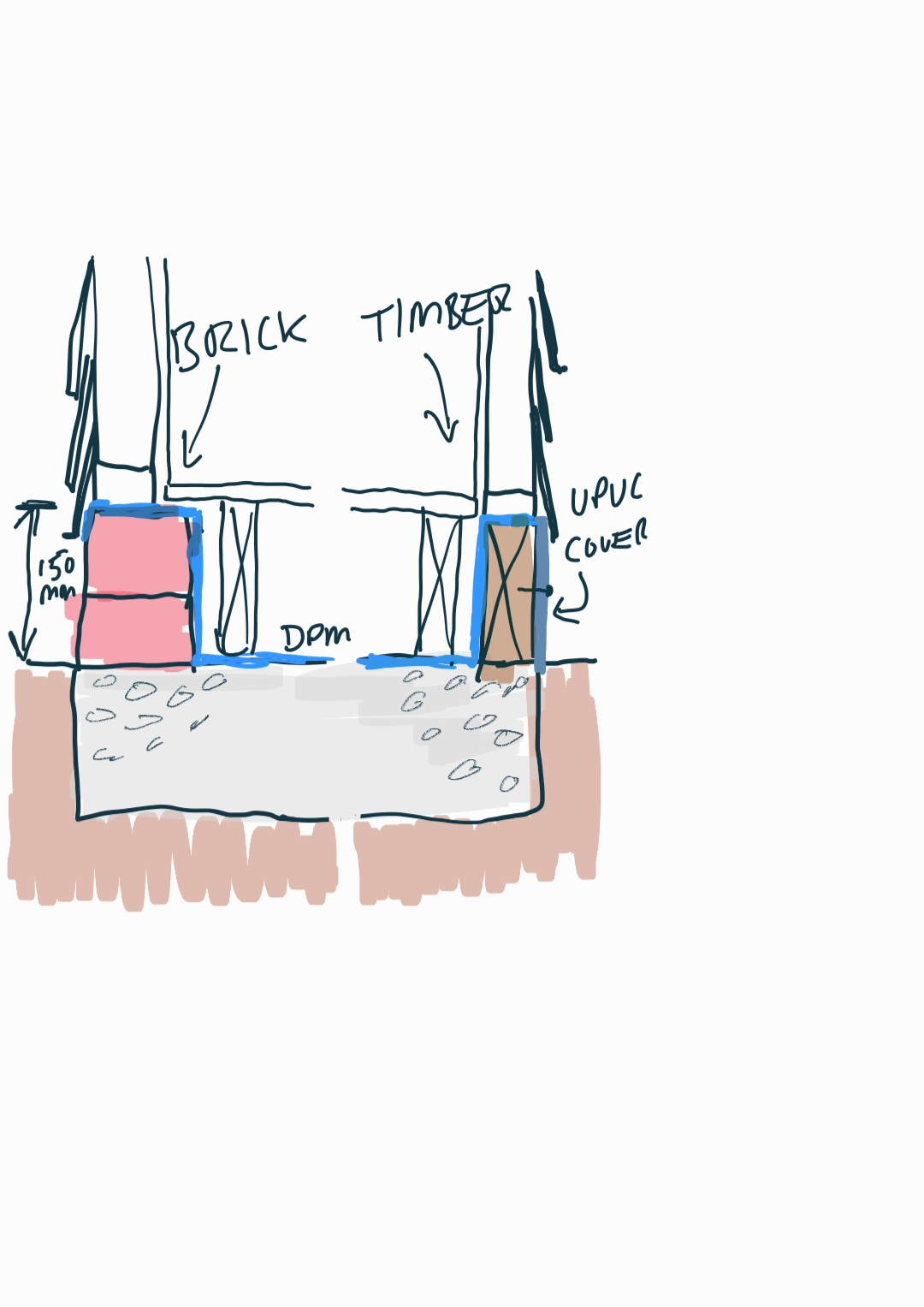

could I cover the back of the cladding inside the shed in the polythene, by staple gunning it to the cladding and then put the celotex?
