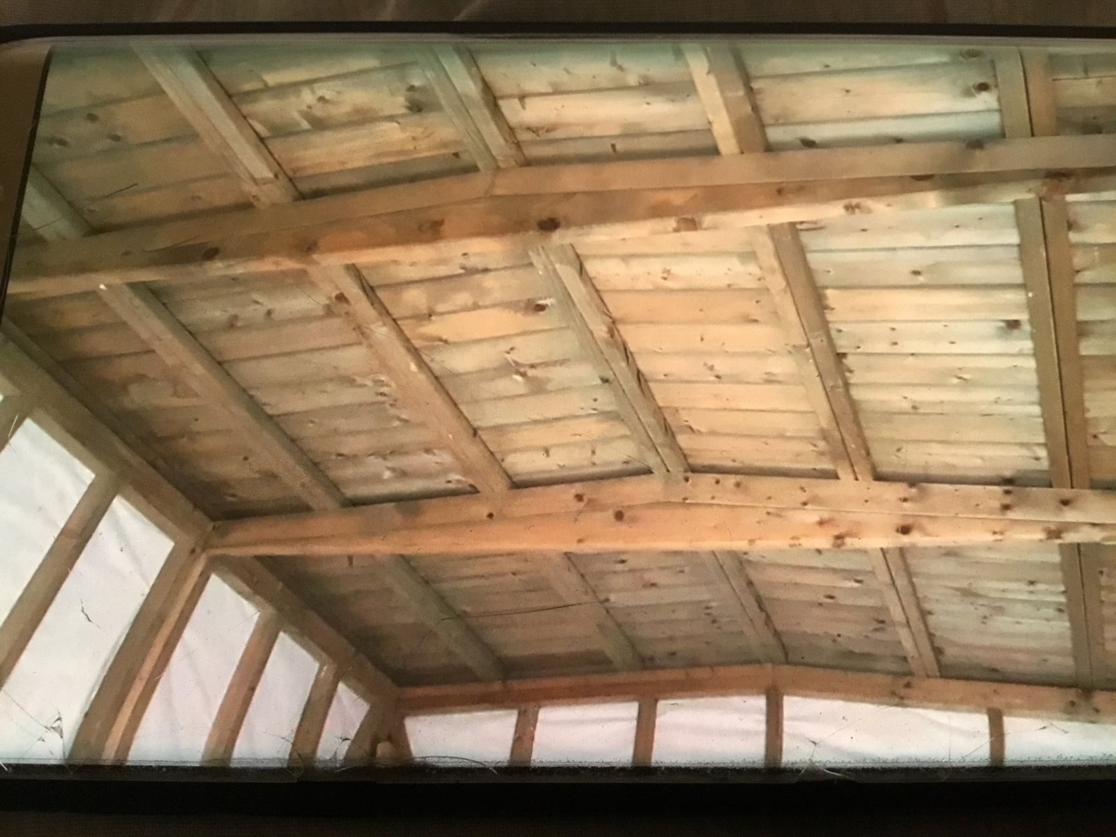

hi,
Sorry if not posted in the correct place. I really need some advice with insulating the roof of my new man cave/ shed. The bespoke building was made by a company and the panels are pieced together. The roof is made up of six 4m panels made of tongue and groove boards and it is a low pitched roof.
The inside rafters (if you can call them that) are only 40-45mm in depth. see photo attached to give an idea.
I have some 40mm PIR board to insulate the roof. My issue is, I have conflicting information. Some people say I should have a decent air gap so any moisture can escape and others say this is not required and just completely fill the 40mm void right up to the cladding? The company I bought the shed from strongly recommend the latter, as then there would be no place for any condensation to build up and they also said a vapour barrier underneath that, then plasterboard/ plywood.
My other option could be to lay horizontal across/under the rafters and fix the boards to the rafters using the large washers and screws. Therefore leaving a 40mm air gap. The building is tall, so not worried about losing head space. However, it’s not like I have eves as in a house for the air flow, so would there be any point?
Lastly, the company added a breathable membrane to all the inside walls against the cladding but nothing to the inside of the roof? So I assume this isn’t required?
I do plan to use the building all year round and have a small heater in there when needed in winter.
Any help would be really appreciated.
Cheers

Neither option is really correct, because you cant create a warm or cold roof.
However since you cant ventilate the void, I would push the insulation up tight, then use 75mm foil tape (I find the diall one from screwfix ok), to tape over each rafter so that you join up with the foil face of each insulation board. The foil acts as a vapour barrier.
If you are plasterboarding use foil backed plasterboard.
The more that you can achieve a complete vapour barrier the less chance of vapour working its way up to the underside of the roof t &g, then condensing.
You can use a vapour control layer, like polythene sheet, but thats a bit awkward where those beams are.

Thanks for the advice, I will push all the way in. A lot more cutting than laying over, but I would rather that than risk moisture buildup.
I already have the foil tape , so I will fill any cracks with expanding foam and also the foil tape.

You would need fascia vents to the outside in between every pair of rafters -not really practical.
There are 2 ways to cut the insulation: measure very carefully, including any tapering and cut to exact size, but cut with a small angle so the insulation goes in easily bit is snug o the face you can see inside the room.
Or cut about 5mm smaller all round. Cut some little bits of wood say 100mm x 50mm with a 5mm hole in the middle -use the to hold the insulation tight.
Then fill every gap with foam. Buy a metal screw on foam gun and have it set so the foam comes out slowly -set too fast it will blow back and wont go in the hole. You will fail if you try using the plastic tube type foam cans.
Using the foam al, round is the best way -it really locks the insulation in tight. But you need a good 5mm gap for the foam to go in deep enough.

Sorry one last question. Could I use this as a Vapour barrier and tape all the joints? As is would also add a little more insulation too and then plasterboard on top? There maybe I wouldn't need the foil back plasterboard either?
https://www.toolstation.com/ybs-general-purpose-thermawrap-insulation/p16779
Cheers
Taping all joints acts as a full vapour barrier, but I like to fit foil backed plasterboard as an extra belt n braces. Thermawrap used as a vapour barrier would work fine.
Im not sure if it add any useful extra level of insulation without air gsps either side (assuming it works like a superquilt). But its not expensive so is worth doing.
