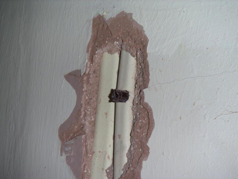

i love most of my job, but what i hate is capping. my role as a sparky is to design an installation and i get proper enjoyment out of meeting clients stipulations. but when an arsehole who turns up from the insurance compnay turns up and ask why "i have not sheathed the cables". i responeded with"they are already sheathed". He said, "no, I want that covering on all the cable chases, that metal covering". I asked why he wanted it? he responded with the comment, "we would not want anyone to put a nail through it!!!". i asked him to watched me nail some capping on with a nice s-wing hammer. Answer was " but they might drill through it. I asked him why plastic cable chases were available.. He answered " we all all need to look after the environment. I said "plasterers expect cables to be below the surface so that they can do their job without damaging their tools" Answer from the man in a suit was "its easier to to drill through plastic than metal capping.

I have looked at and talked about 522.6.8 many times. Unless you use Ali-tube cable then the capping would need to be earthed. Although (v) would possibly remove the need to earth capping. However the problem is with metal capping a nail or the like which connects the capping to a live wire will not necessary cause any protective device to open unless the capping is earthed so it could through un-earthed capping transfer the danger to another area.
Nails and the like through the centre of twin and earth is always a danger. The problem is they can when they go in connect both sides of the severed earth but over time the earth is lost. The same applies to some extent when the live neutral wire is caught. To me either plastic capping for poor plasters or no capping or earth the metal capping.

Not many people have metal capping, and I've never seen it earthed. How would you earth it? A piece of 4 mm earth wire to a crimped lug?
Even then it wouldn't be fully compliant as the connection would not be accesible for inspection and testing.
Capping is pointless. Oval conduit is good if you want to provide some covering to the cables.
