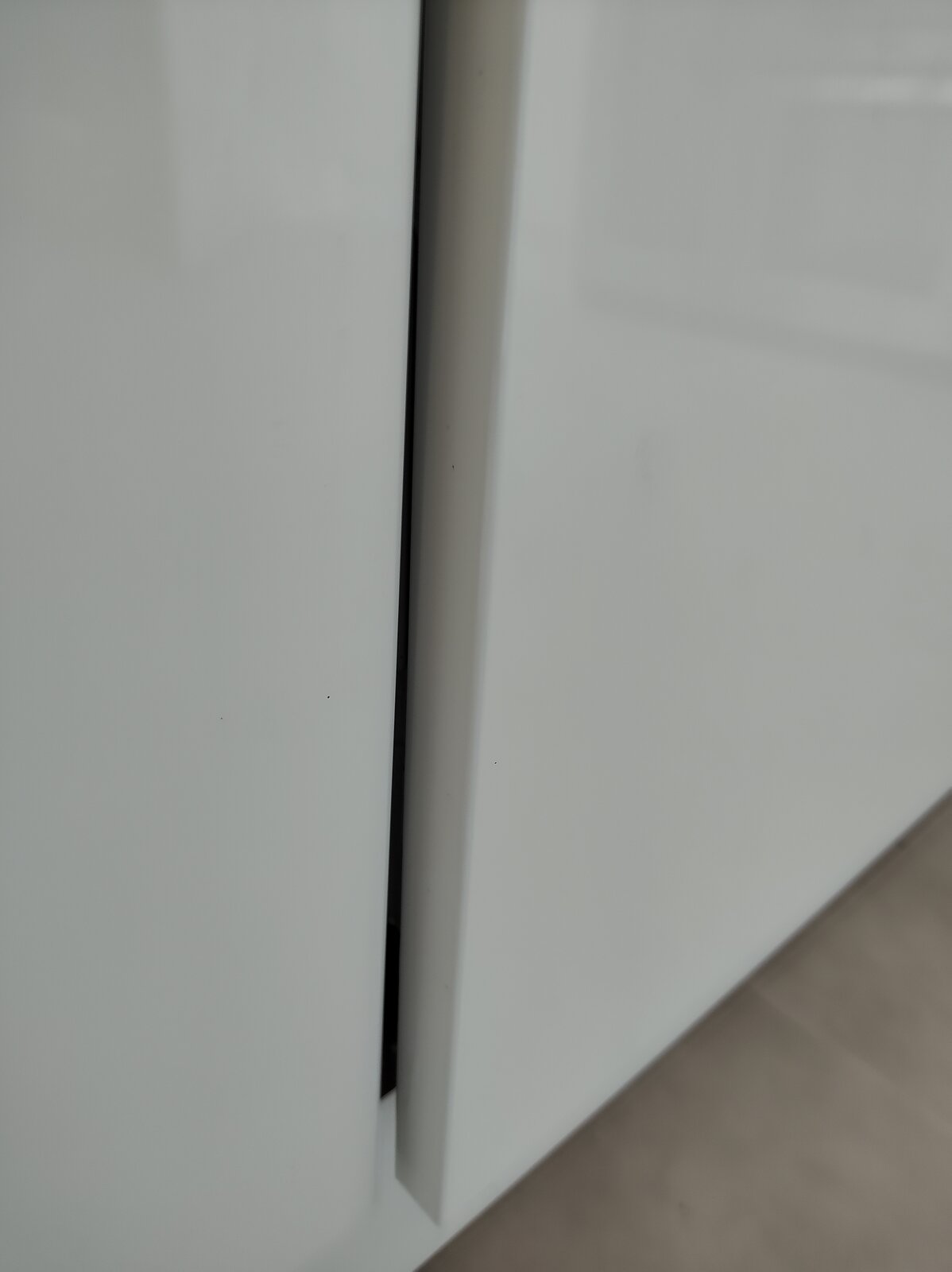

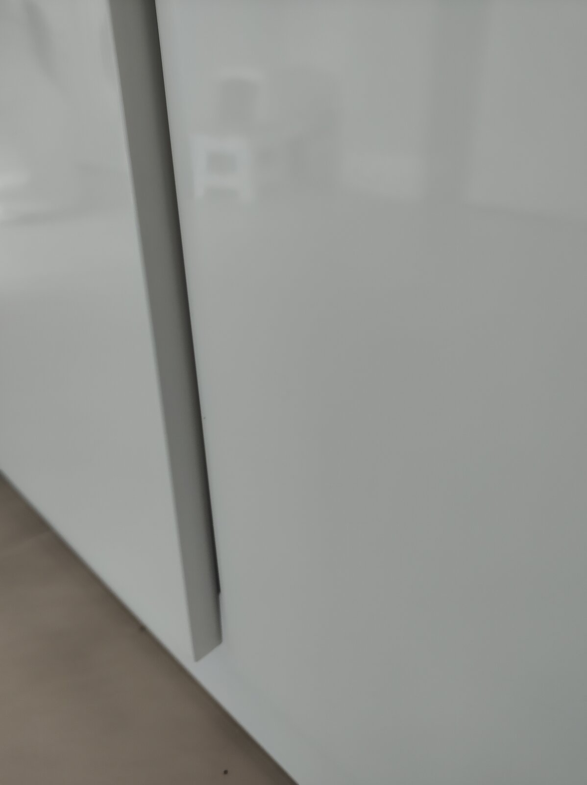

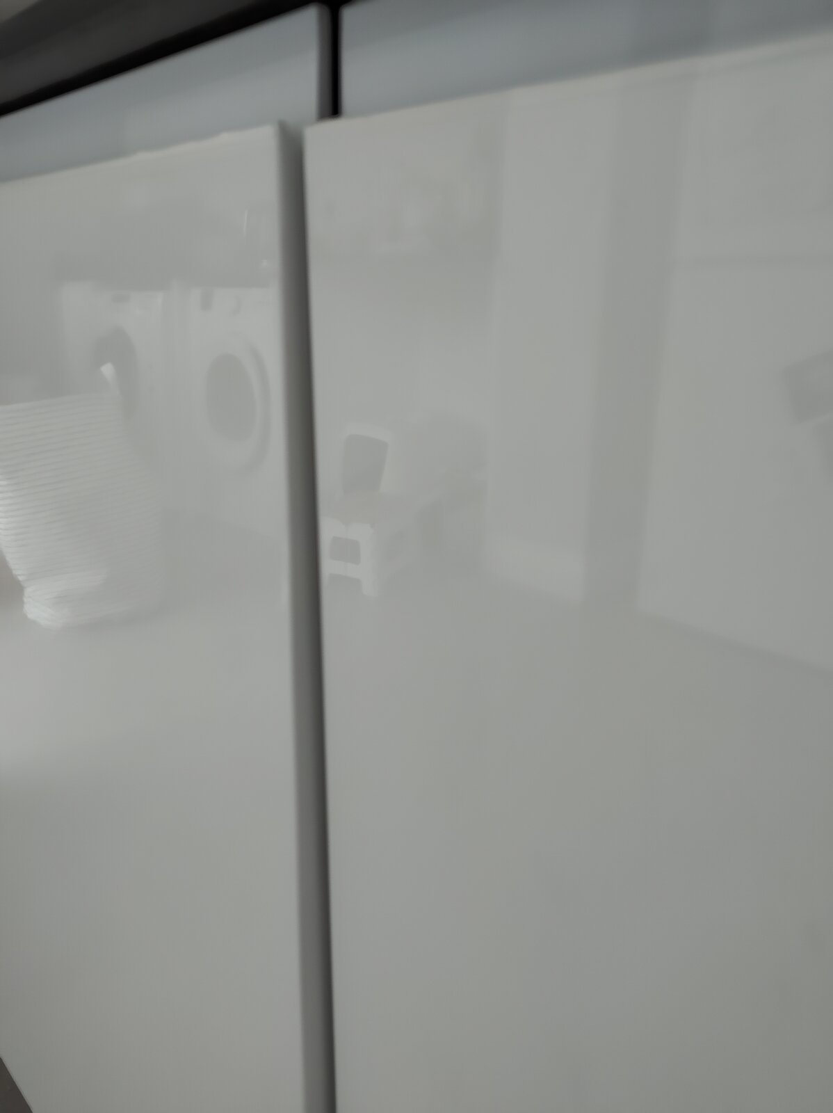

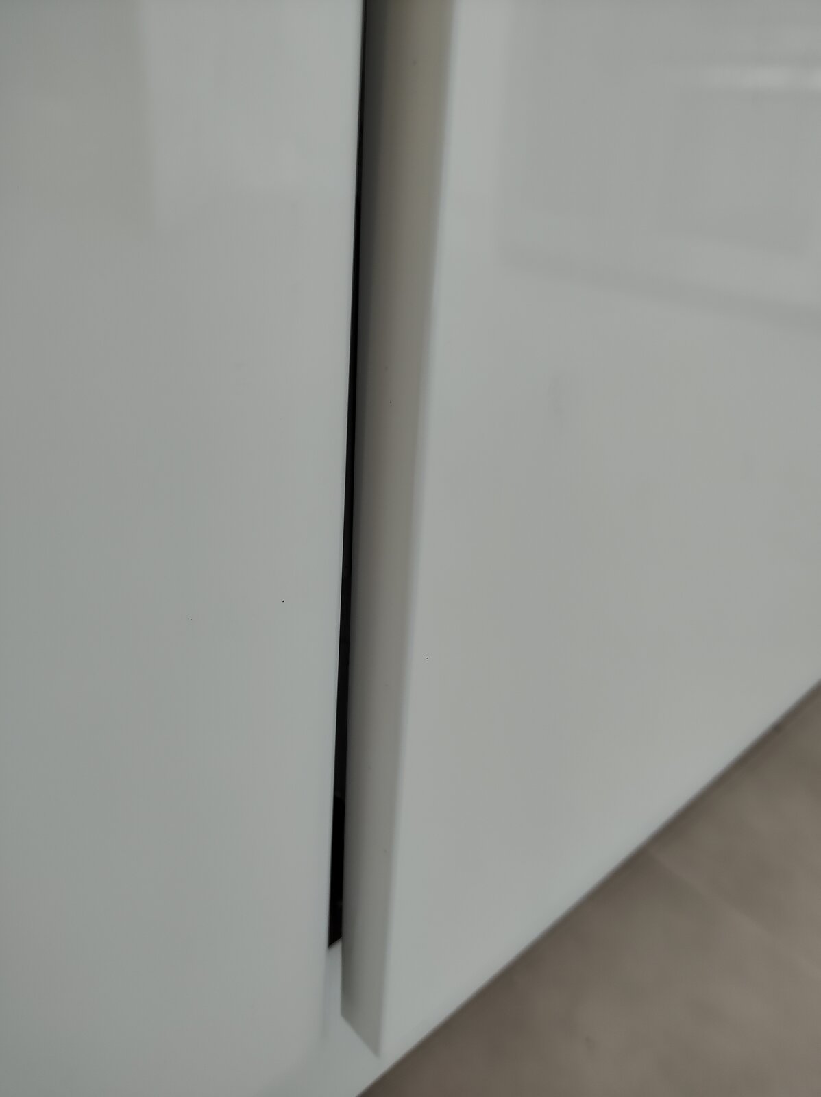

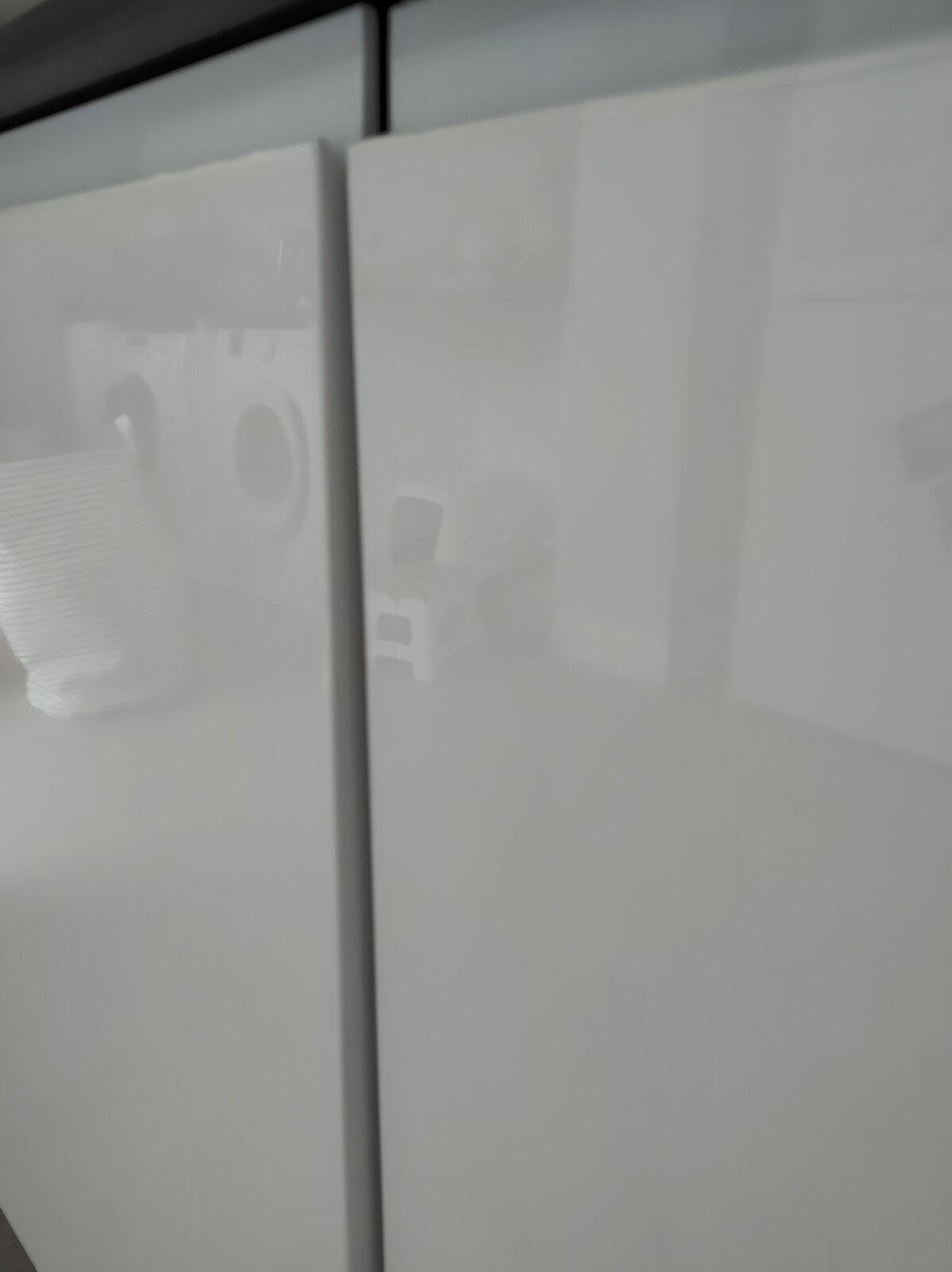

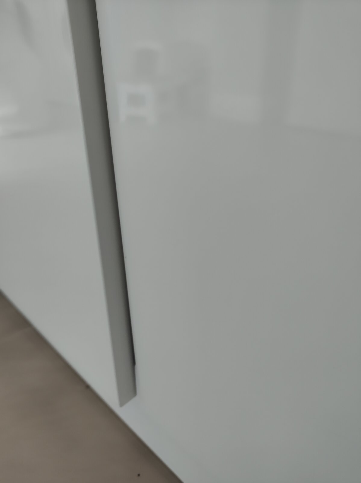

Hi there. We had a Wickes fitted in Jan 2022 & everything was fine. Now, for some reason, the dishwasher panel door is no longer flush at the bottom. The machine still works but there is a massive gap at the bottom of the door. Wickes seem very reluctant to deal with this and the original fitter has not been back in touch to my email. Any help/suggestions gratefully received. I've included some photos.

Looks like it may have come off the support bracket.

Photo is poor but looks like the dw has moved forward , happens when the top has not been secured to the worktop which allows the machine to walk forward with repeated opening and closing of the door .
