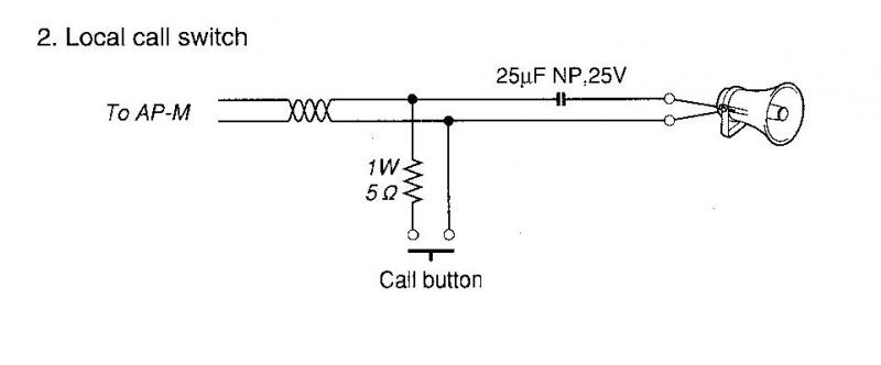

It might be more than you wanted to spend, but this seller on ebay has an Aiphone high power intercom master station. here
For substations you can use any 8 ohm speaker that will take the power, and wire them up with a push button and capacitor like this:
Installation manual is here.. 1 x twisted pair to each substation.
