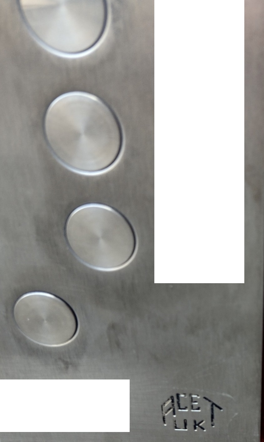

The intercom is not working for anyone in our block of flats
Everything worked fine yesterday. However, visitors cannot ring the external buzzer to alert the flat owner of there presence.
They cannot be buzzed in and you cannot communicate on the intercom.
I believe that the fault lies externally of the flat
Can anyone advise on what to do/look for?

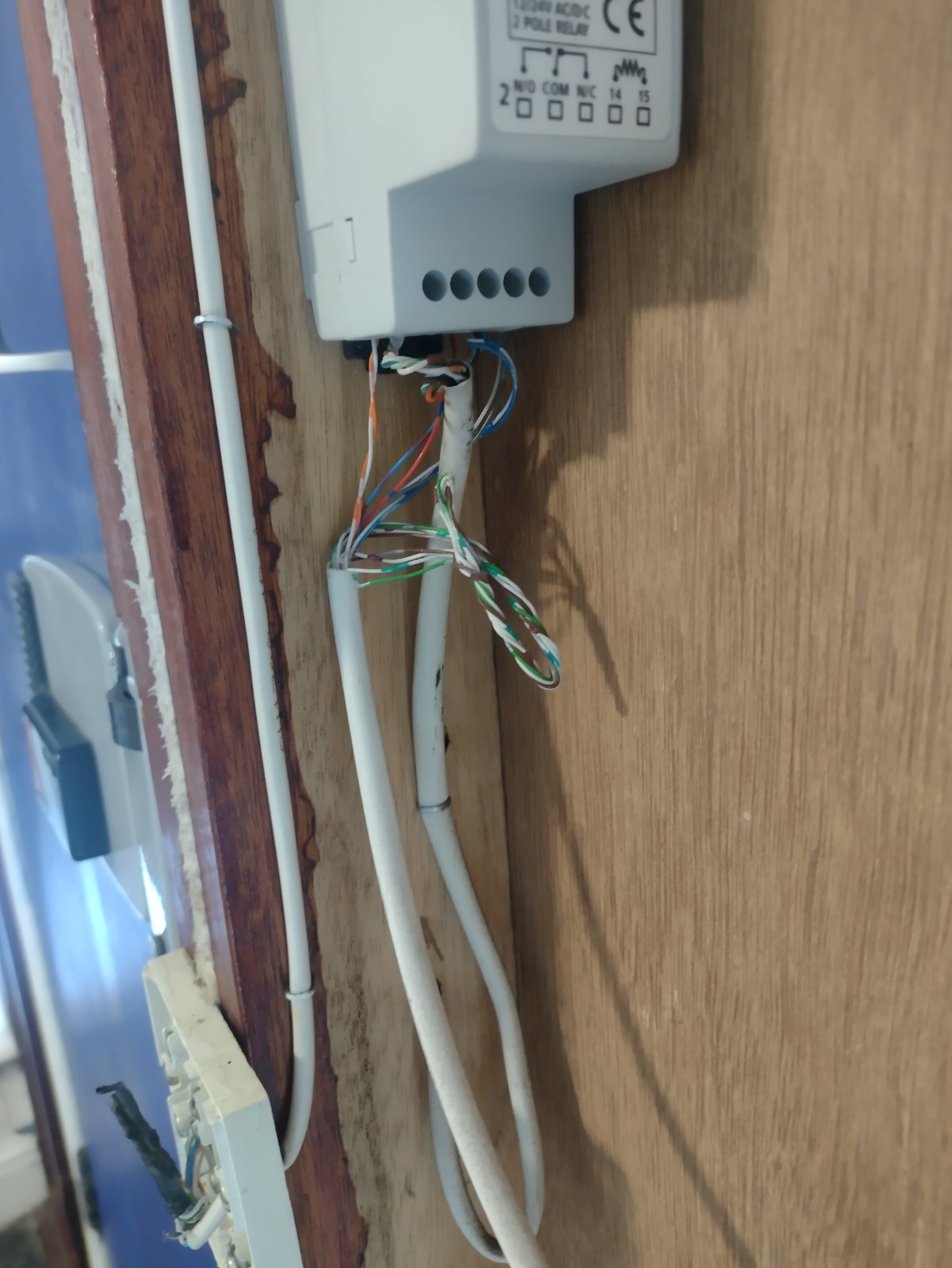

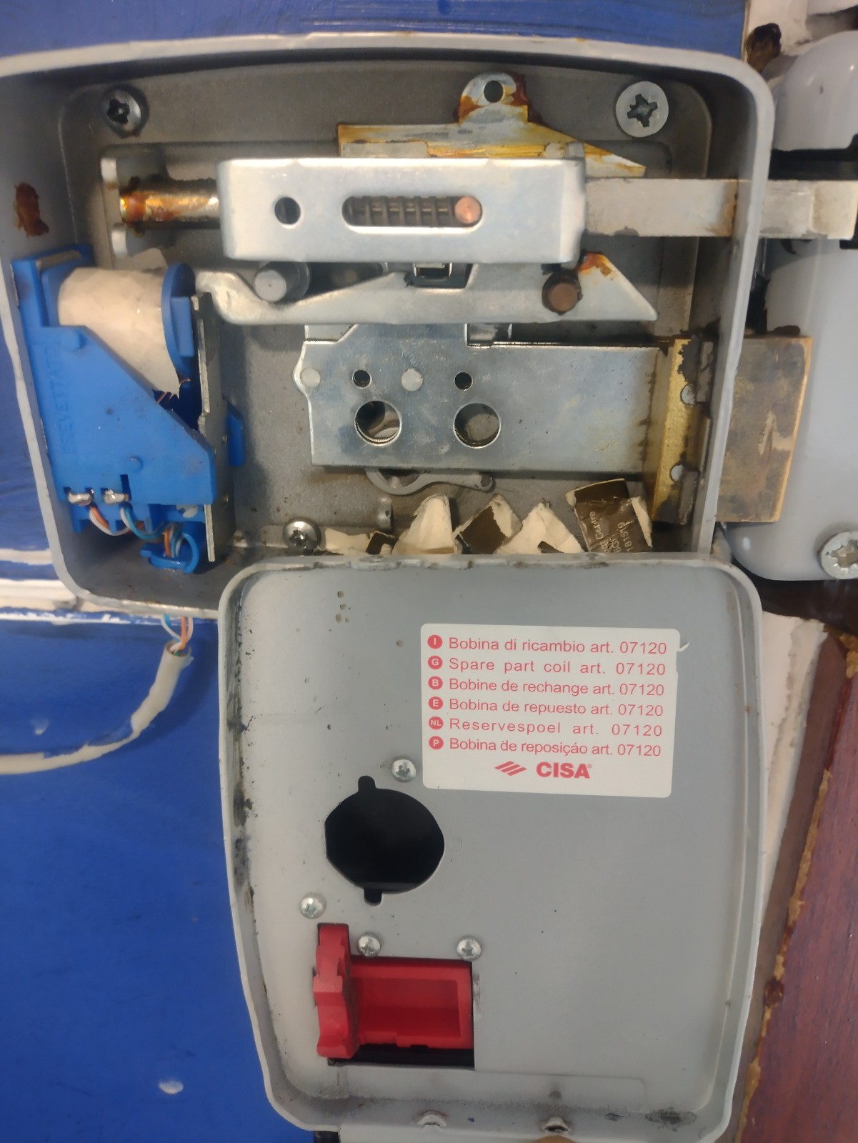

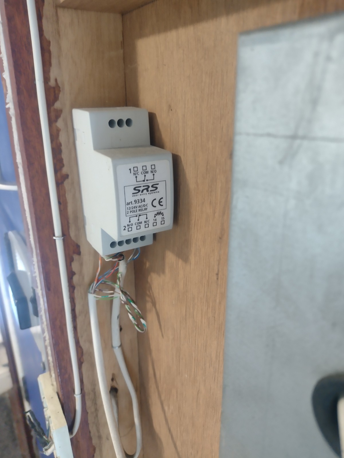

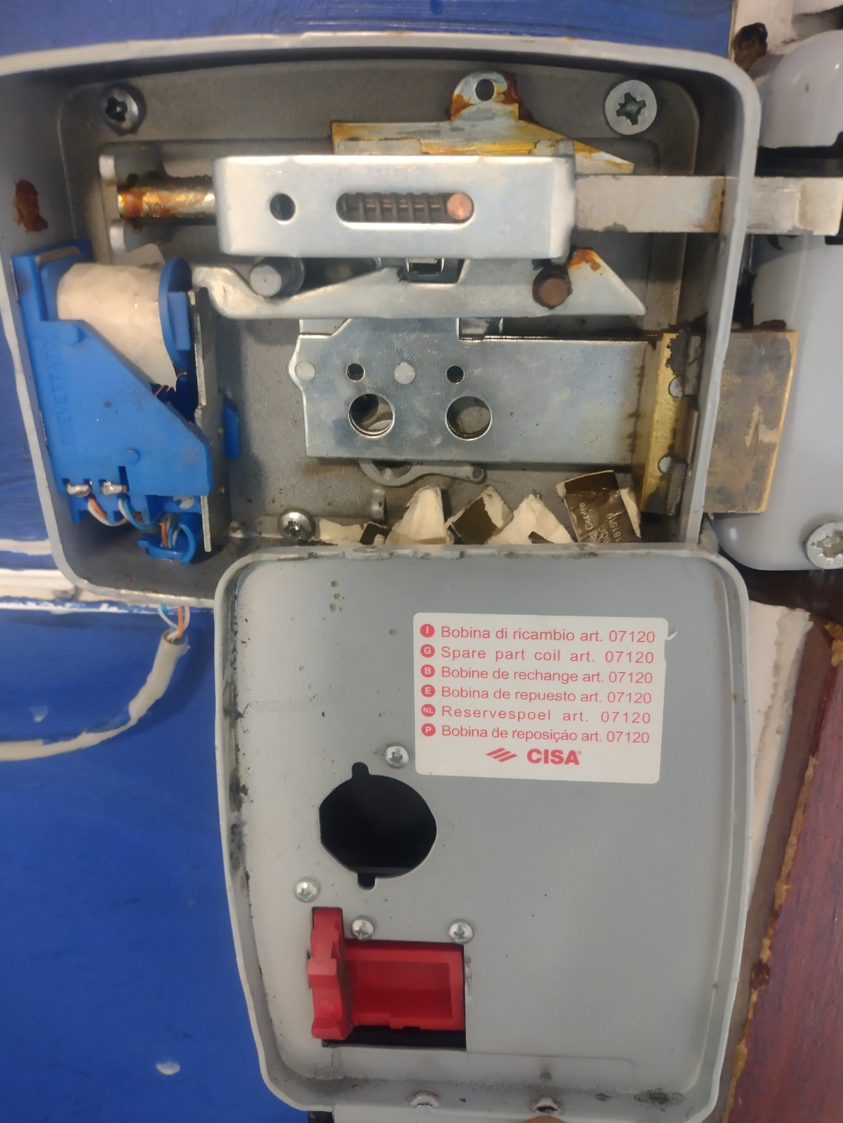

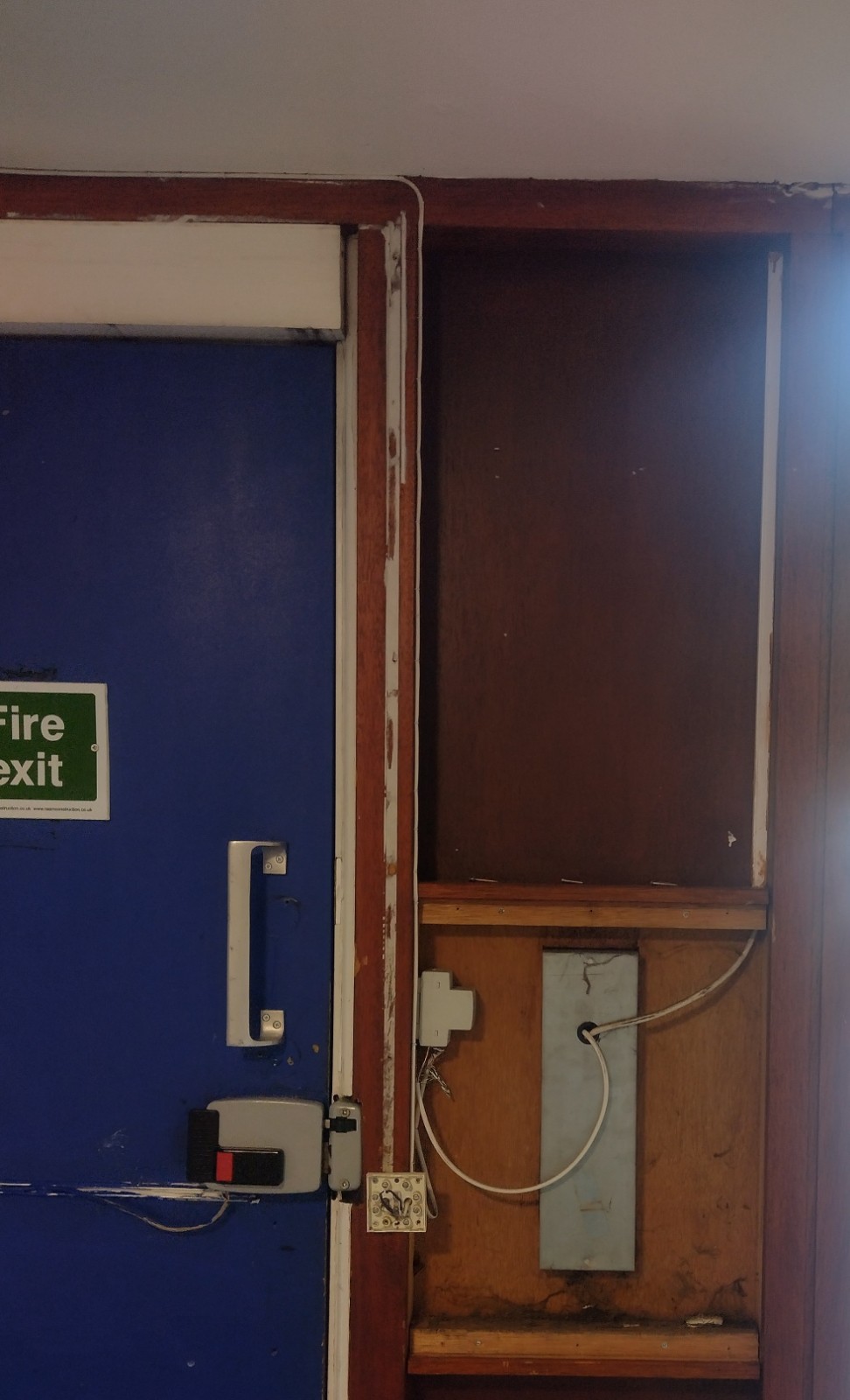

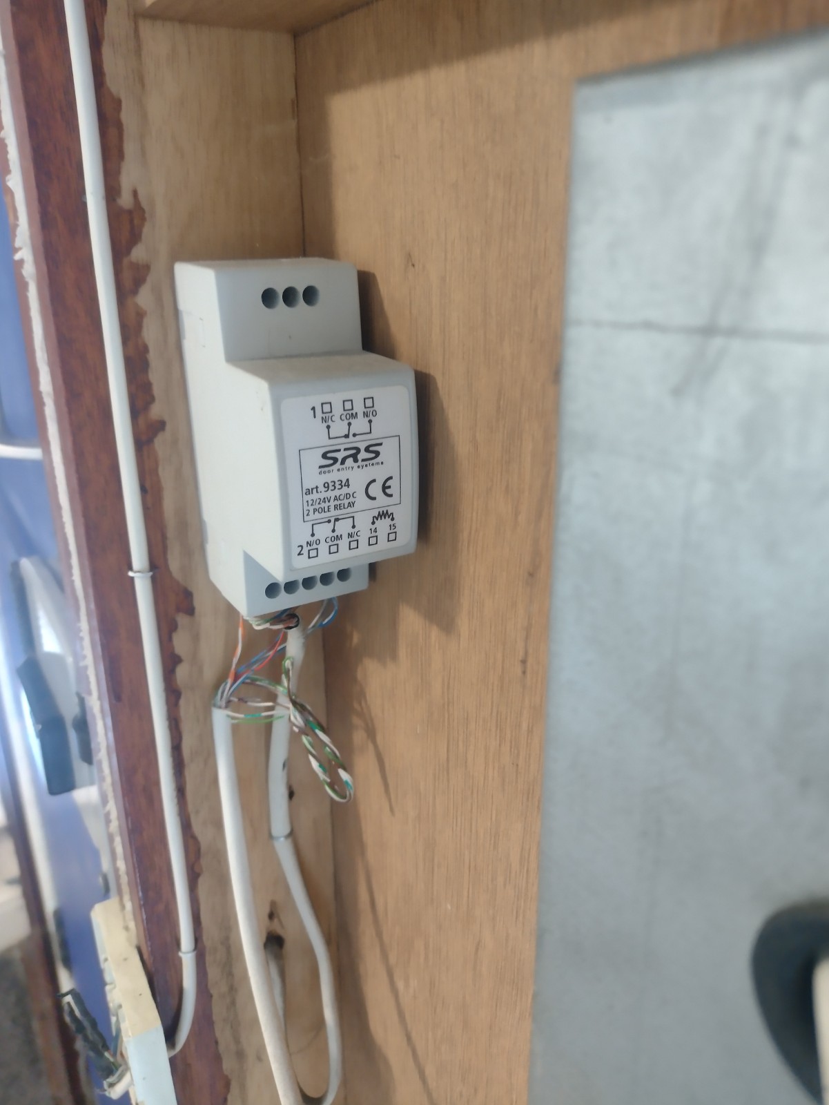

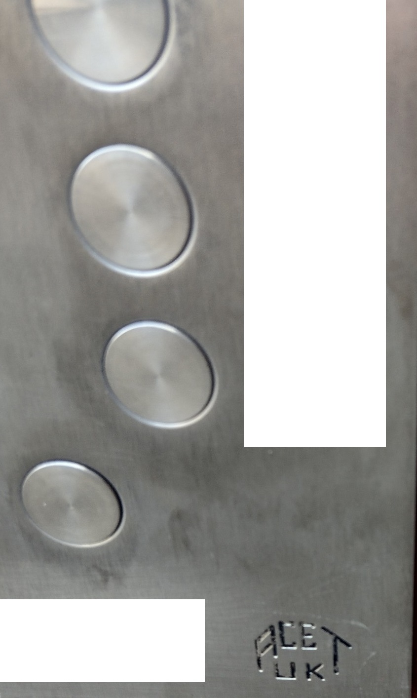

I opened up the parts I could get to to see for brands, loose connections etc
Pic 2 - Acet UK (Model Unknown)
Pic 3 - Cisca 07120

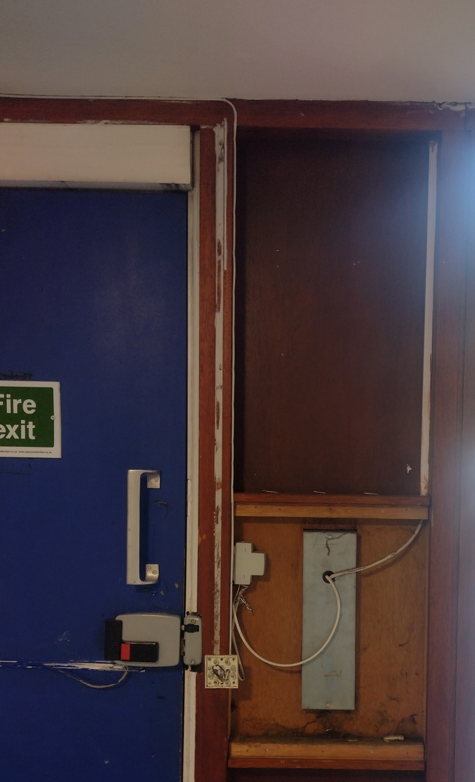

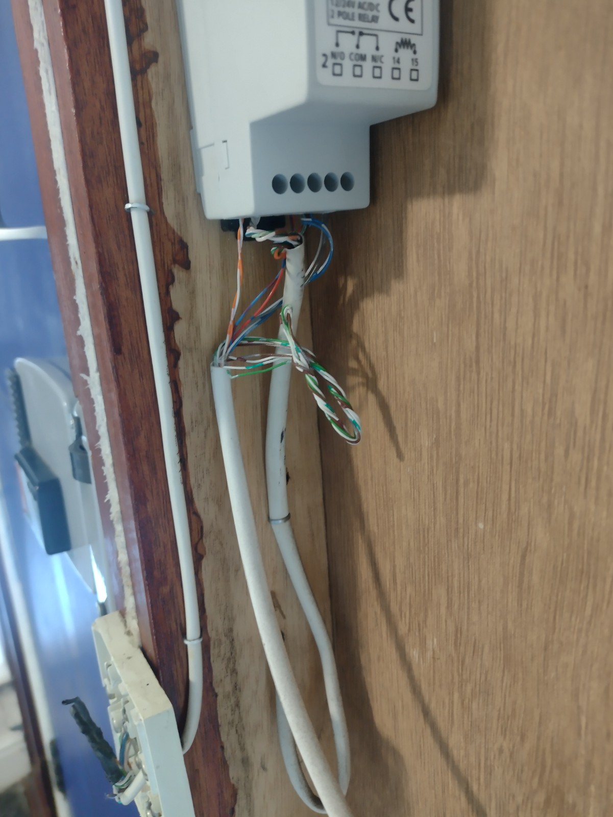

Power off to the system ….if it’s all dead ….start by looking for a power supply ( probably 12ac ) may look like the grey relay box in picture 4…
Is the power supply likely to be in close proximity (less than 5m) to the relay or could the power supply be anywhere/far further?

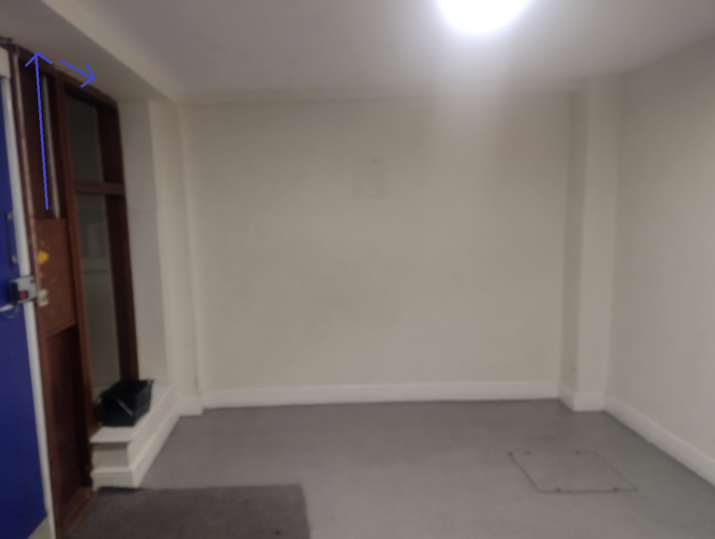

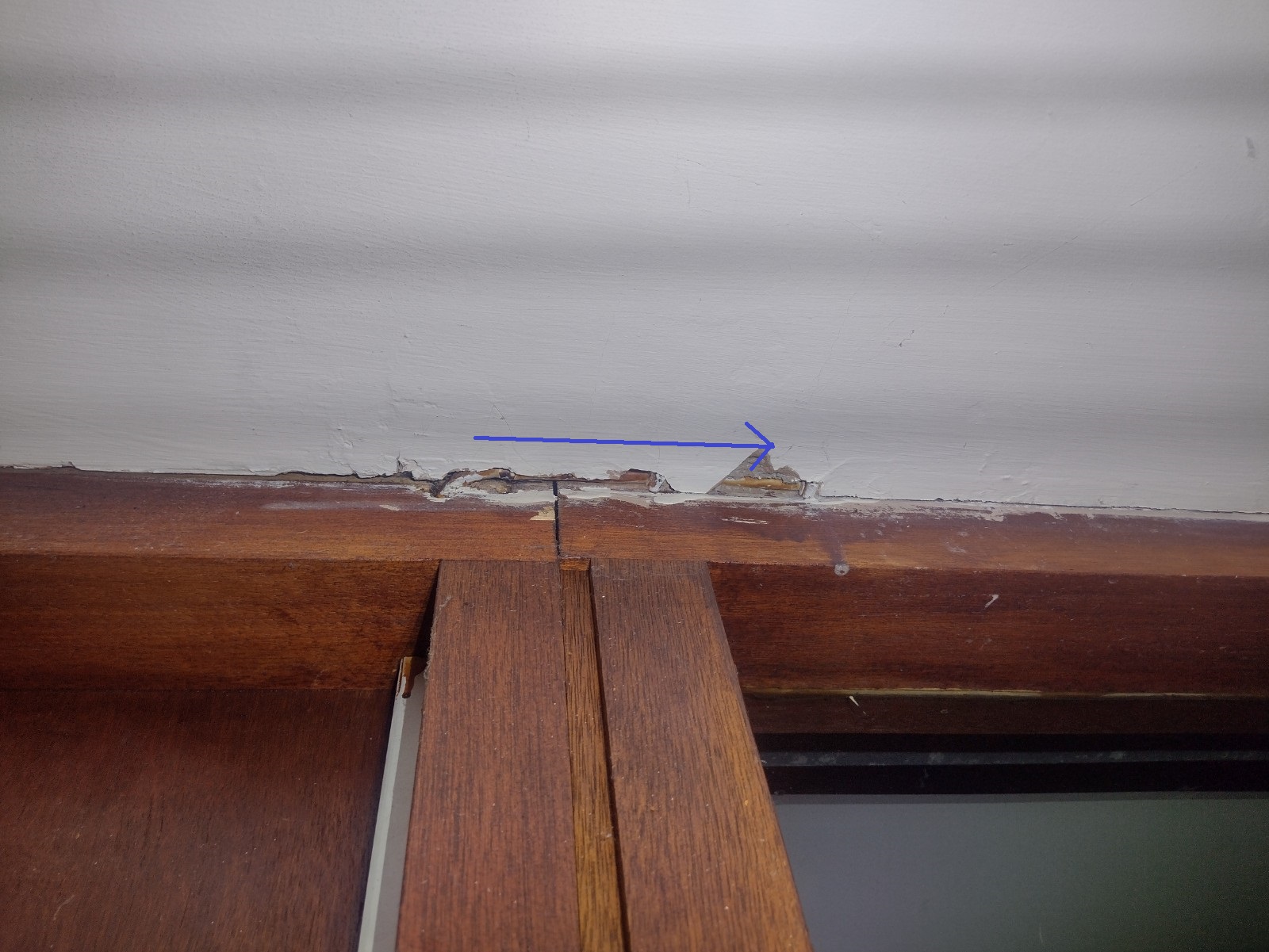

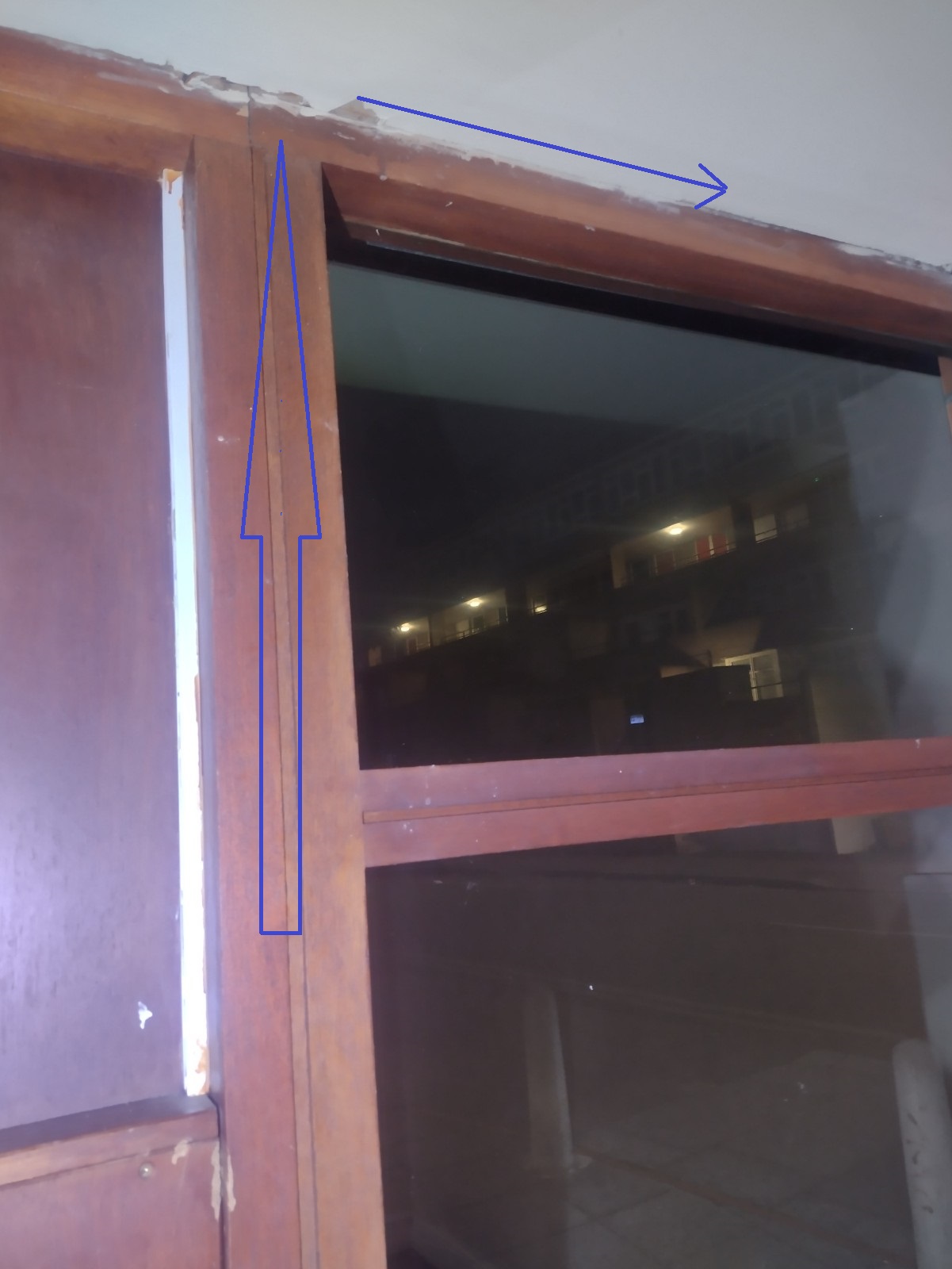

Follow the right hand cable in picture 1

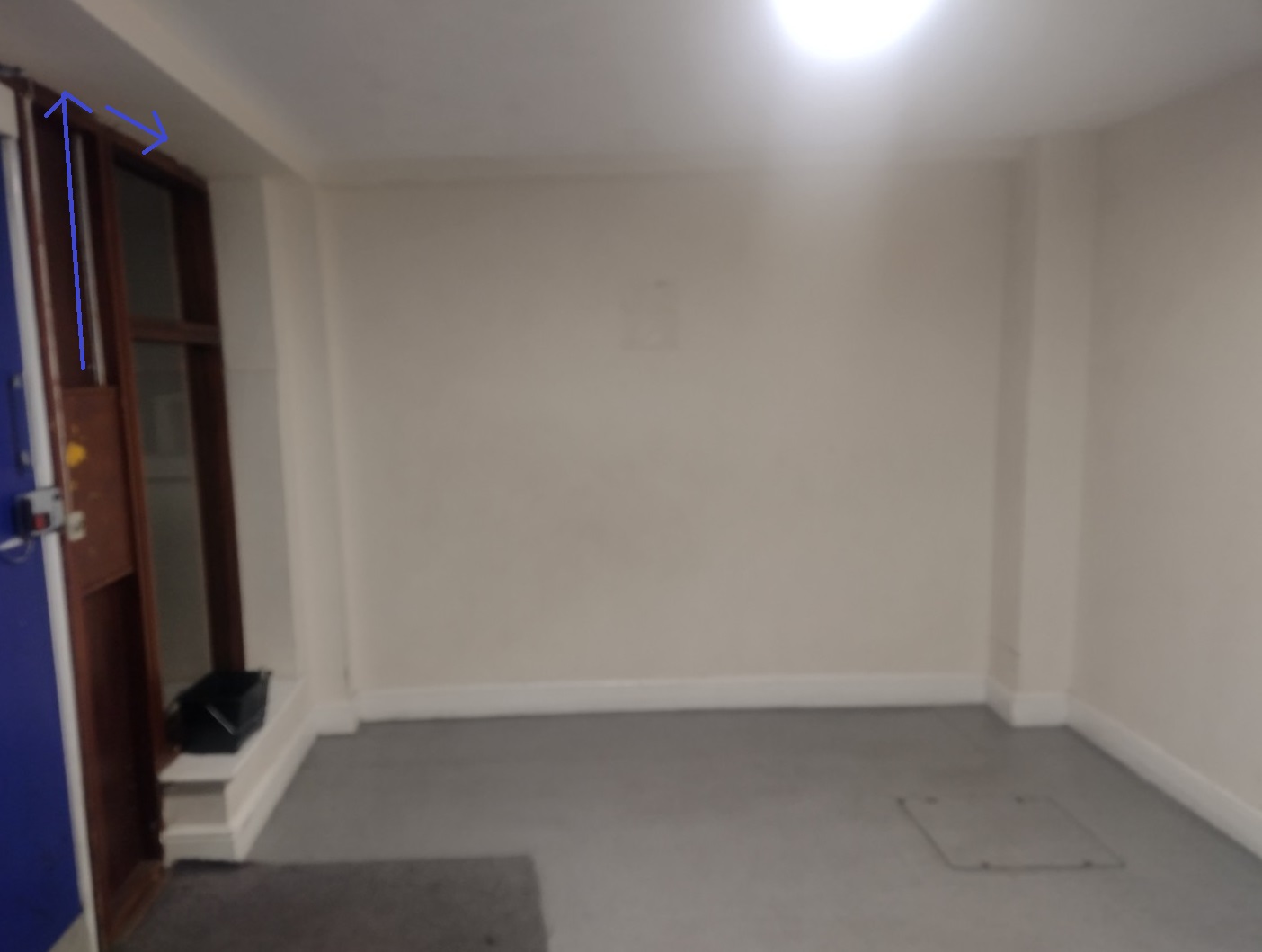

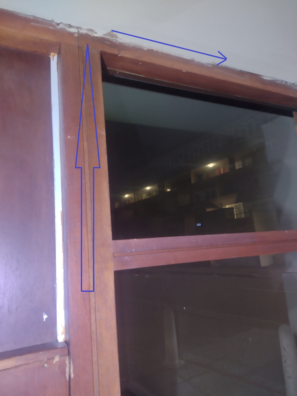

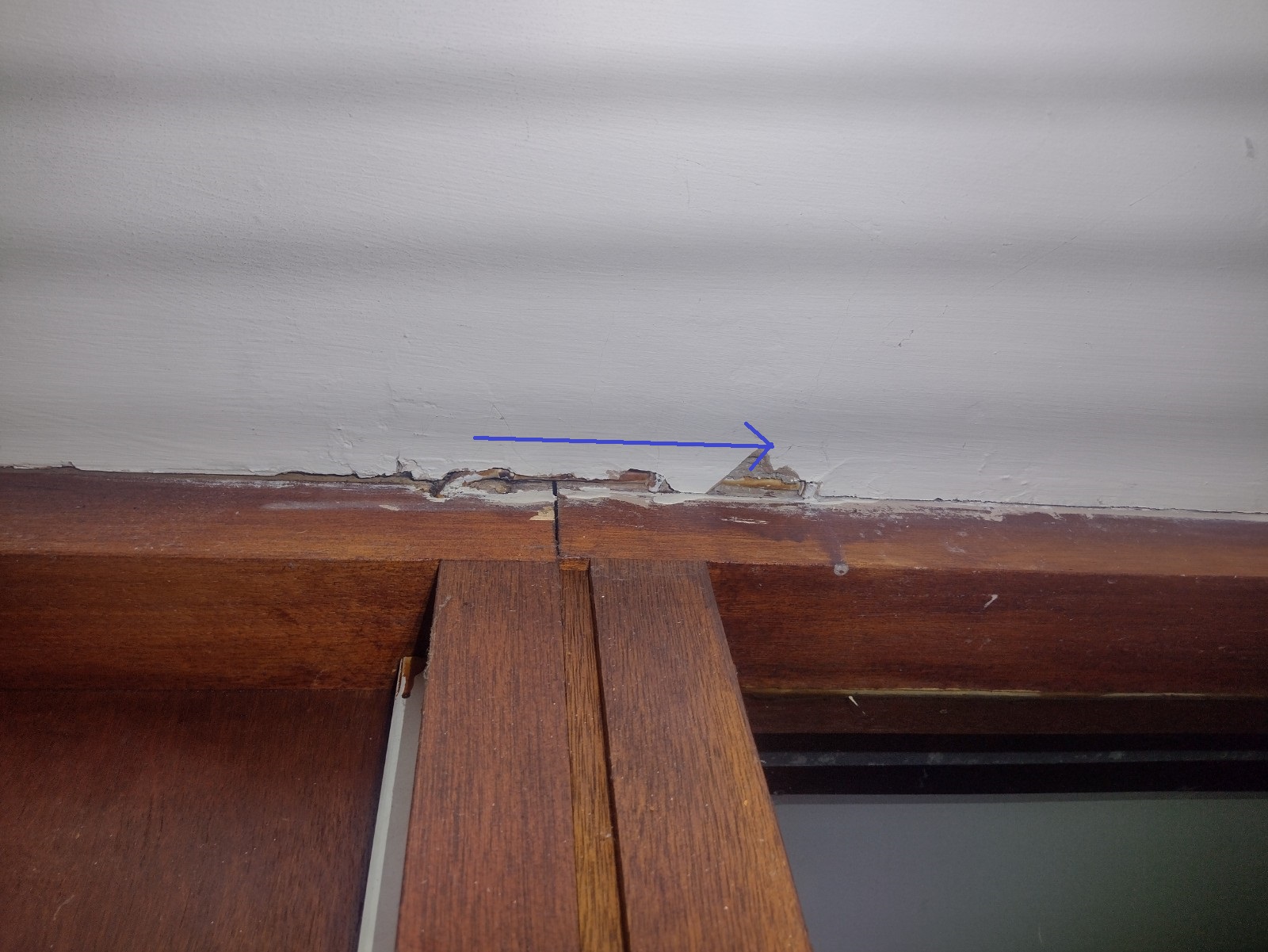

The cable runs straight up and along the ceiling, then disappears due to plaster.
I have marked in blue the wire path that is visible.
I don't see any nearby place the power source could be.
The communal electrical cupboard is about 6 meters away. I am trying to obtain a key to check here.
