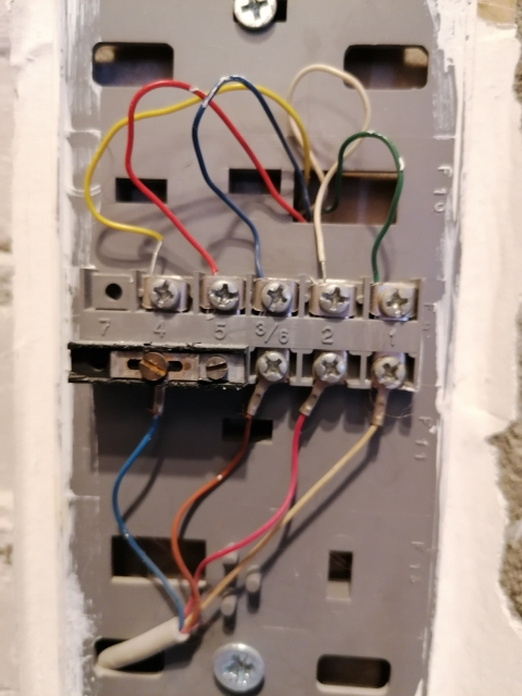

I Have replacent My intercom
Comlit Okay With Widex
Everythimg works except they cant hear me down on the street

"I have replaced my Comelit 5 Wire Okay Intercom
with a Videx 3000"
Further, the Photo 1 may have been the "original" situation -with the Comelit Intercom back-plate

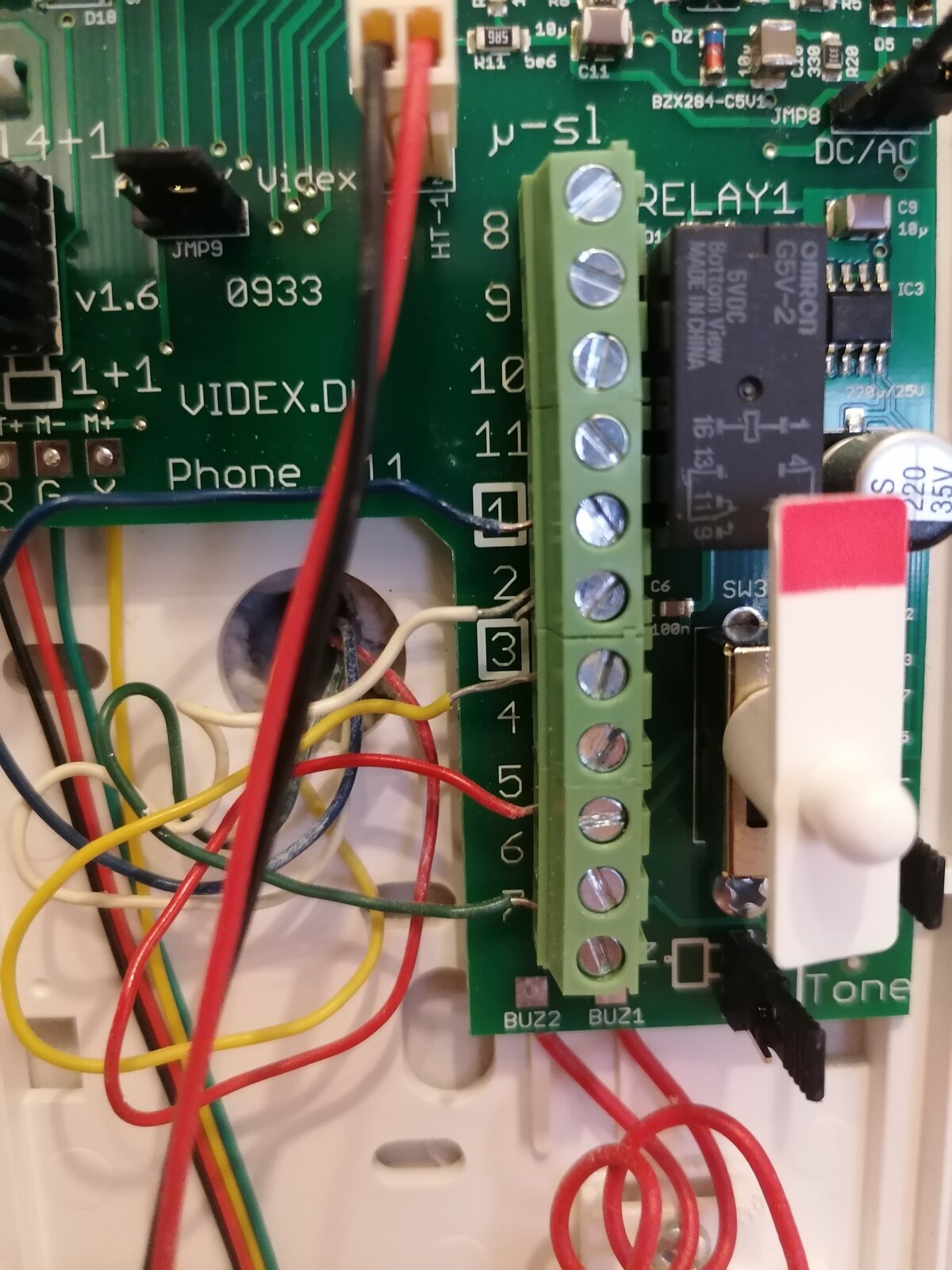

Photo 2 is the way in which you have wired the Videx 3000.

This seems to be OK, except that it may be uncertain if some wires are now properly connected - particularly, the Yellow wire.

I have realized that Microphone and Speaker refer to the Equipment at the DoorOpener.
The Speaker wire (White) may not be properly connected to terminal 2 of the Videx (See Photo 2)
I suggest that you check this.
(In fact, check and improve all of those connections.)
