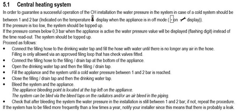

I have found the section in the user manual for pressurising the system. However, it doesn't make much sense to me:
Firstly, where would the filling hose be? On my previous Potterton boiler, i simply turned a filling valve to pressurise the system.

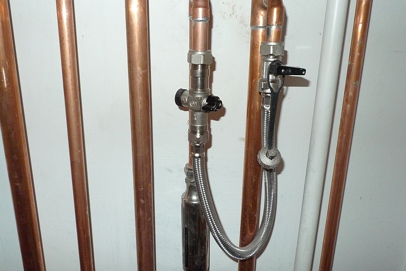

Filling loop should be a silver braided hose with black lever valve(s). They need to be inline with the pipework to be open... you’ll hear water rushing in when open... don’t overpressurise.
Look directly below boiler or under kitchen worktop if that’s where the boiler is. Your installer should have shown you where and how!
You are looking for this:

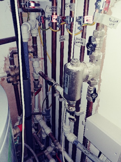

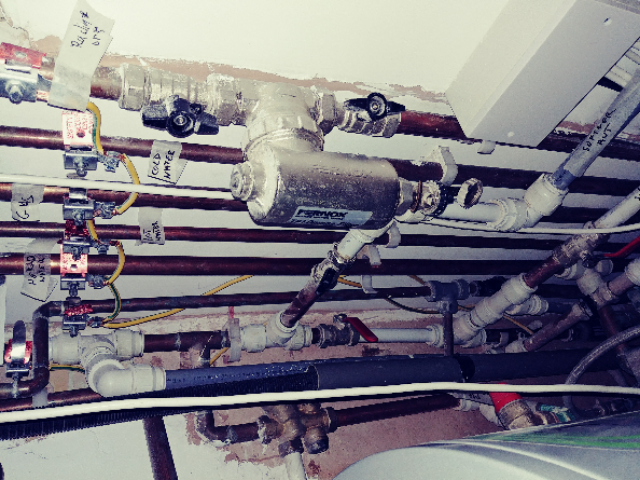

Unfortunately, no sign of silver filling hose. The only silver hose is on the HW cylinder pipework. The filling hose should be on the cold-water-into-boiler pipe, right? Heres a photo of the piping layout (if it helps).
If it has 1 or 2 black plastic levers and an NRV then it’s the filling loop. Levers should be in off position - turn them on and watch the gauge on the boiler.
Edit: and yes... pic is crap!
Sorry guys. I deliberately reduced the resolution of the pic as the original was too large!
The silver hose was indeed the filling loop - thanks. Pressure now at 1.5 bar. Should i now bleed all the rads again? And what about UFH system - doesn't that fill with air too? Finally, how to bleed boiler?

It also says it in the manual instructions you posted :)
