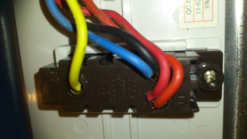

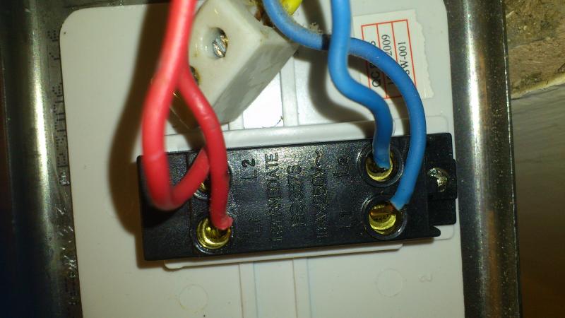

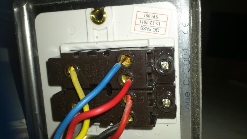

I am absolutely baffled by this one because everything appears to be fine. I have attached photos of all switches so you can sea if i've missed something simple.
This is the itermediate switch and the yellow common wire can just about be seen in the ceramic choc block
This one is the second 2way switch with a separate lighting circuit on the bottom that is not related to the problem lights
I don't suppose the reds in the last picture have been mixed up?
Make sure the RED is from the same cable as the blue and yellow...just a thought.
This is wrong:
The correct way is for red & blue from one cable to connect to the two terminals on the left in the picture, and the red & blue from the other cable to the terminals on the right.
Thanks flameport it all works perfectly now!!!!
According to the labels on the terminals on the switch it was correct (i suppose I miss-understood them) Thanks everybody for your help.
