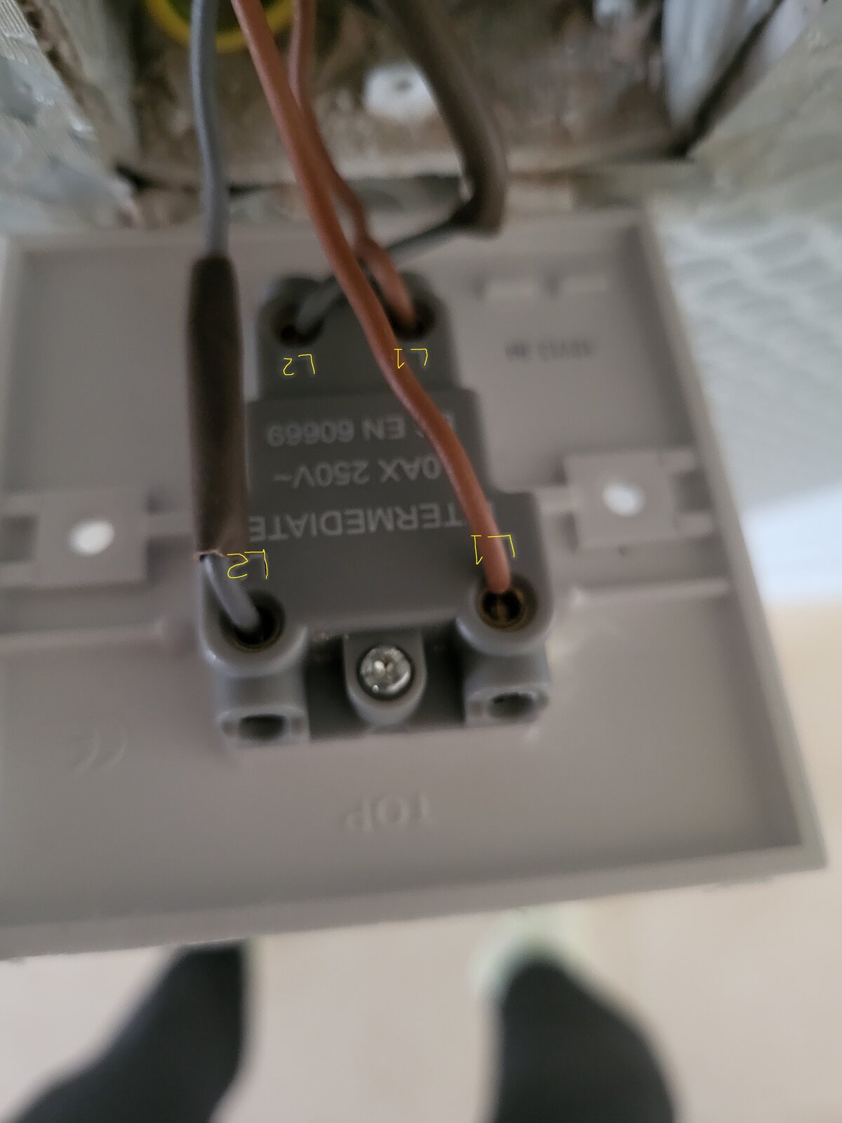

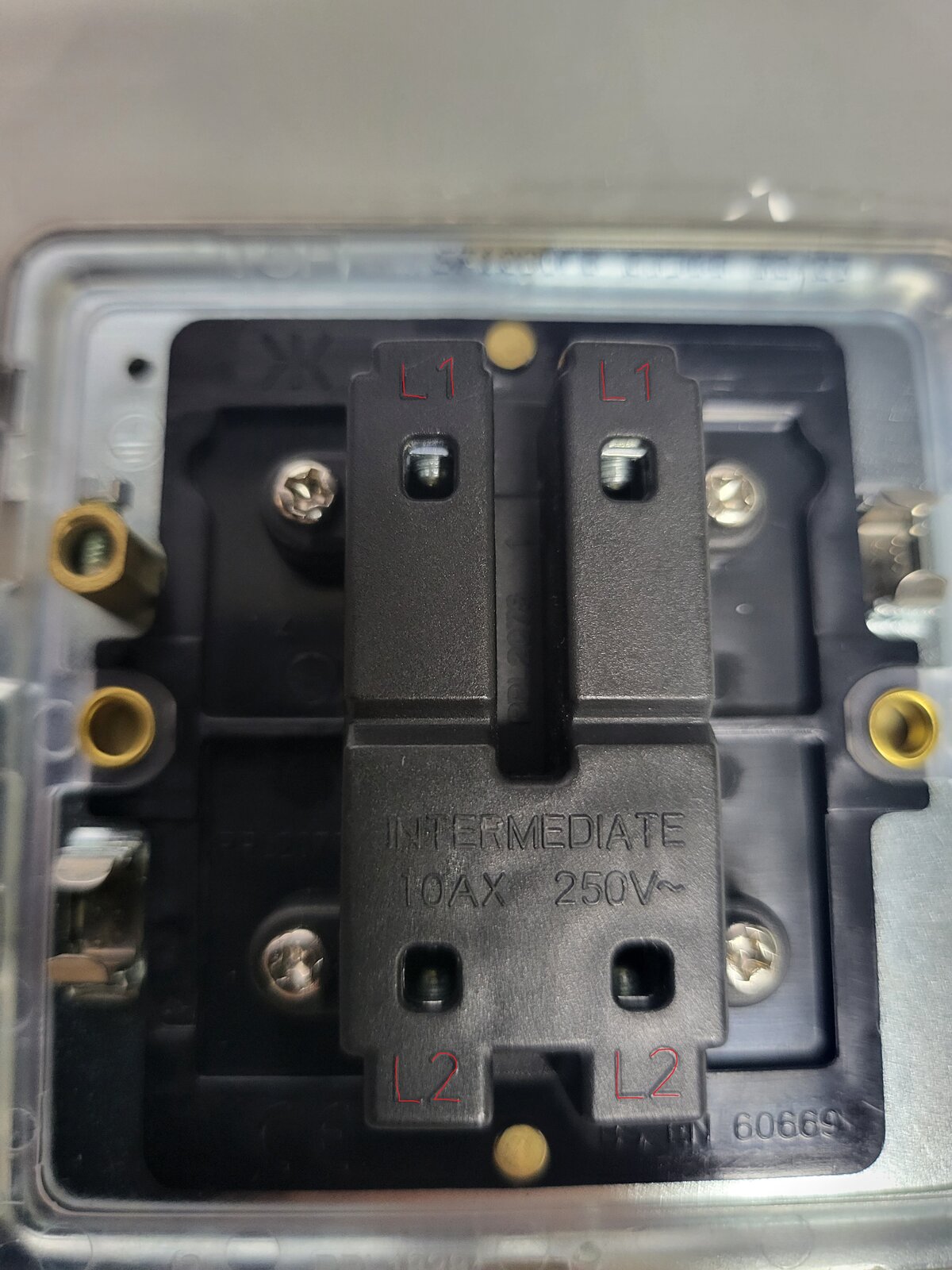

Im looking to change our current intermediate switch for a more modern look, but just need to confirm the wiring, You will see from the pictures that the current L1 & L2 connections are located top to bottom, where on the new switch they are side to side. Question as long as I connect the current L1 wires to the new L1, and current L2 to the new L2, will this work and be safe?

I would say NO.
This isn't the case for every electrical job, but in this case I would simply but the wires in the same positions as before, and ignore the markings.
I would put the existing top brown and grey wires in the top terminals of the new switch.
And the existing bottom brown and grey wires in the bottom terminals of the new switch.
Ideally you could test the switch before you fit it with a continuity tester - but it wouldn't do any harm in this case trying it the suck and see method.

I assume you refer to the markings rather than the switch.
Yes. If the markings vary and don't actually mean anything then they are useless.

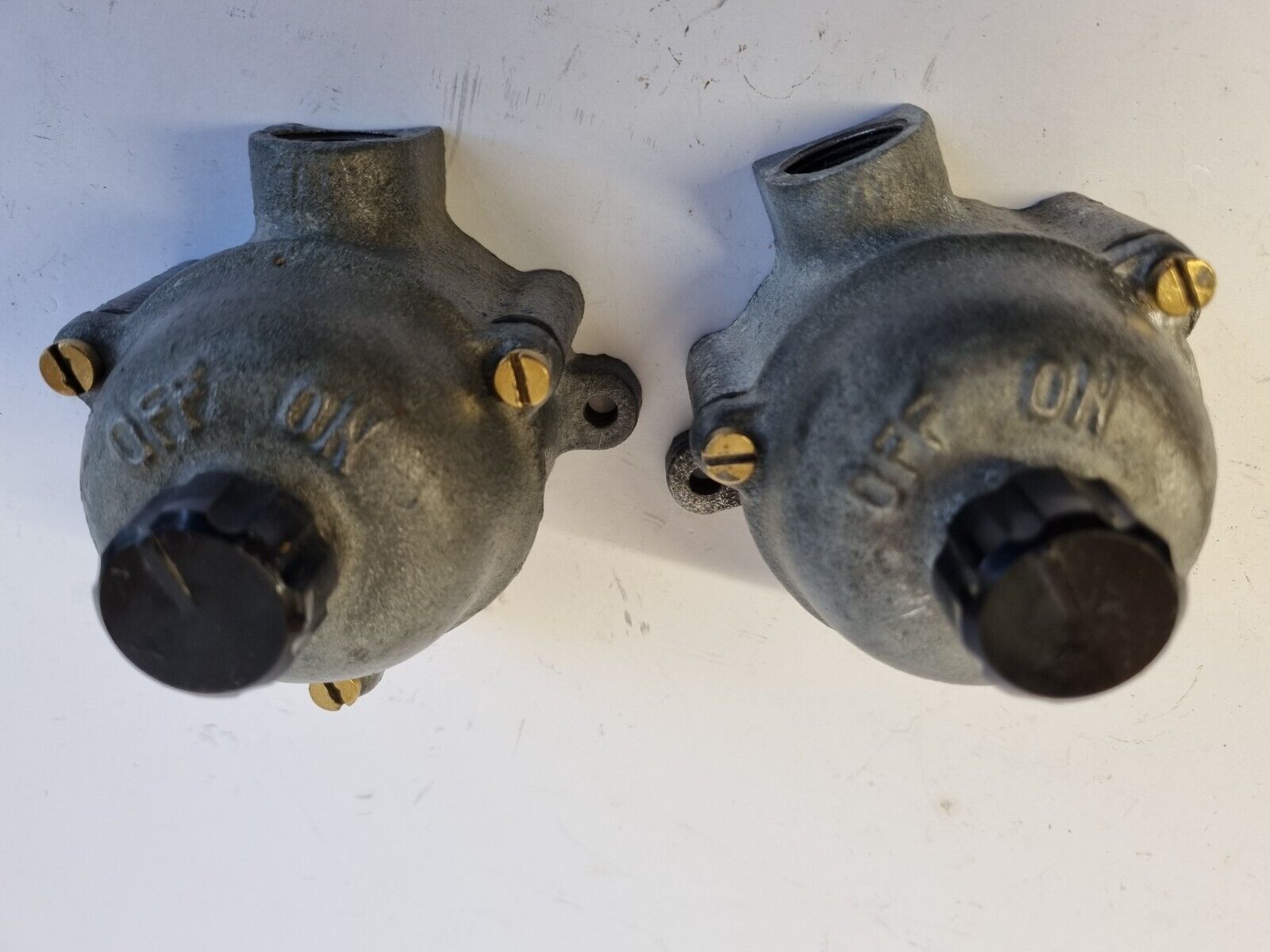

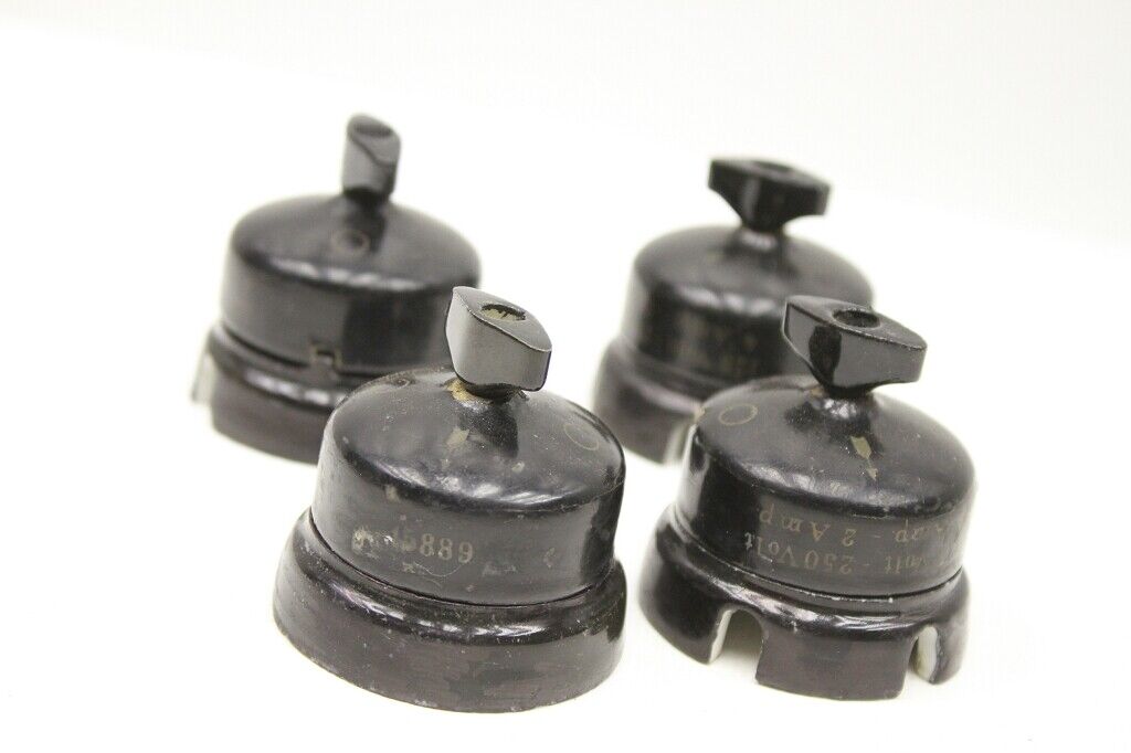

My only defence of that would be; for those who remember when switches were a ceramic base with a screw on cover or a castiron enclosure, an intermediate switch (reversing switch) would normally have had a rotary knob rather than a dolly turning a 'plate' with 2 brass contacts which would have linked the horizontal pairs or vertical pairs of static contacts, effectively taking the place of the up arrows or down arrows.
This sort of thing but these are all 1 way.

The "Intermediate/Crossover" switch is a Double Pole Double Throw (DPDT) switch, modified by the manufacturer, as described in the above reference.
(See https://commons.wikimedia.org/wiki/File:Crossover-switch-symbol.png )
The "Orientation" of the four available terminals concerned is NOT standardized.
Hence, you should check the "Orientation", by means of a multimeter and the two-way "switching" of any such device.
(Since you are undertaking "Electrical Work", you do have a multimeter, don't you ?)
If you connect any such "Intermediate Switch" incorrectly to the "strappers/travelers", you should have no "short circuit" or "safety" problems.
However,
the "set-up" will not operate "as desired", if connected incorrectly.
