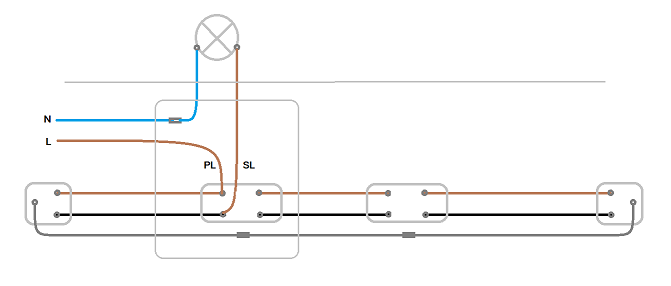

I'm scratching my head over this, hope some folks might be able to help...
Circuit is 4 switches:
(2 way) to (Intermediate) to (intermediate) to (2 way)
Feeds from the consumer unit are available at either the 2 way switch or at the intermediate switch
Question... Can the light radial circuit be connected to the intermediate switch?
Any diagrams to help with my head scratching?
Thanks!
Amazing thanks
If I wanted to take the feed into the intermediate, is that possible (so I can keep all 1st floor lights on the same radial circuit)?
Thanks again
You sir are amazing.
Just rigged up a test board and works perfectly.
As I'm running a number of LEDs as opposed to ceiling rose - do these get connected in regular manner ( same as the feed to switch / 2 plate method)?
Thank you again, I spent hours trying to research this over the last few days. Very grateful for your replies!,
Yes. Plus any required earths which I did not draw.
(y)
I have just noticed I made a mistake in the diagram; running the Brown and Black continuously through the intermediate switches and forgot to erase the bits between the terminals.
Obviously you realised how it was meant to be.
I have amended them.
