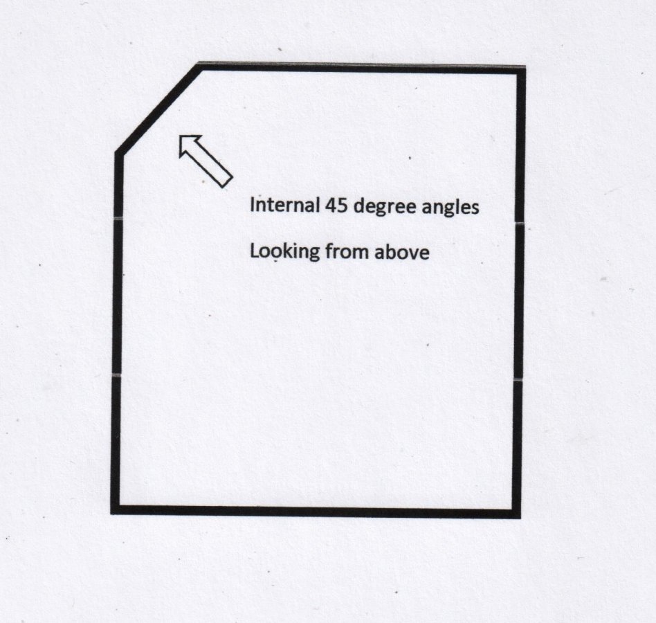

Will be tiling a ensuite very soon and the customer wants brick bond pattern for the tiles. That's the easy bit :sneaky:
If you can imagine looking at a rectangle from above but with one of the corners cut off ?
This is the shape of the room but I Have done a diagram and attached it.
I think I know the solution to this but I am asking the experts for help here:)
My problem is that when the brickwork pattern gets to the 45 angle the tile has to be cut and then both halves fixed so as to maintain the pattern but I'm thinking I will be left with a gap unless I get the two halves butted up tight. Don't think having a grout line will work between the two halves as it will mess up the brickwork pattern with the tiles above and below so ....
only solution I can think of is to mitre the tile halves at 45 degrees and butt them tight together then carry on tiling as normal with no silicone or grout used ??

By the way. These cuts will not be inside the shower or anywhere near the basin.
Any help much appreciated and a thank you in advance for any assistance :)

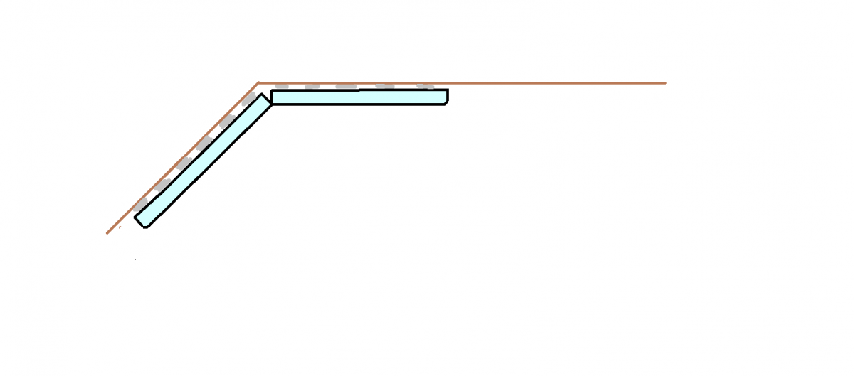

Well I am no expert, but you don't have to miter the edges as the corner is internal, that means as long as your cuts are straight, and fitted tightly, you will only ever see a thin joint line that you don't need to fill in with grout as long as you can butt them together, you will be wasting time if you were mitering them. The trick is to cut the tile really smooth in a straight line and the full tile cut in half should butt tightly against its other half. So you would have alternative tiles (above and below) with a grout and maintain a brick pattern.
Thanks for the reply, good diagram :) Looks like a goer so I'll crack on with that idea(y)

The easiest way for a DIY'er such as yourself would be to let the left hand tile in the diagram run through, & mitre the tile running up to meet it.
Leave a gap the width of your field grout lines.
Dont grout the inside corner, use matching colour silicone.

its a cracking idea no doubt, but problem is if his mitered tile did not sit tight against the left tile, and was slightly proud, you have a knife sharp edge and could slice a few thou off your finger. And the complexity of cutting or mitering a tile at the required angle in itself would give you enough headache. All ideas have drawback. Sharp angle created by miter is more likely to crack or chip away.

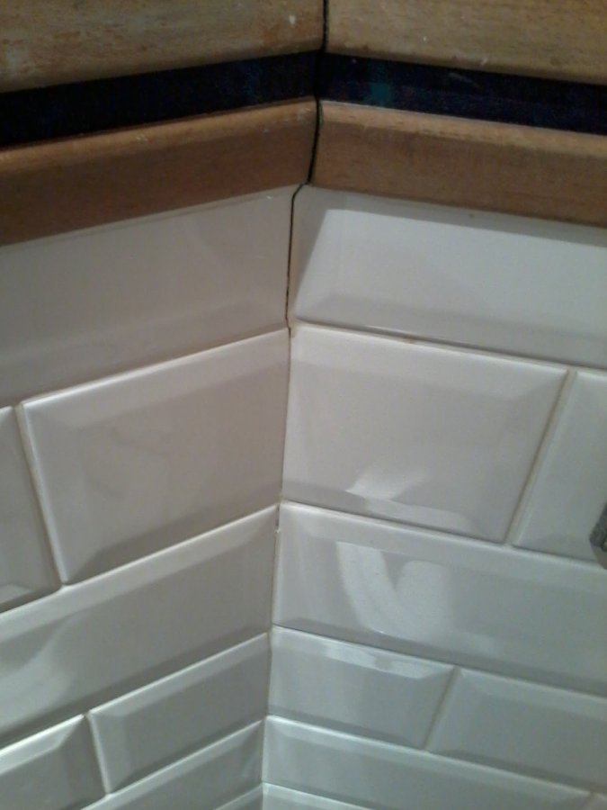

If these are chamfered tiles -commonly used in brickwork patterns- then even Mike's suggestion won't work where the chamfer is. You would have to cope them with a tile file!
Yes very true Garry, and that would be a real bugger to get it perfect! each case merits a different solution. Well thought though. But I take it he is using flat tiles.
You dont set tile tight against another tile at an inside corner - a gap or grout line should be left between tile joins.
Mitring tiles is a basic technique in tile setting, there's no "complexity to give you a headache".
And, unless you dont know what you are doing, mitres dont "crack or chip".
The best bet for any DIY'er is to hire a tile saw to cut and mitre all his worked tiles.
The OP might have over a 100 tiles to cut or mitre even in a domestic bathroom.
All sharp edges, mitred or nibbled, are eased with a stone or a file.
We dont know what tile the OP is proposing to use.
The whole idea was to pretend that alternate tiles in the corner were 135deg bent (Internal angle) without seeing any sort of grout line, just about what you might see is a hairline tight joint, so if you are suggesting setting tiles with a tiny grout line, it defeats the object, if what OP's customer wanted him to achieve as a invisible bend joint at alternative tile to maintain brickwork pattern, then that is what he will have to do, if he can't do that then he may not fully satisfy his customer's expectations.
At best he may have to fill a very thin grout line that when compared to other tiles above and below would seem like it has no grout as the other two tiles may have a wider width grout lines comparatively.
