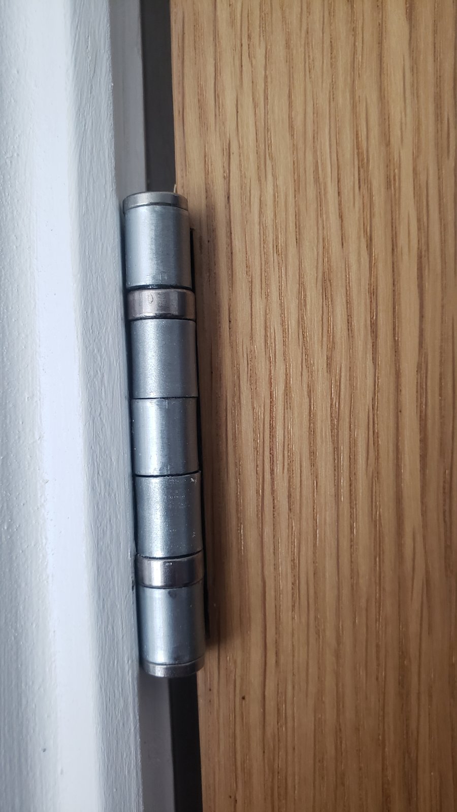

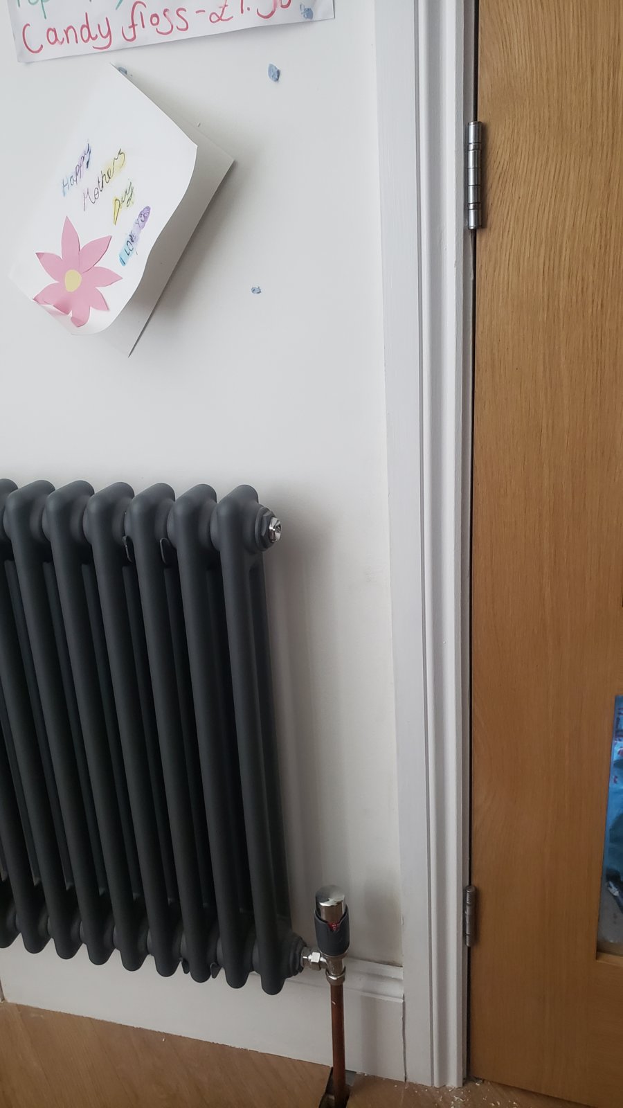

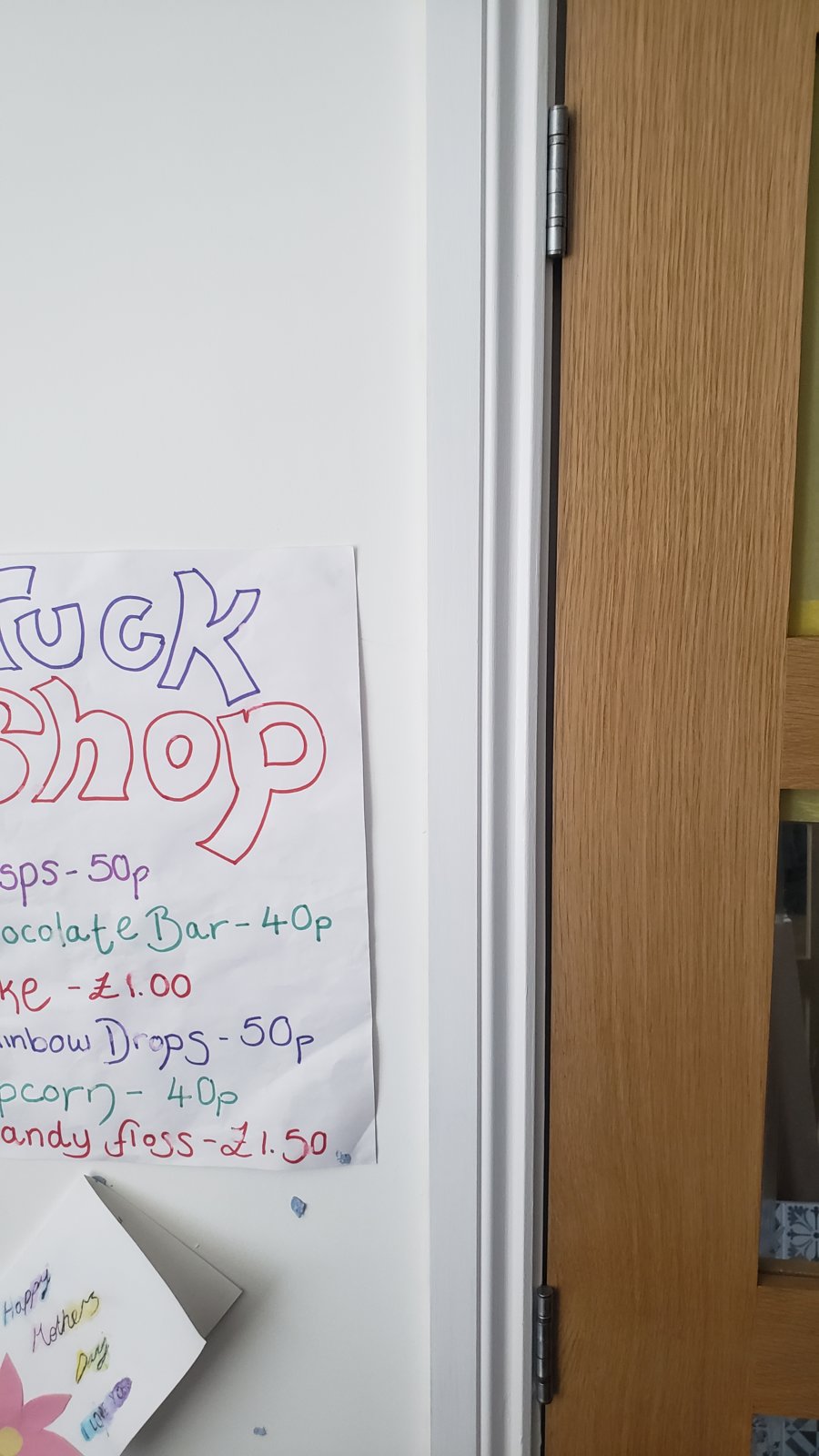

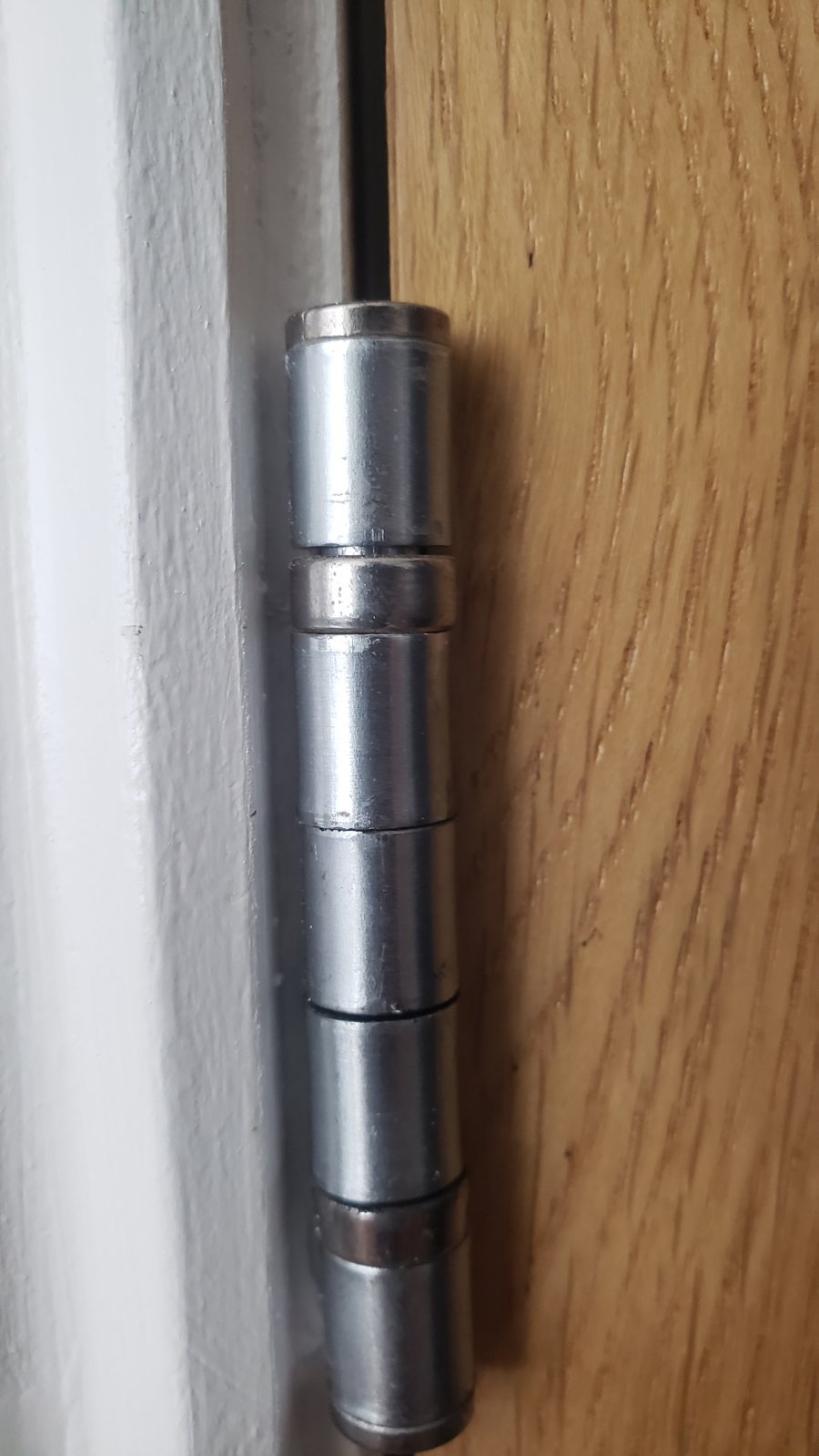

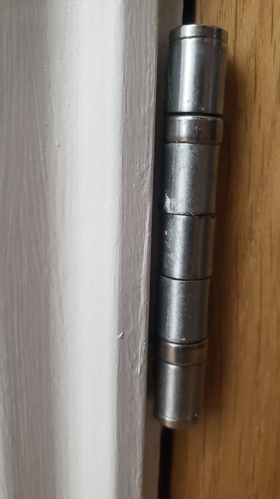

Hoping someone can help. I removed an internal door to varnish it and paint the reveal and architrave at the same time. I have reinstalled the door and it is now sagging. I removed some wood from the top hinge recess in the frame to help but it's still sagging and catching at the top when trying to close it. Can someone help based on the photos attached please?

What do you mean by sagging? If the top of the non hinge side of the door is catching on the top of the door frame then you need to pack the hinge out with a spacer. It sounds like you have done the opposite (ie let the hinge in, and not out).
yes pull the door hinge in at the top lock side [diagonal corner ] rises
pull the door hinge in at the bottom lock side [diagonal corner ]drops
9 time out off ten the trouble is the top hinge works loose and the top opposite corner moves across by that amount and bottom opposite corner moves down by about half the amount as the door between the hinges is is twice as long as the door width
Personally, I would take the middle hinge out of the equation by removing it temporarily. I would then pack out the top hinge so that the door open and closes properly. It used to fine before it was taken off, the dimensions of the door and frame haven't changed, so the only variable has been the wooden fillet that you removed.
Once done, refit the middle hinge. It should need any adjustment if the top one is correct.
For the sake of clarity, when you say that the door is catching at the top, do you mean that it is rubbing against the door header or the upper section of the non-hinge side of the the door frame?
If it is rubbing against the upper section of the non hinge side then first check to make sure that the screws are tight in the top hinge and that the screw heads are flush with the hinge plate.

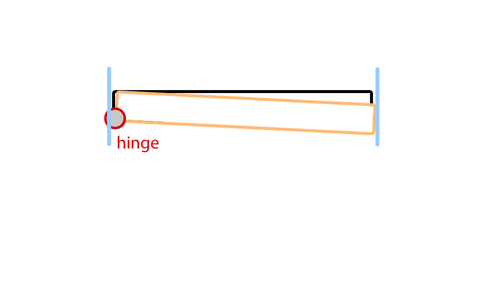

Ahh... makes sense now. Part of the problem is that the chippie leaves 2mm clearance all round but because the door is rectangular in profile as it pivots on the hinge during closing, the edge furthest away from the hinge is closer than 2mm from the door liner as it is about to close. Four coats of paint on the door edge and four on the door liner, and yup, all of the sudden the door hits as it closes.
See the image below, it is supposed to show the final stages of the door as it closes. I hope it makes sense.
