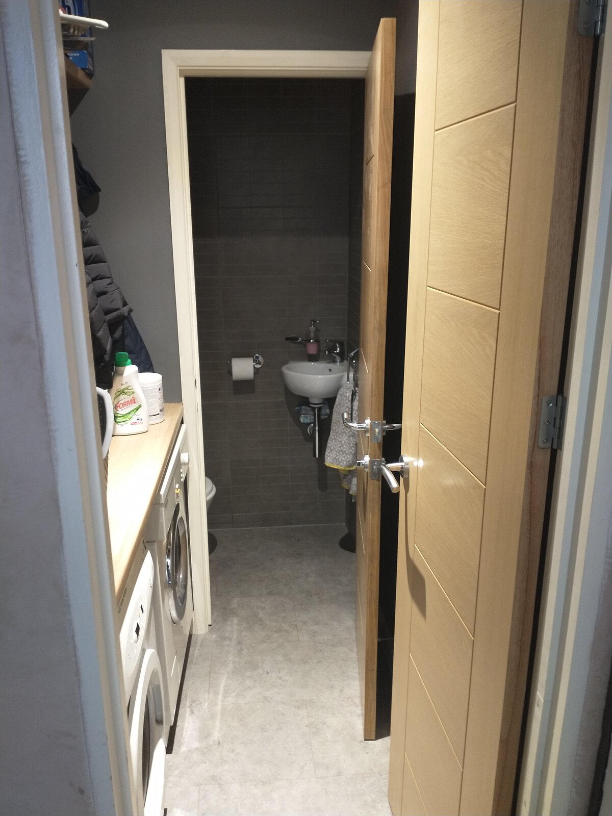

I fitted 24" doors in my utility "corridor" and WC, I was a bit nervous but they're absolutely fine (and I'm a bigish bloke). The doors don't even full open as they have stops to stop the handles hitting the wall. Just don't ask me how I get the washing machine in and out!
I guess that he takes the door off and unscrews the lower part of the stop in the bottom right of the photo.:)
Correct, your zoom is obviously working well. I just wish I'd used those hinges that you can just lift the door off. Luckily only had to replace one dryer in 4 years so far.
