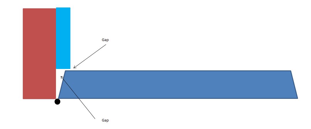

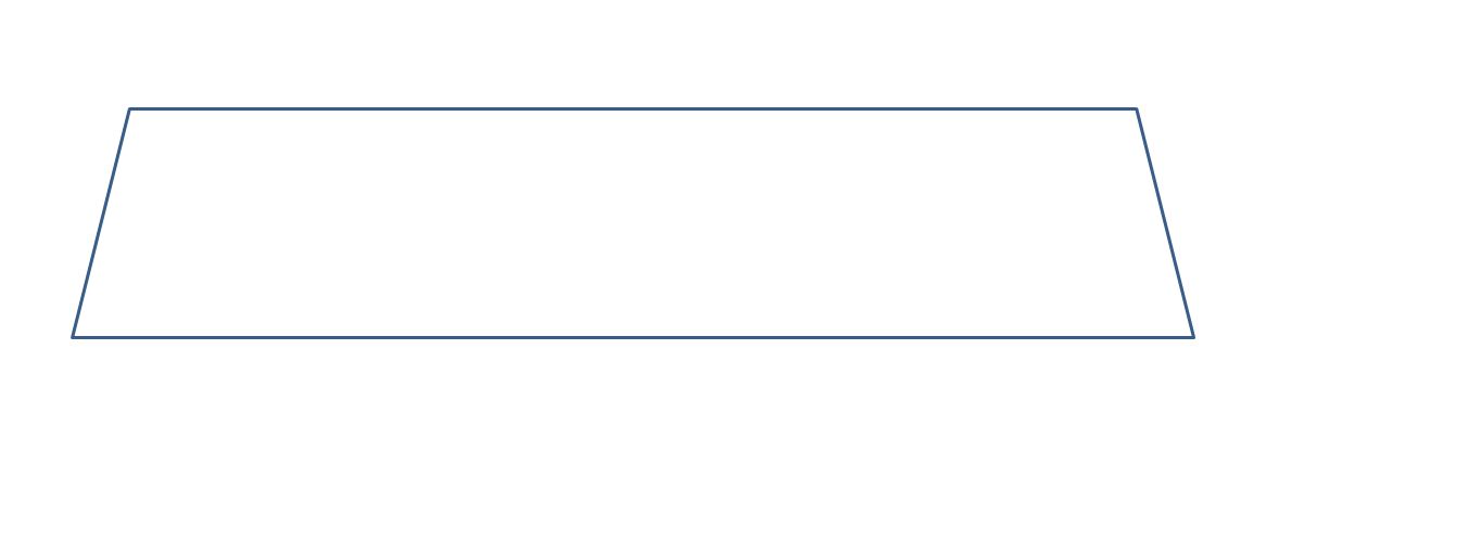

hinge bound, take the door off and dress the edge of the door on a wee angle, but leaving the outside edge the same size
Also, are the hinges checked into the door? they could be checked in too deep
the door should be something like this (picture exaggerated)

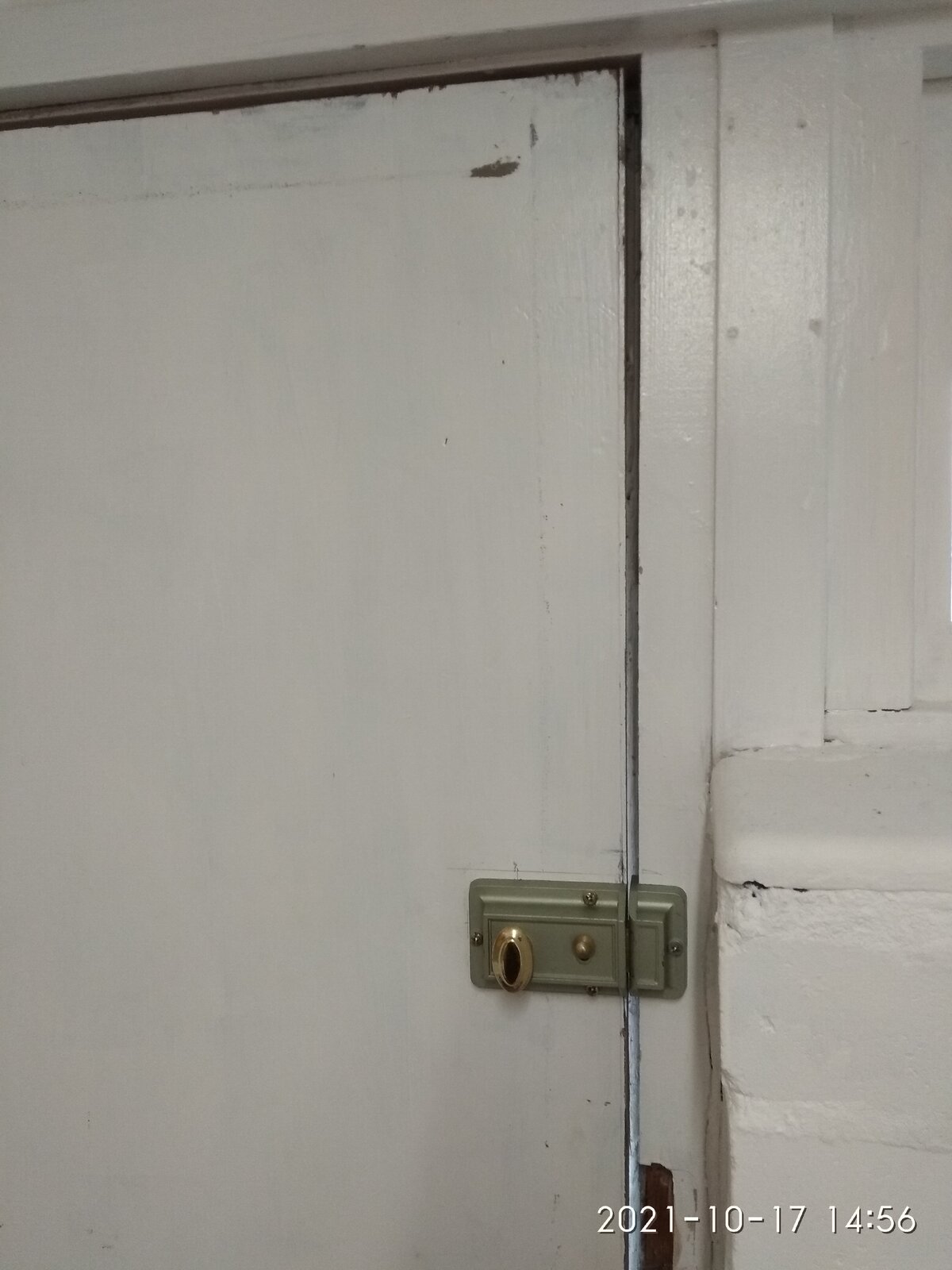

some pictures would be good, not all close up, do some standing back so we can see the whole door

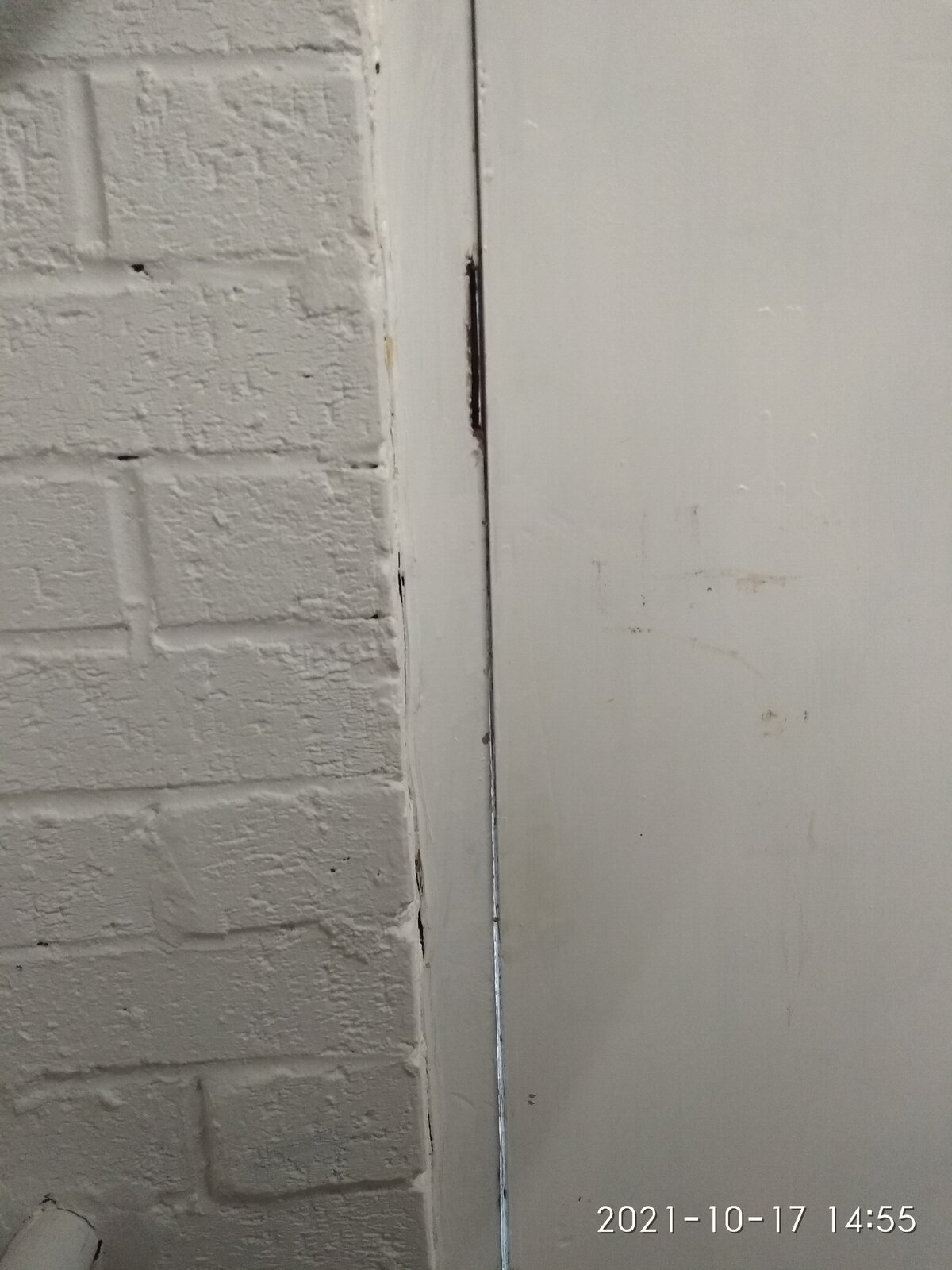

I checked and the hinges are slightly out of line of each other, by around 5 mm.

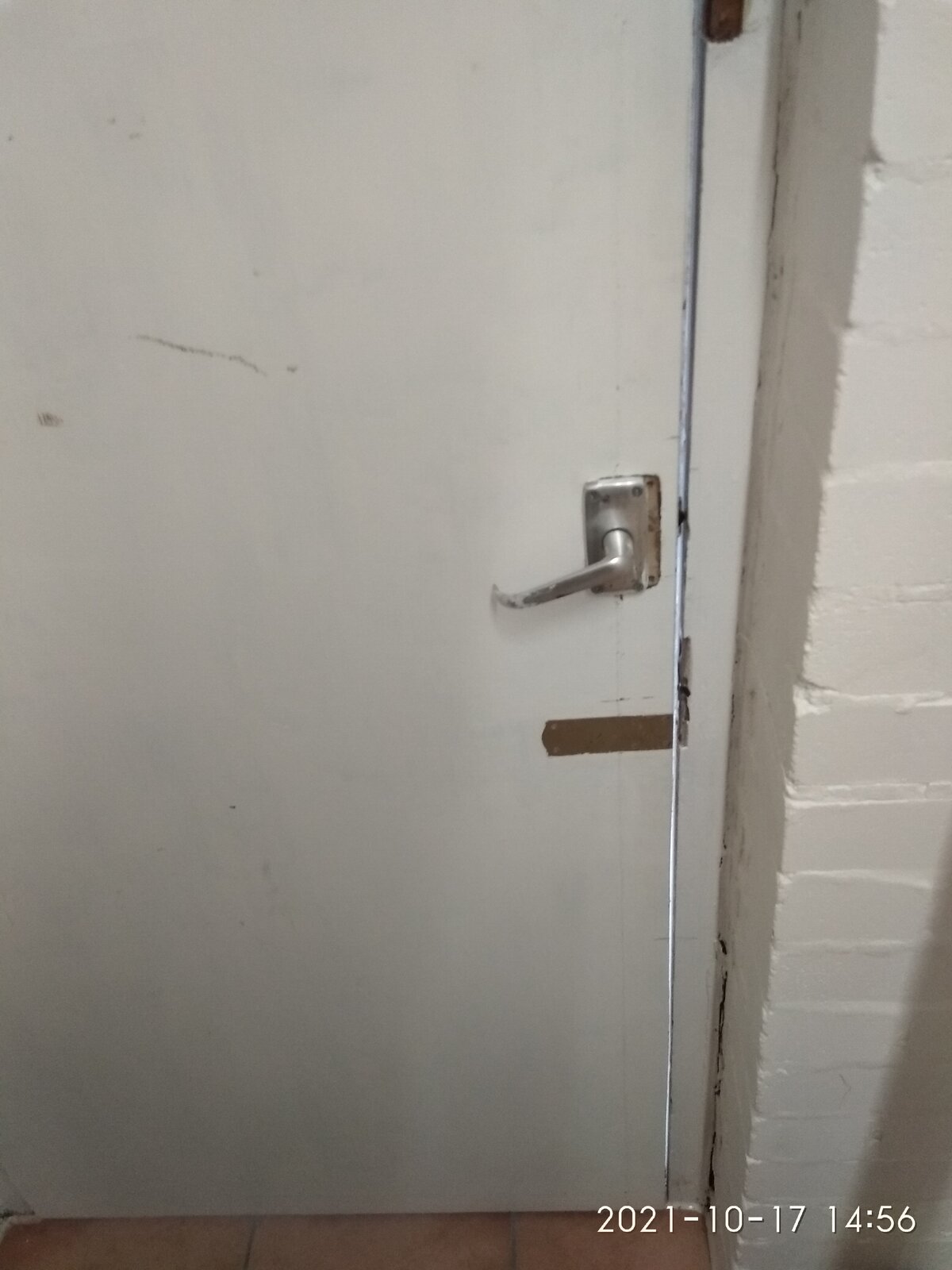

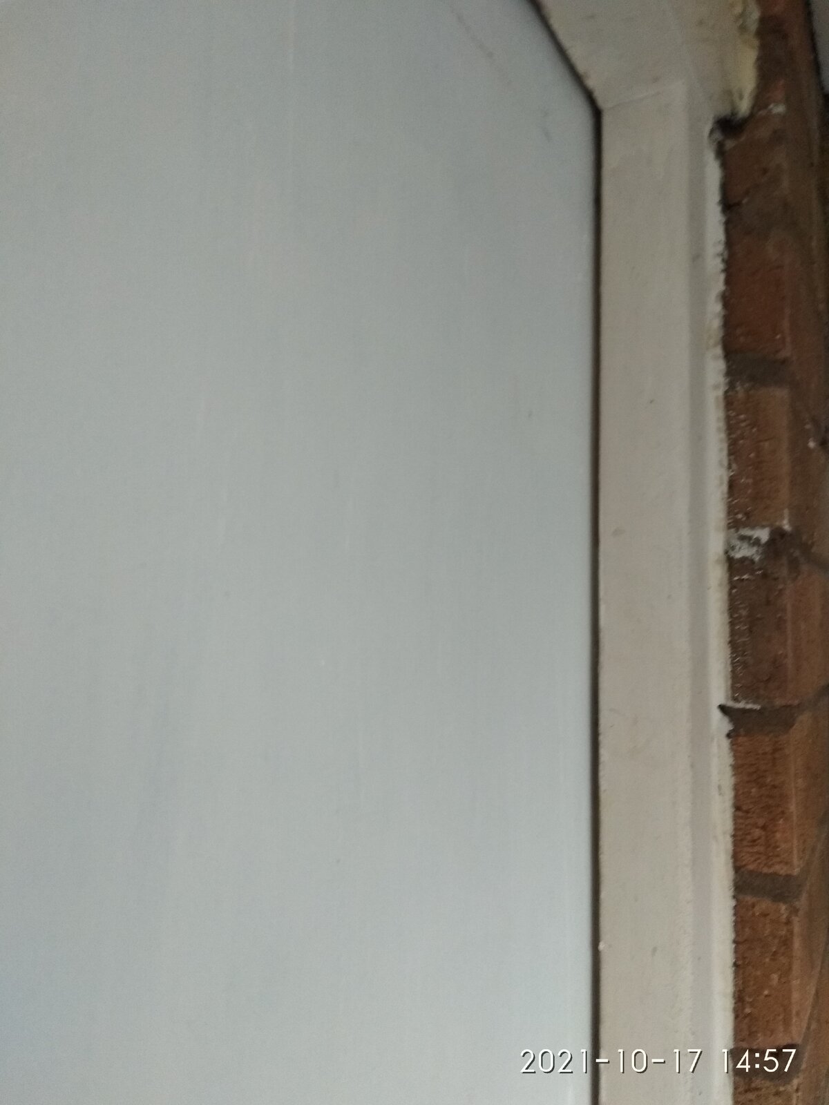

Sending some pics of the door - you can see the gap and daylight nearly all around. In the picture, the door seems to be touching in the middle where the bow is, on the hinge side. I can't remember now if there is actual contact or not.
I slipped a piece of plastic bag, so very thin, between door and hinge area and it was stuck in some places. I think I'll need to redo this test, it was done at the end, after spending over 2 hours on this door and I was fed up!

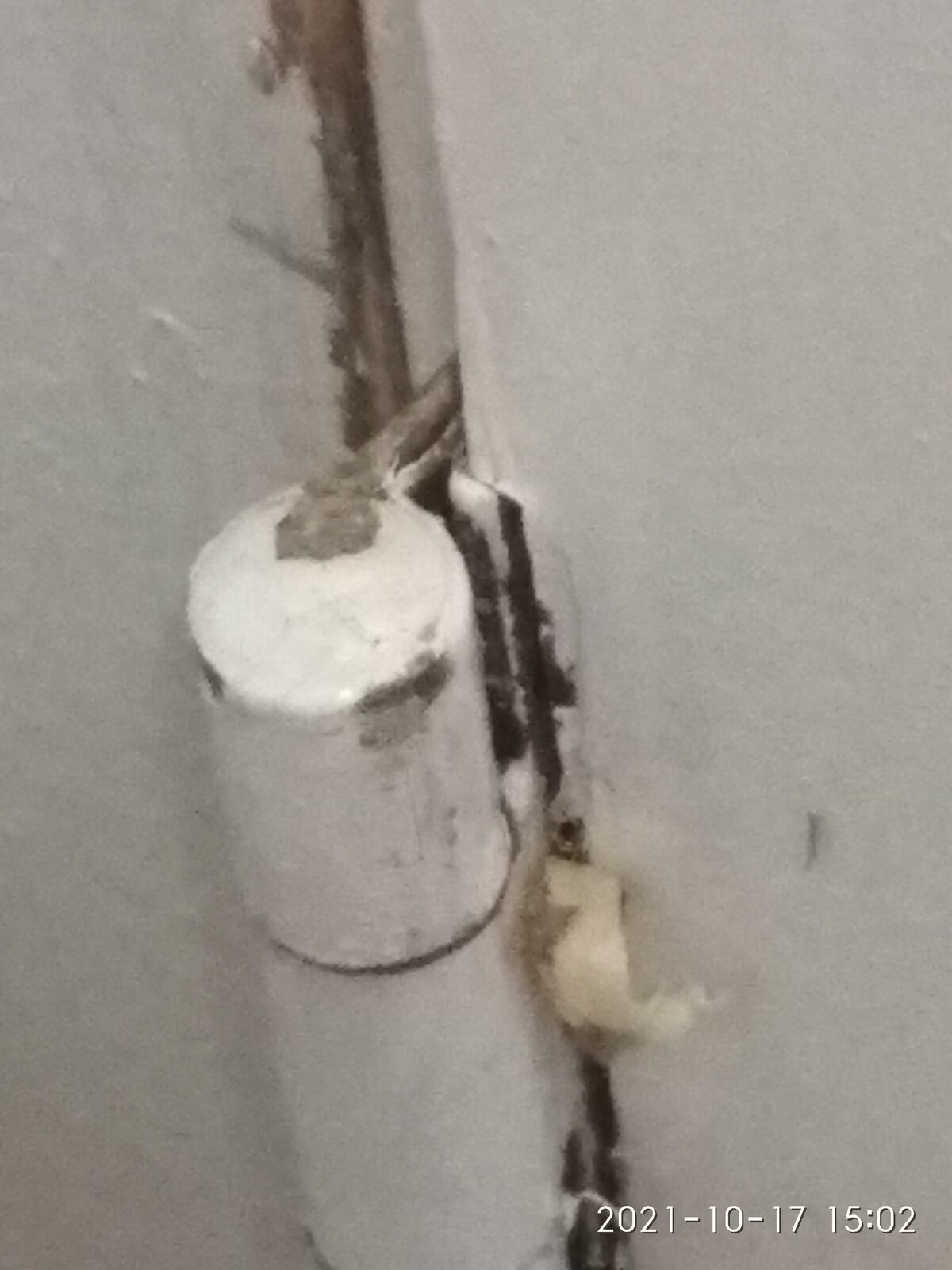

So I cut out a slight recess for the bottom hinge and at a slight angle such that the door would be angled towards the frame. The resistance decreased significantly but was still there on the last inch of closing the door.
This still bothered me so I spent the next hour and a half trying to figure out what was still blocking it.

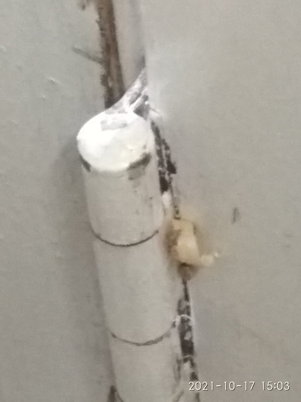

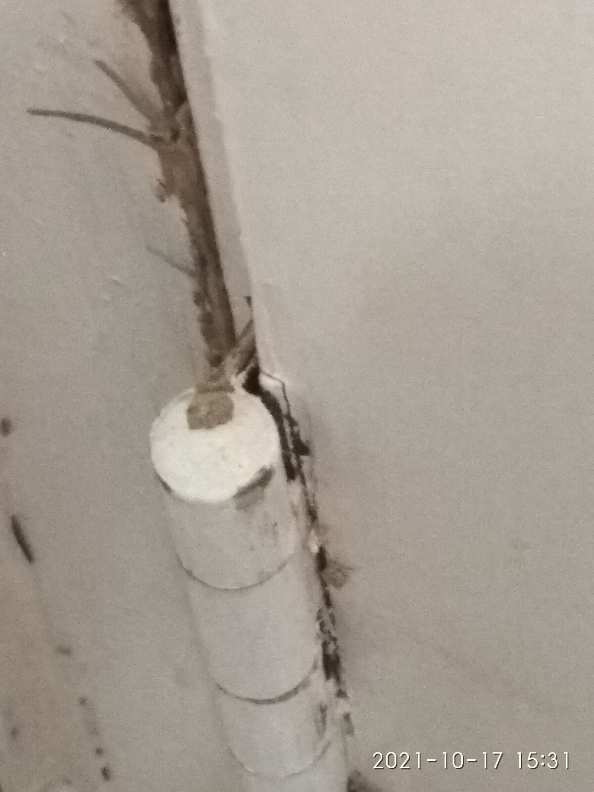

You can see a picture of the hinge with a gap between it and the door, where it's supposed to be flush against the door. This is in the forced shut position. The gap disappears when the door is opened.
After I cut out the recess, this gap greatly decreased.
Trying to get rid of the resistance completely, I tried to cut the recess flat this time, rather than at an angle. No joy. Then packed some cardboard behind to recreate an even bigger angle. No improvement. Got rid of the packing.

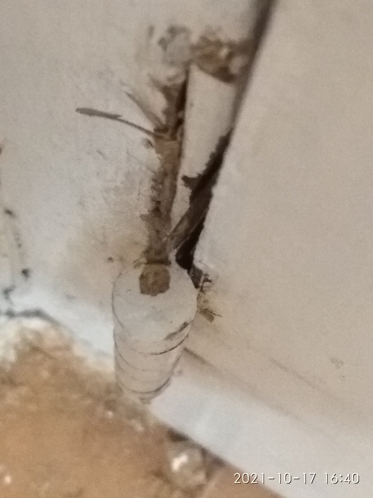

I could see the two faces on the hinge pressing against each other when starting to close. This was not the case with the top hinge, so in desperation, I bent the hinge on the frame side slightly and now in the shut position, the faces are not touching anymore.
The door still wouldn't shut nicely. I could see some paint had disappeared on the old screw on the hinge, door side. I removed it. No success.
Looking from below, I could see the faces touching each other on the far side, away from the pivot point, and at the bottom. This is when I did the test with the plastic bag which was laying around.
So I think the hinge may need to be recessed further to prevent the faces touching at the bottom corner of the hinge. I'm not yet prepared to do that. It's going to move the hinge deeper in the frame and may tip the door out of alignment, causing it to scrape the floor.
Also, the bow in the middle may be behind the resistance - will need to investigate.
The hinges being out of alignment could also be behind this, but I didn't move the hinges on the door at all and this was how it was on its previous frame and hanging perfectly fine.
