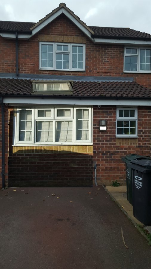

here is the house now:

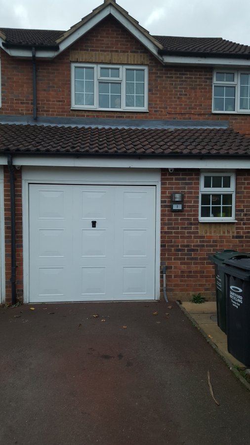

and here I think it should look after conversion
