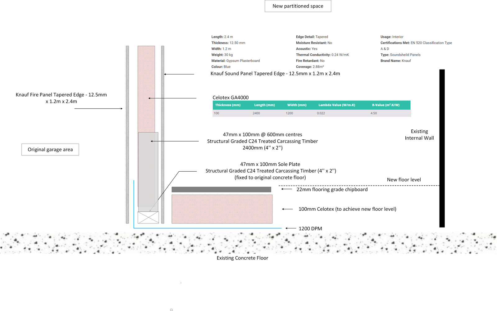

I have an internal garage that I'm partitioning to create office space. One side is an external wall to a passageway into my garden, front is an up&over garage door, other two walls are internal.
A local building inspector paid me a visit and verbally advised;
Floor - DPM + 70mm foil backed insulation - fine with that, I plan to add 100mm + 22mm T&G to create floating floor to new level.
Outside Wall - It's a 70mm cavity with insulation - advised I need to add an additional 20mm (insulated plasterboard) - PITA, but OK with that.
Main issue is the partition wall - He advised, 100mm studwork, foil backed insulation between stud, + fire board garage side + thermal board room side.
For the insulation, I see most people reference something like Celotex GA4000. However, I've read it's doesn't supress noise well.
Q1: Could I use Rockwool 100mm Rockwool Sound Insulation Slab 1200mm x 600mm, or perhaps Celotex with a Knauf Sound Panel Tapered Edge - 12.5mm x 1.2m
Q2: Could I use just OSB3 board for the room side, as the wall will have some monitors attached and I believe plasterboard isn't ideal. Maybe OSB3 over the sound panel board (or is this excessive)
Basically, I need to get insulation to the required regs, but also to sound proof the room as best as possible.
I've tried to draw it out, but I'm no expert.
Any thoughts or advice welcome?
Ta.
