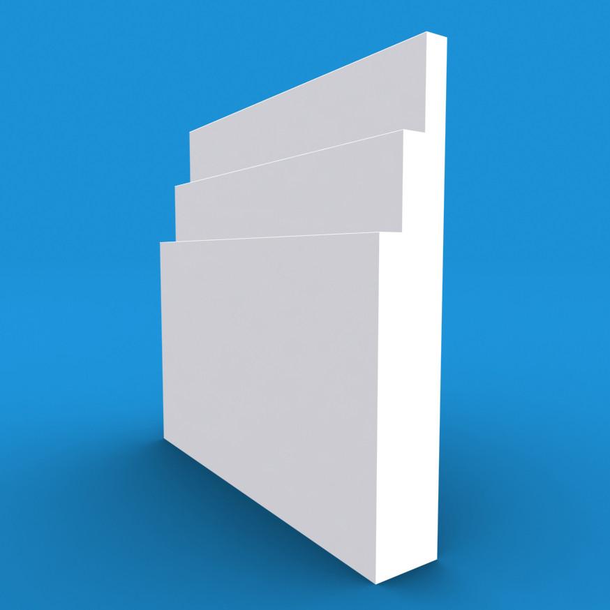

Hi there,
I am installing a large square stepped skirting in my house and scribing all of my 90 degree internal joins. I need to do two 135 degree internal joins in a bay window. Do I mitre or scribe these joins? Pic attached of my skirting.
Thanks in advance. Chris
Mitre, scribing would be a nightmare with that profile, I would use scrap bits of skirting to find the exact angles. If all else fails there's always caulk.
